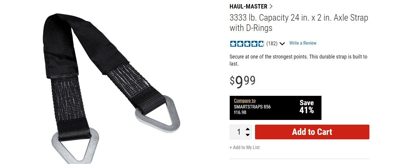

Ive used these with good success.. Bring on the HF bashing...
Jeep Gladiator Strapping axles for transport 1667482263387
Yes, that's what I use, connected to snap hook ratchets. Problem is there's nowhere on front axle, especially passenger side, to avoid grabbing steering stabilizer or running into tie rod.
