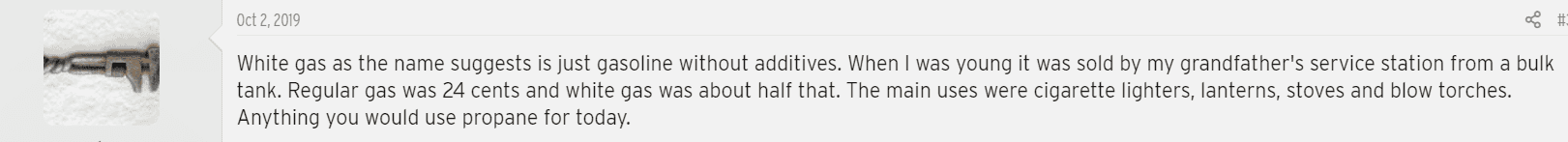

Ah, no. White gas is naptha. Put it in a device intended for kerosene and it will be an exciting experience.
Lots of "definitions" and understandings depending on your age, the era we're talking about and so on.
I was talking about a guy who ended up with kerosene instead of GAS when he asked for white gas. He thought white gas was kerosene and stations around back then only knew regular gasoline and kerosene so when he asked for white gas - which should have been unleaded gas, he got kerosene and thought that is what was meant when he was told "use white gas". White gas is gasoline, not naptha.
From a lantern/camping web site -
Coleman white gas and kerosene are two different products. Coleman white gas is a liquid form of petroleum gas that is made from 100% light hydrotreated distillate. Its component includes cyclohexane, heptane, nonane, octane, and pentane.
and
Jeep Gladiator Sugar in gas tank, help! 1708370168179
And that's different from Coleman fuel which is called "white gas.
Jeep Gladiator Sugar in gas tank, help! 1708370611354
That's what he should have gotten - unleaded, plain gas.
White gas for us, me, when I think of white gas is camp fuel.
So it depends on your perspective and timeframe.
Since some were still using old-time lanterns in that era, you saw both being used in lamps and it was deemed to be interchangeable for some things.
i recall buying white gas from a station for use in a gasoline lantern I had for camping in the 1980s. It was gasoline, not naptha.
My father-in-law was specific - no regular gas, no kerosene, no canned fuel - white gas from a station.
That thing worked for us for years - burned nice and bright, and enough heat that you didn't use it inside on a hot night.
True, packaged Coleman fuel is, I think, a newer thing. When I was younger you could still go to an Amoco station and get "clear unleaded", i.e. gasoline with no additives, but I don't think anybody sells such a thing any more, except for maybe the unleaded and non ethanol fuel sold in hardware stores for small engines. Ordinary gasoline will work in stoves and lamps designed for Coleman fuel, but with the additives it may not burn as cleanly, and may be less healthy to be around. If you look at a can of Coleman fuel it says (or at least did last time I looked) "V.M.P. Naphtha", which is kind of a vague term for light petroleum distallates (VMP stands for "Varnish Makers and Painters as it's also used as a solvent).
But either way, my original point is that it's not the same thing as and not interchangeable with kerosene.
