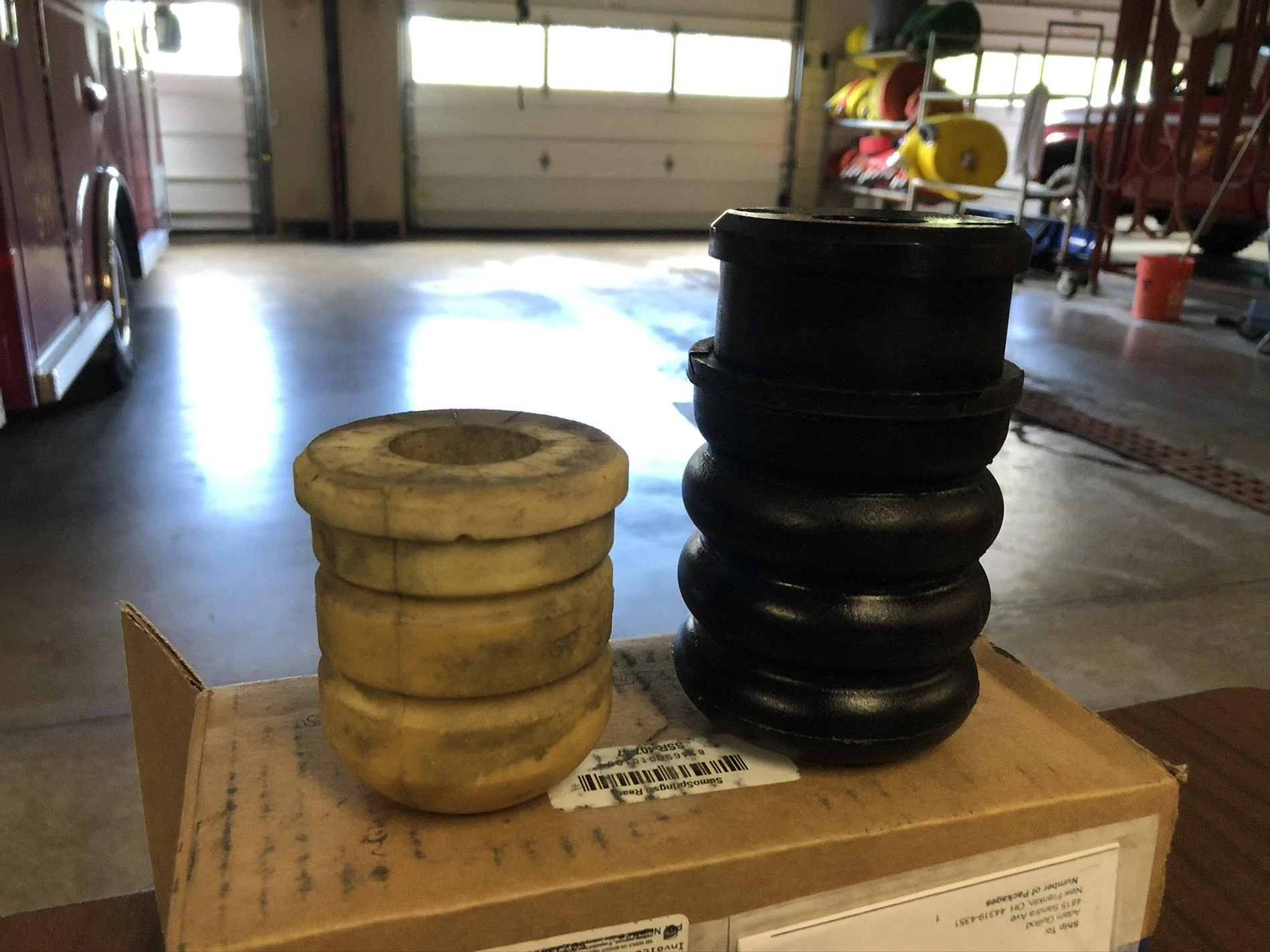

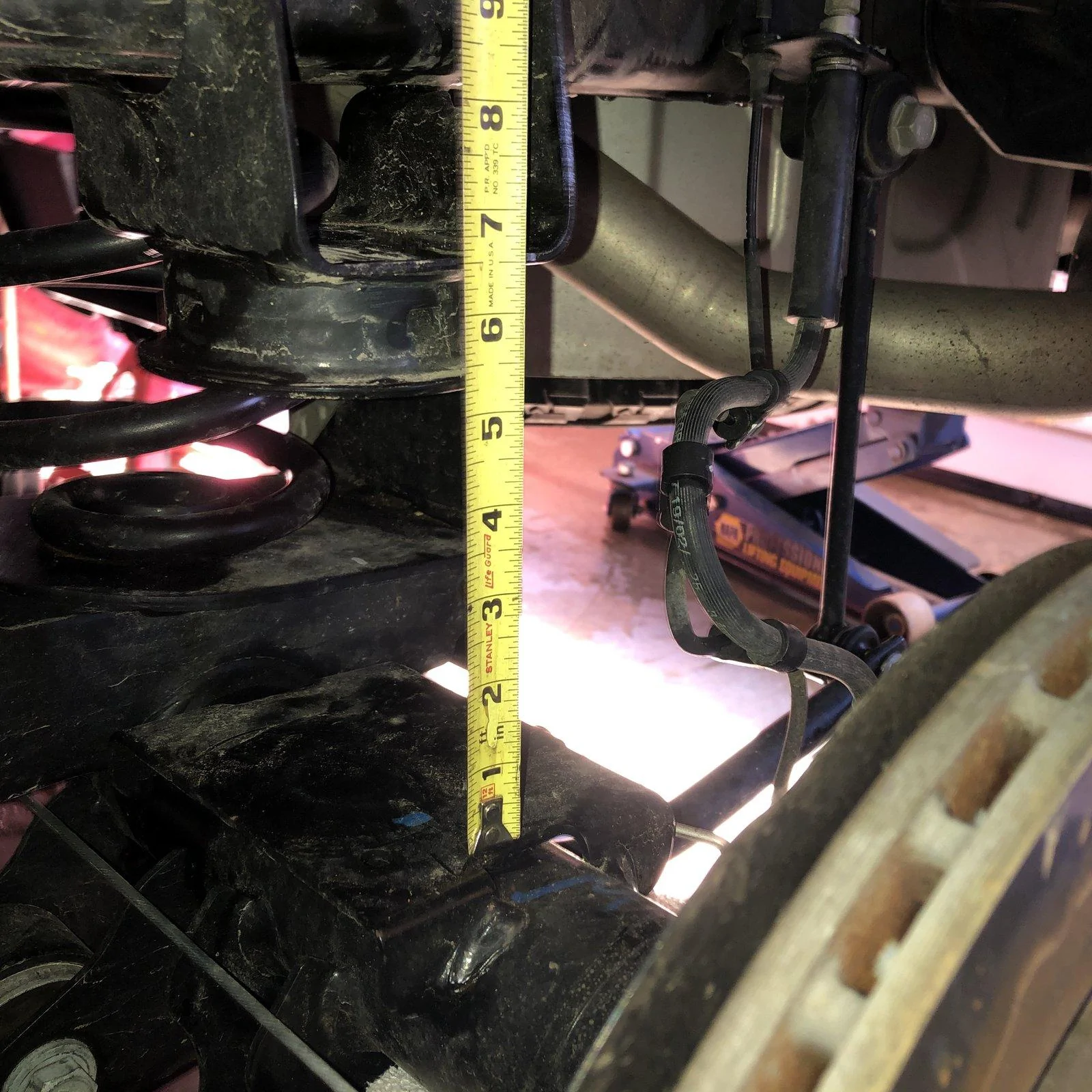

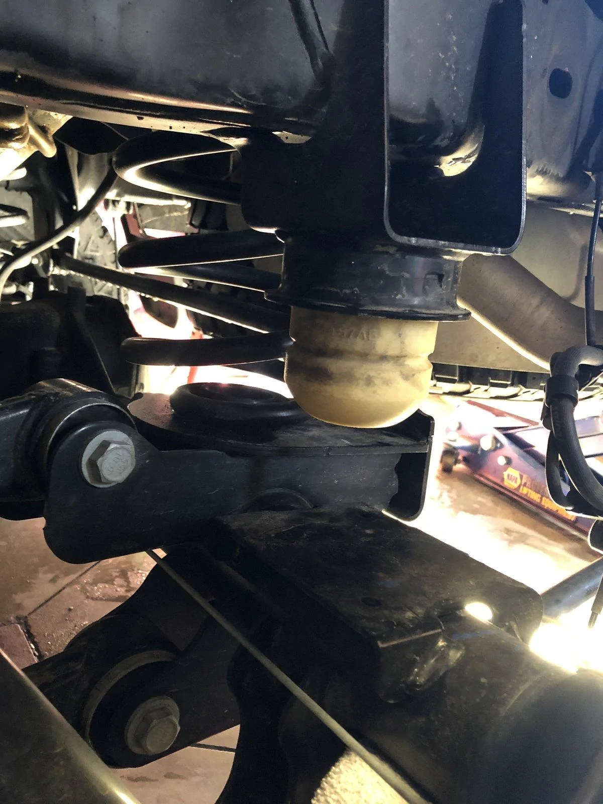

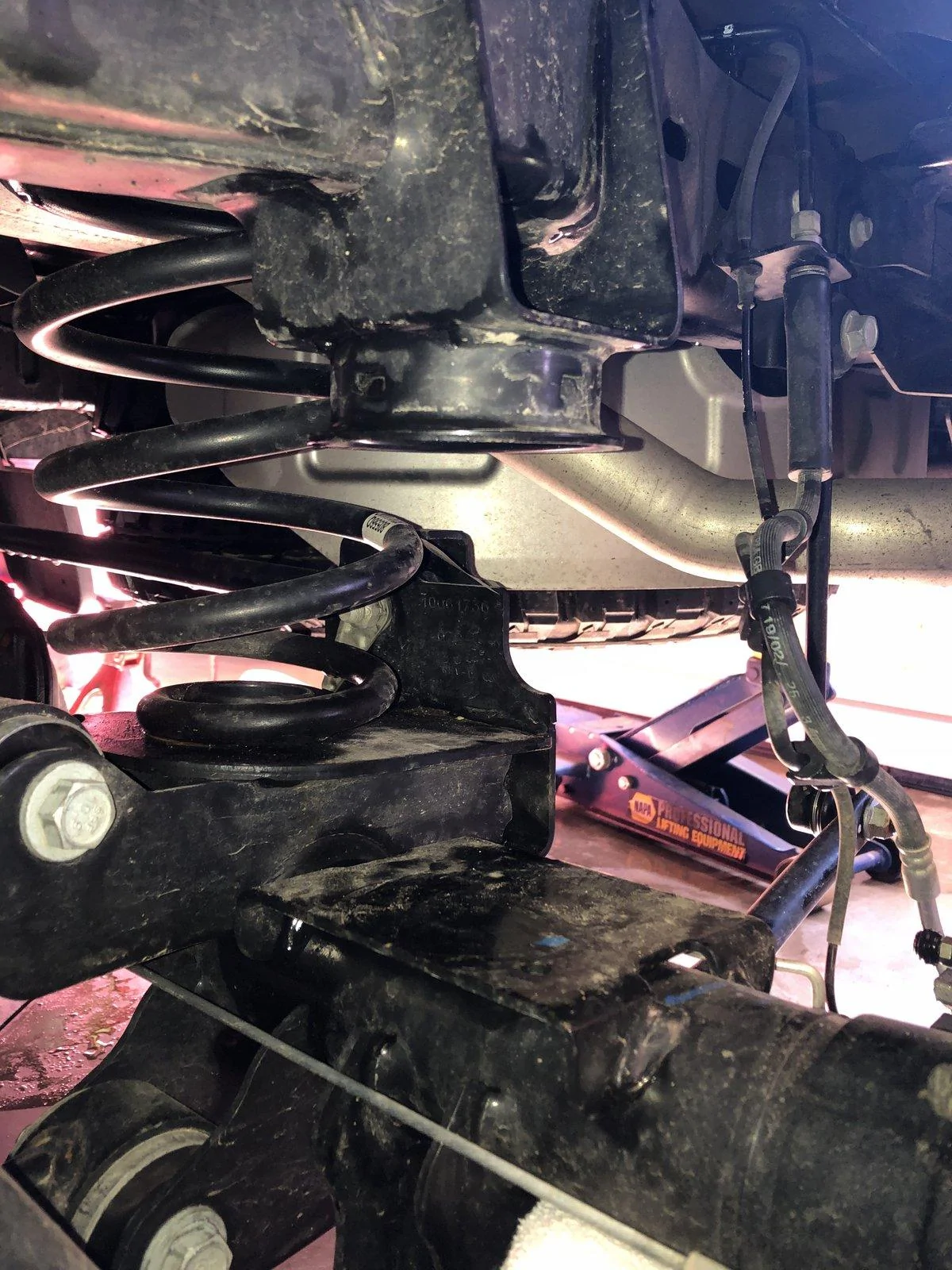

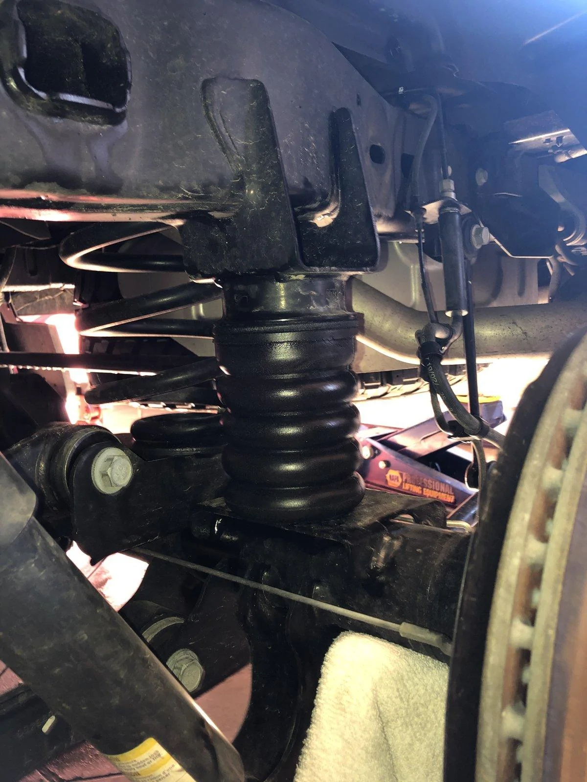

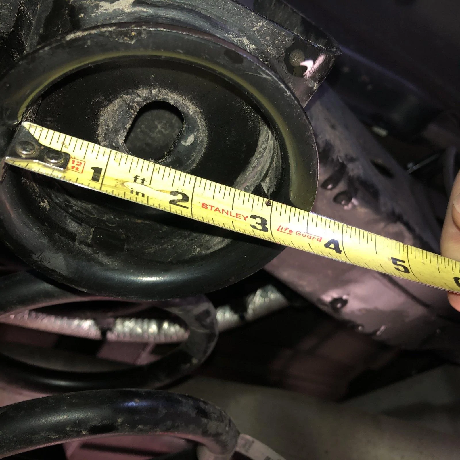

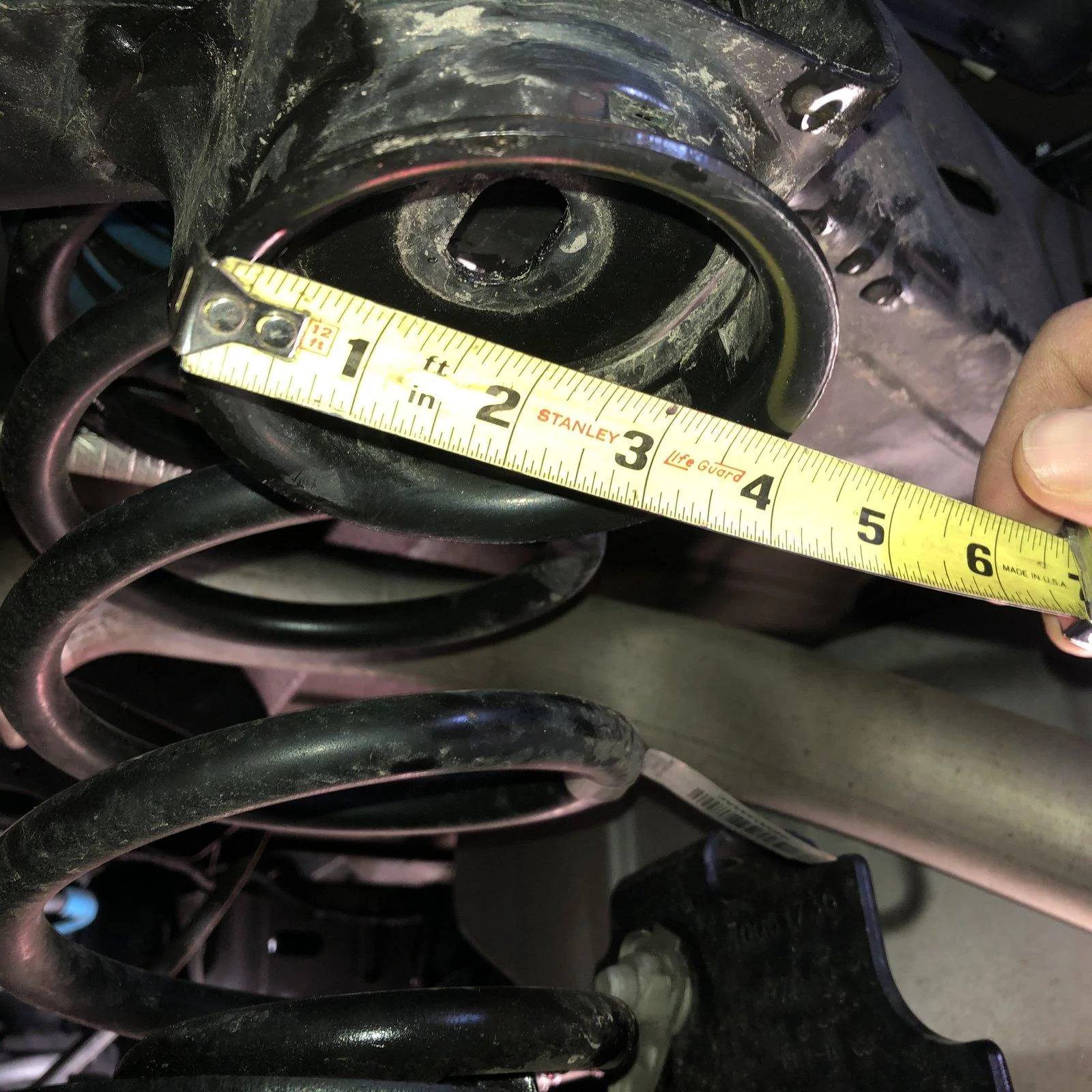

Here are some pics of it helps.
comparing the oem vs sumo
i added a 2in bump stop extension
after the extension the sumos contact with less weight needed in the bed. Making them more useful
It wasn’t needed but I also air bags in the rear. %100 over kill for my JTMT.

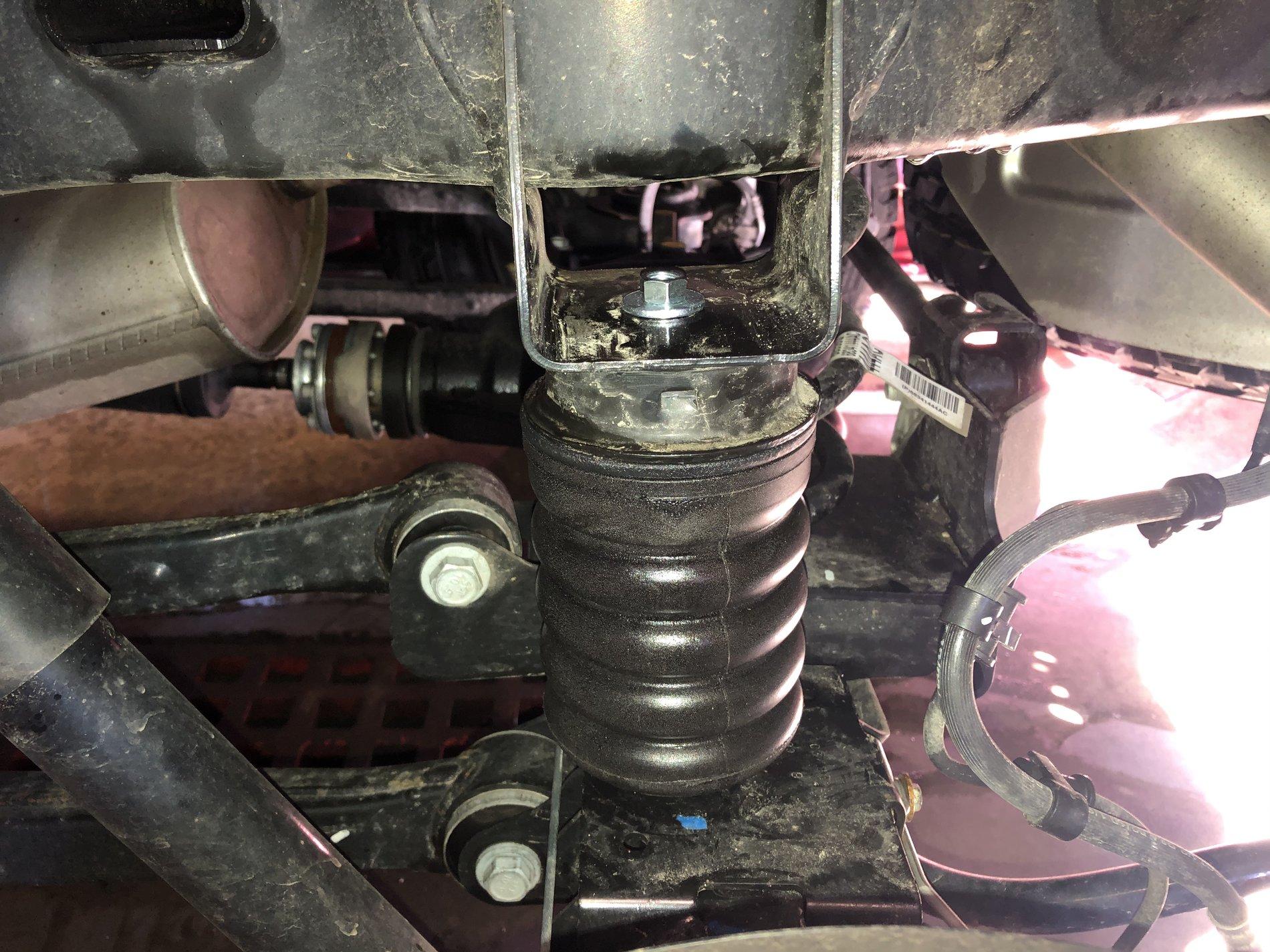

Okay, according to super springs, the Gladiator kit is 5.5” long so about 4.5” outside the frame socket. The universal kit is 5.5”, but it’s essentially all effective spring as there is no material going into the socket on the frame. The 4” washer would cover the socket opening. You will need to buy a bolt to go through the kit and the hole at the top of the frame socket. They also make 1/2” spacers that you can buy for the Gladiator kit, but you have to call customer service to order them. This will space it out further, but also limit travel.

It might for the kit as is, but if you start staking spacers you'd need a longer bolt. With the current 25% off sale, I'm thinking about getting both the Gladiator and universal kits. Figure between the two I can get the fit I'm looking for.
