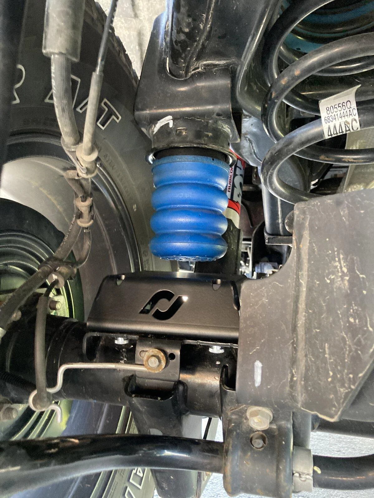

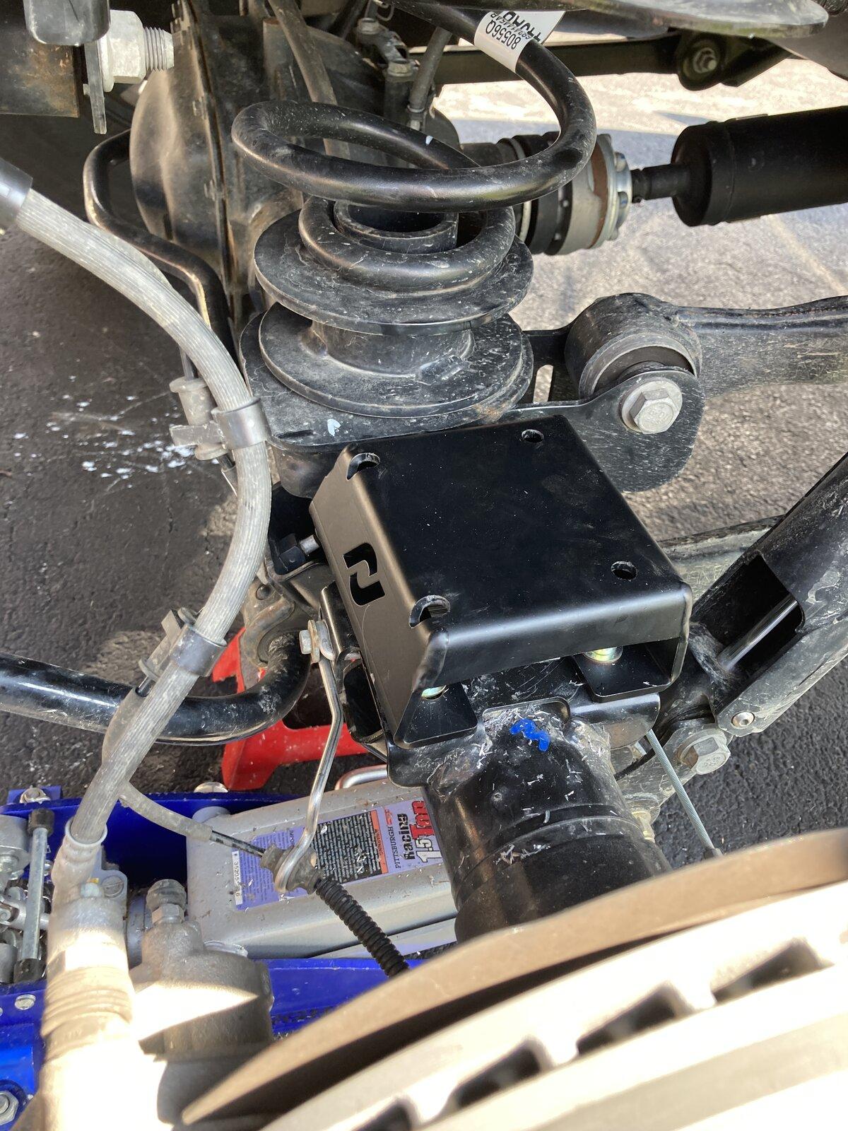

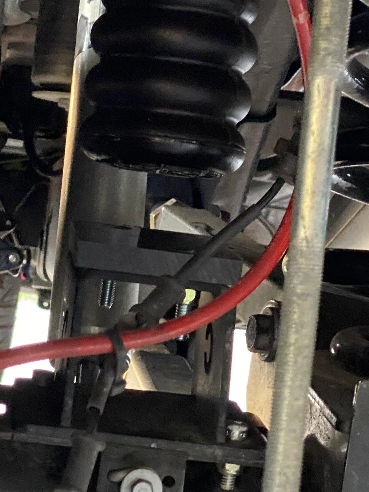

so yes i had to drill holes...2.5 hours later of taking my time and cursing a bit...theyre done.
2in rear bump stop extensions with the blue sumo springs bump stops.

and yea those extensions were a bit more involved than I wanted, but the end product looks nice.

Pulled the TT today WOW what a huge difference
475lbs tongue weight
4750lbs dry weight forest river wolf pup
weight distribution hitch
sat good and level
the bumps in the road were way less noticeable
i had WAY less bounce after bumps
Without a doubt it was a perfect upgrade and worth the time and investment.
ill still be putting the spring inserts in whenever they arrive, just to see what they do.
sits good and level

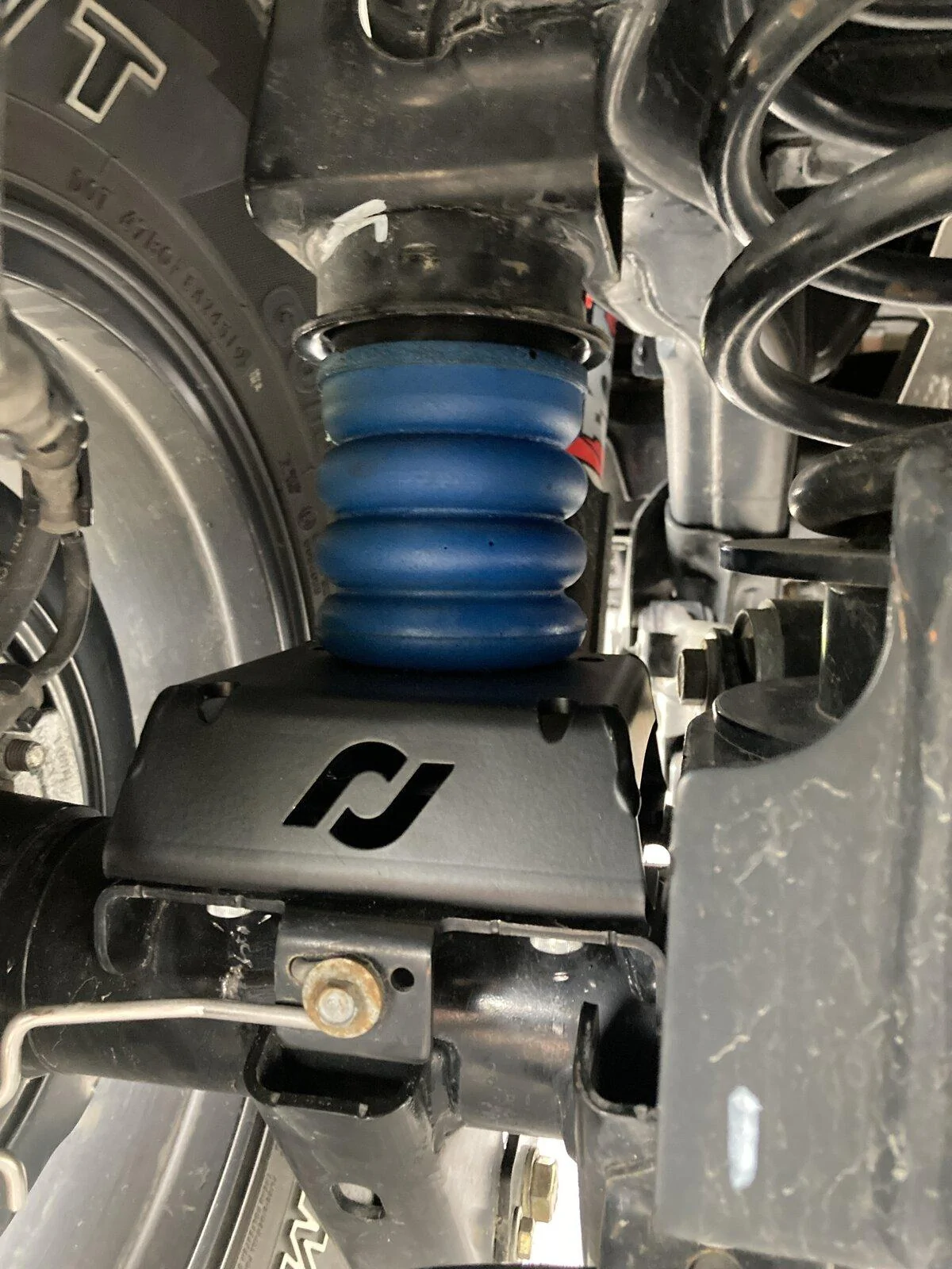

Jeep Gladiator Sumosprings/ Timbren for towing B1CF2B26-8DA3-4677-B59F-4CEC5B415B9D
sumo spring under pressure with weight. It was in constant contact with the TT attached

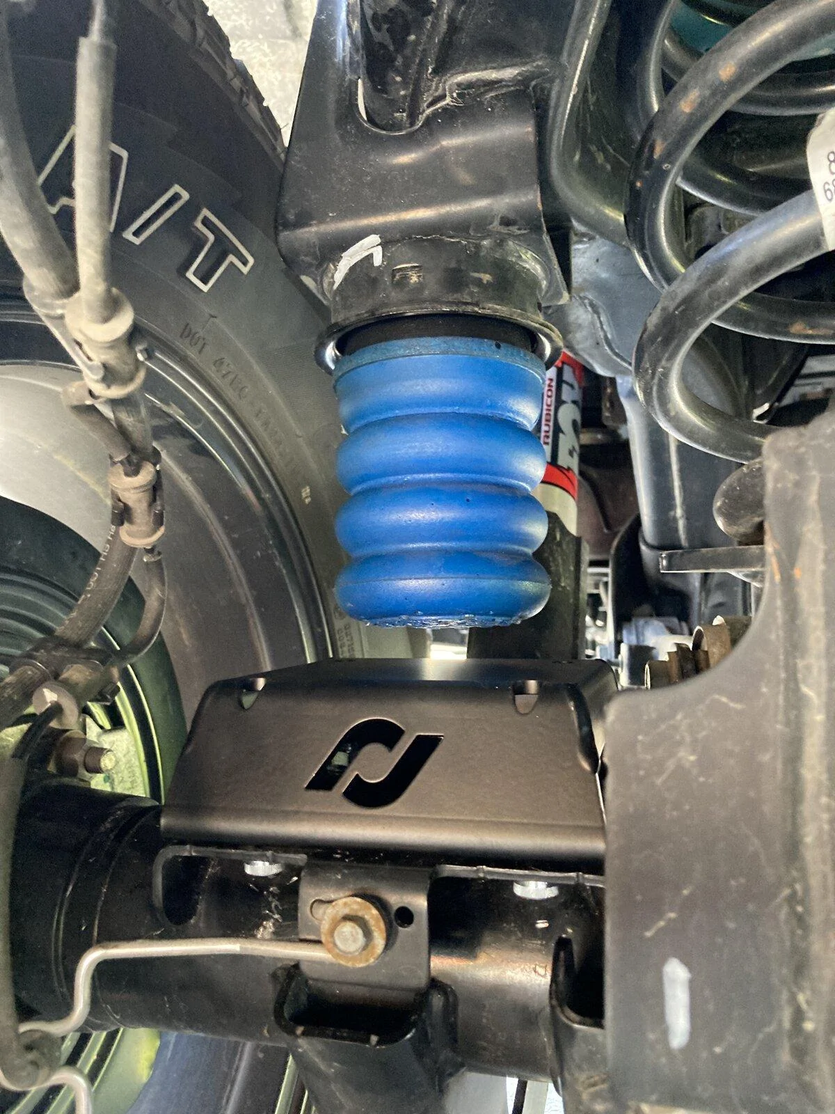

Jeep Gladiator Sumosprings/ Timbren for towing 817500B6-A630-4255-881D-B7B4A4964FA2
for comparison of the sumo w/o weight

Still too far. Going to add one more half inch plate. Clayton has an awesome set up for those that are unsure how much they need. They give you 4 .5 inch block
Jeep Gladiator Sumosprings/ Timbren for towing A1886410-1AA5-4E61-8162-BE4D2C4F4868
I liked their setup and actually ordered just the blocks hoping to make it happen without the base. But it didnt pan out, and the base is meant for 3in of lift if i remember right.

After adding in a total of another inch of spacing. That’s why I like clayton kit. I can go up or down by half inch to get it perfect. If there’s not enough contact I’ll add. Too much. And I’ll take away
