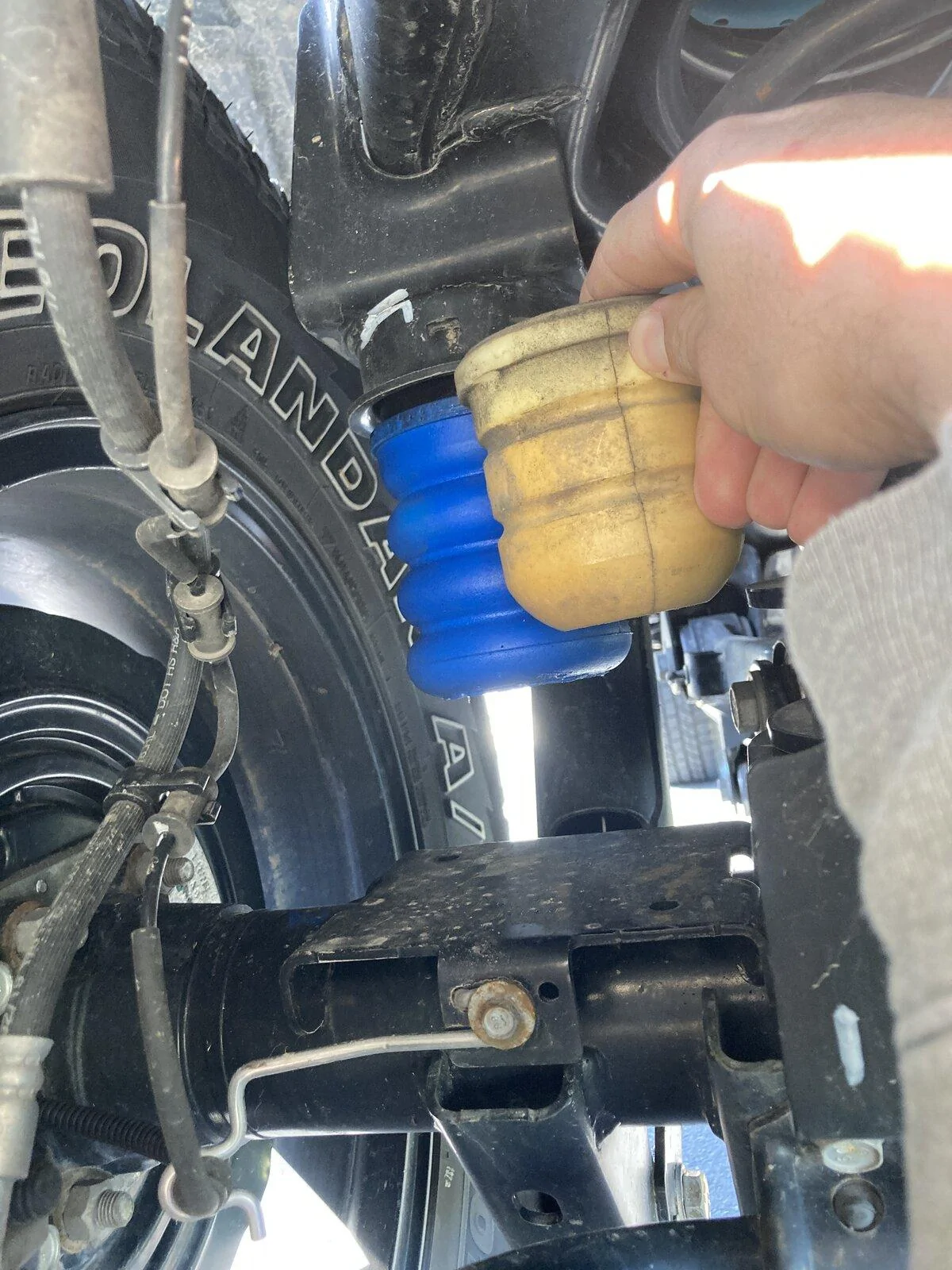

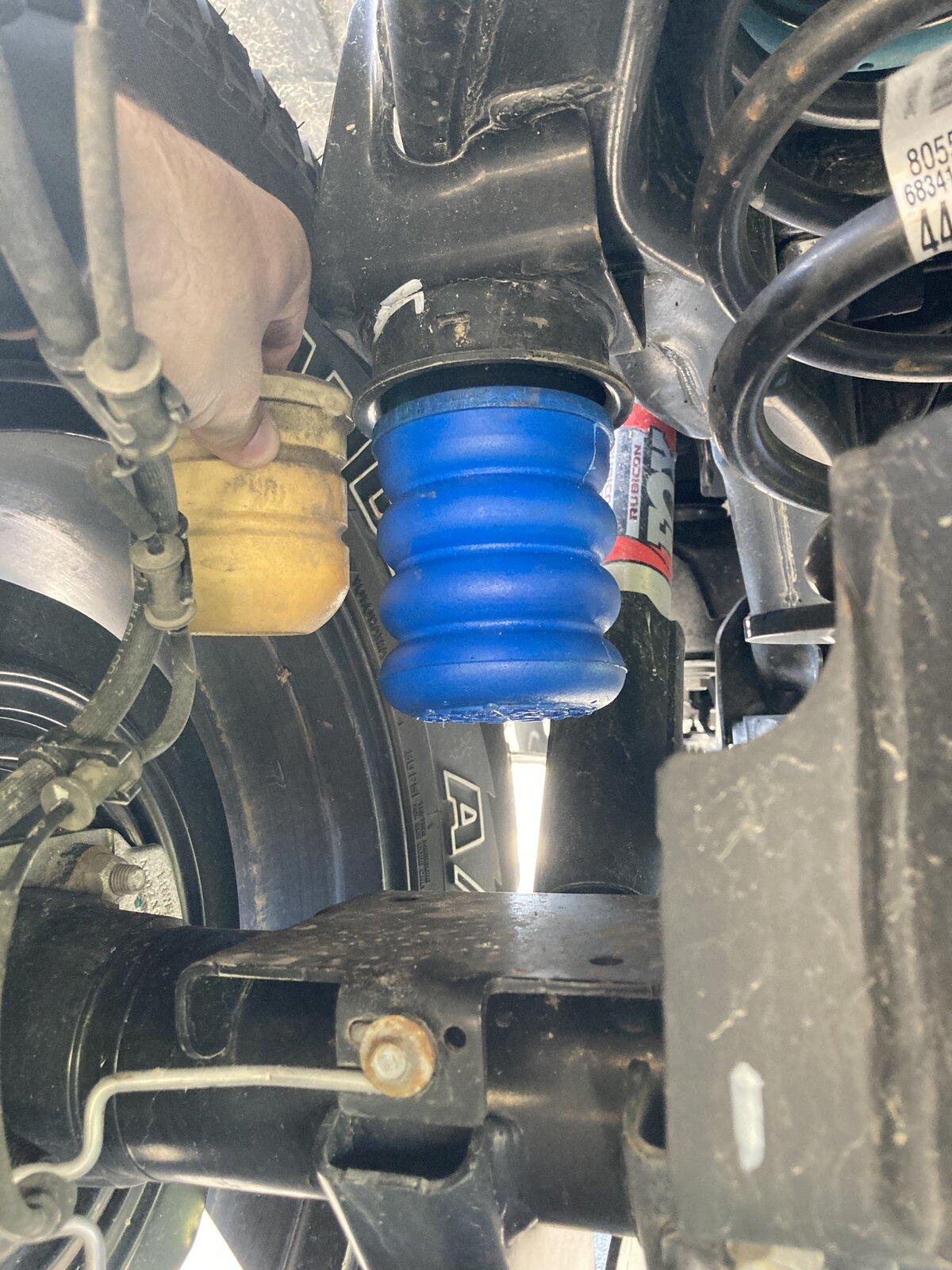

Jeep Gladiator Sumosprings/ Timbren for towing Resized_20210402_120501_1719
It took me about 20 minutes to jack up the truck a few inches, just enough to give myself a little room to pop out the bump stops. It wasn't necessary to have the wheels off the ground or remove them. They came out with very little resistance, I mean little. Just pull to the side and twist out. Cleaned any dirt inside the socket, squirted a little WD-40 on the new ones and they popped in.

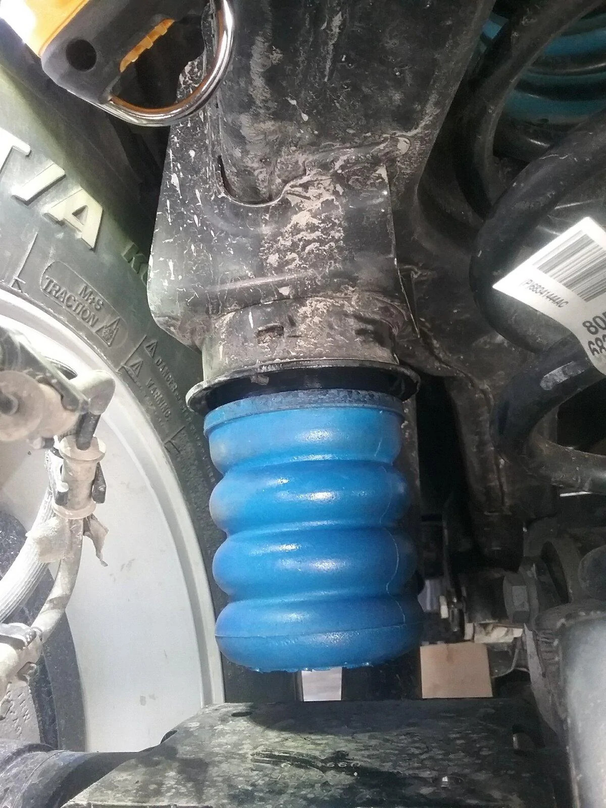

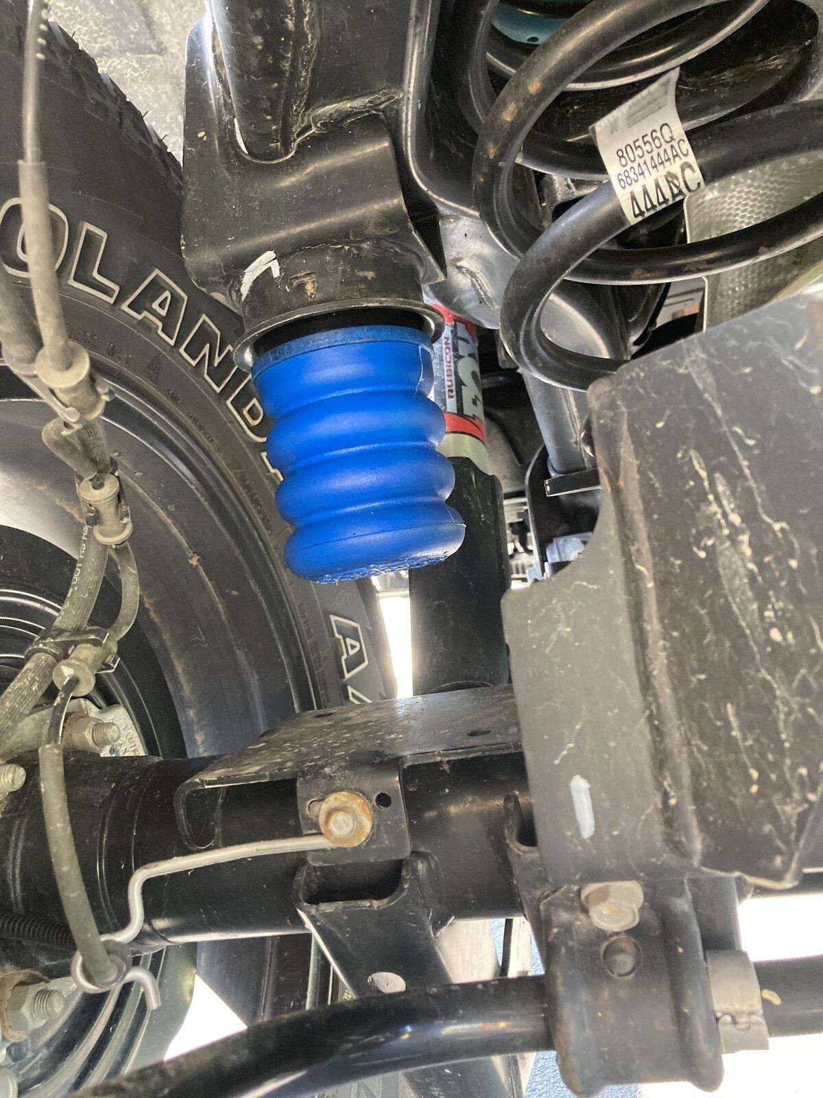

Jeep Gladiator Sumosprings/ Timbren for towing Resized_20210402_130847_5427
This picture was taken after I lowered the truck back down. You'll notice that the Sumospring is not contacting the axle plate. So the truck will ride as normal. They should engage when a load is exerted on the bed like the tongue weight of either of my trailers and other gear.
Now my camper is still in storage and probably will be for another few weeks so I won't be able to give any feedback on how they will perform.

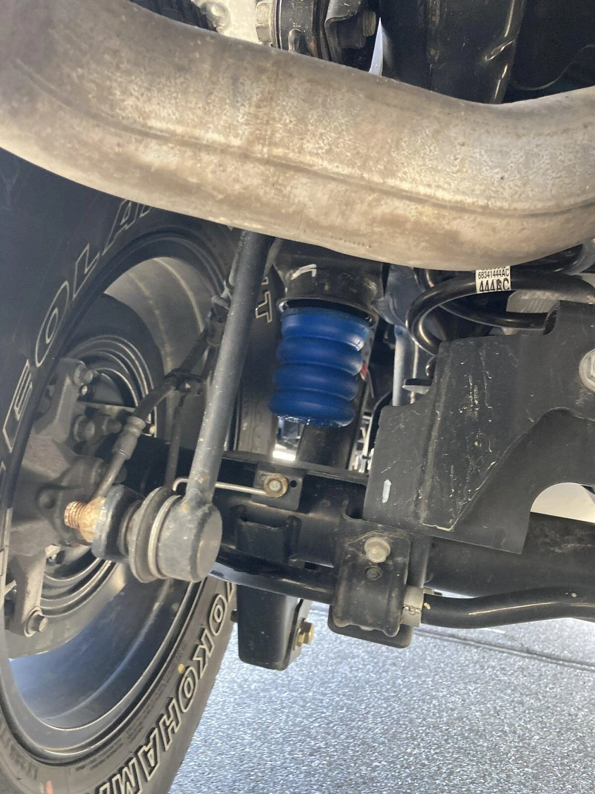

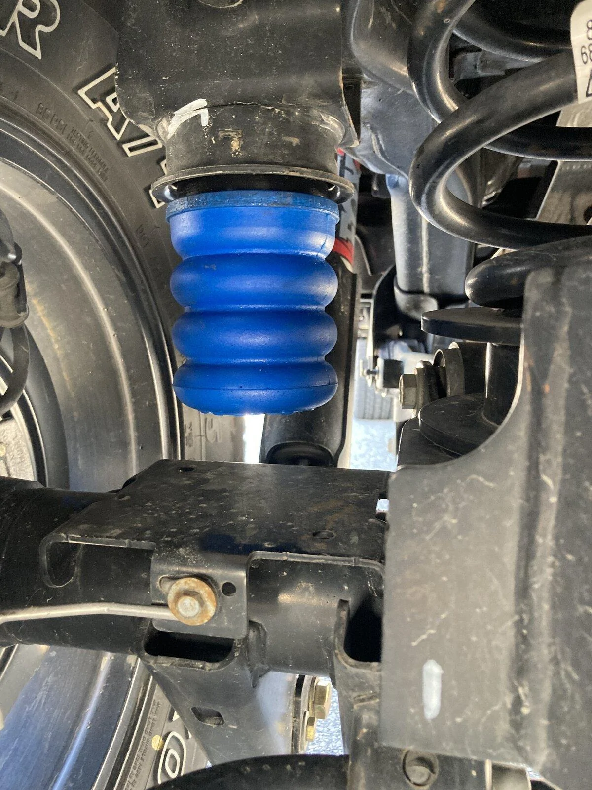

BEFORE TRAILER
Jeep Gladiator Sumosprings/ Timbren for towing 4D96FDFC-812F-4D91-AA09-56904AA32AA8
Jeep Gladiator Sumosprings/ Timbren for towing EF14022F-81F9-4FB7-B8D0-2E3EC9BB91E4
Jeep Gladiator Sumosprings/ Timbren for towing B6EEA9F2-81A4-47A6-89AE-D59DABC26A6D

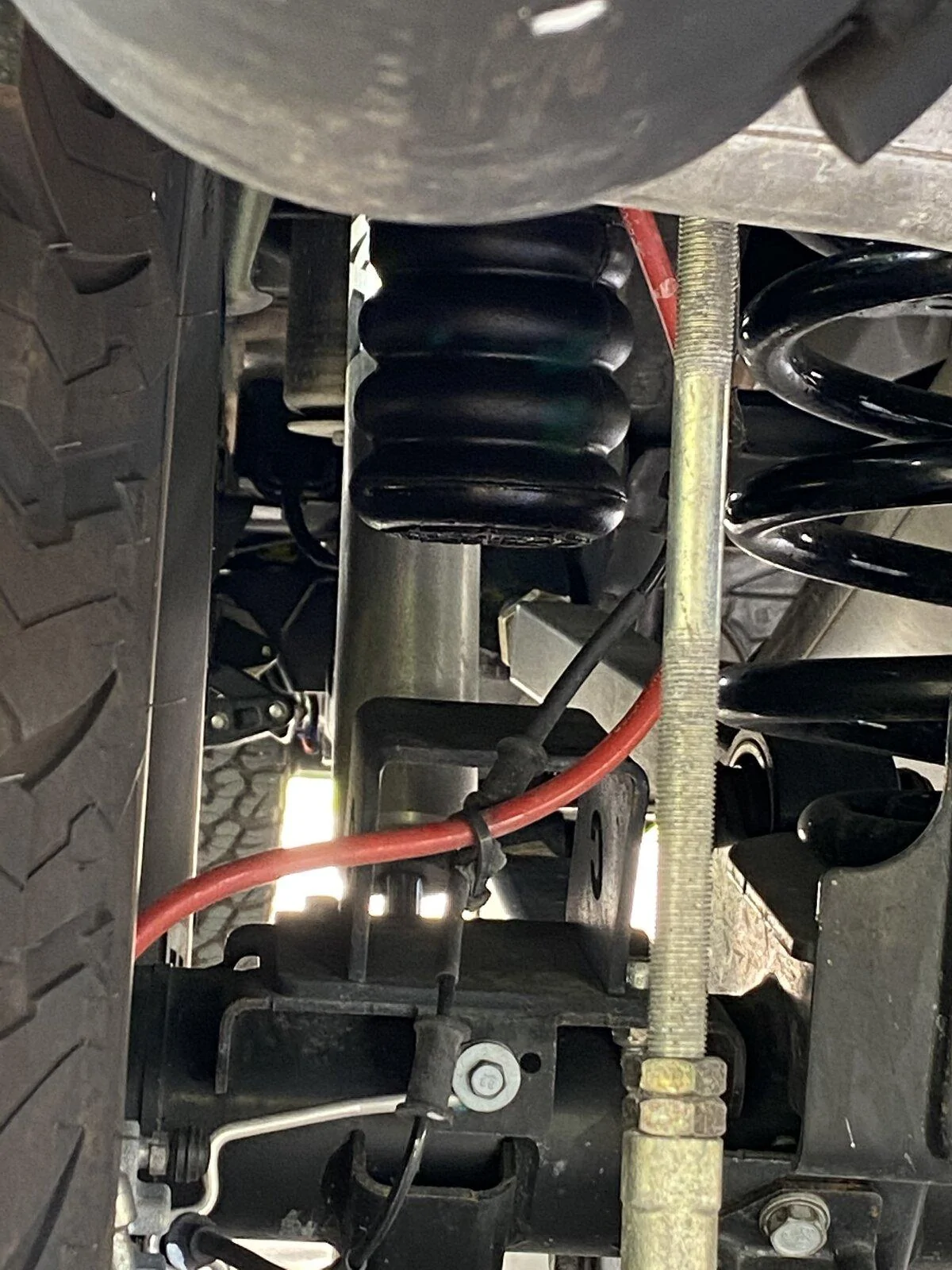

AFTER TRAILER WEIGHR ON TRUCK
Jeep Gladiator Sumosprings/ Timbren for towing 2D43A93D-9229-4ED6-8D31-DFD26BDC46BE
Jeep Gladiator Sumosprings/ Timbren for towing 79C24C68-5977-4145-9985-4EEA446D2259
the tail end definitely sinks some. Can’t honestly say that I noticed the difference with them except that some of the bumps I didn’t quite get as much bounce afterwards so maybe they help there
