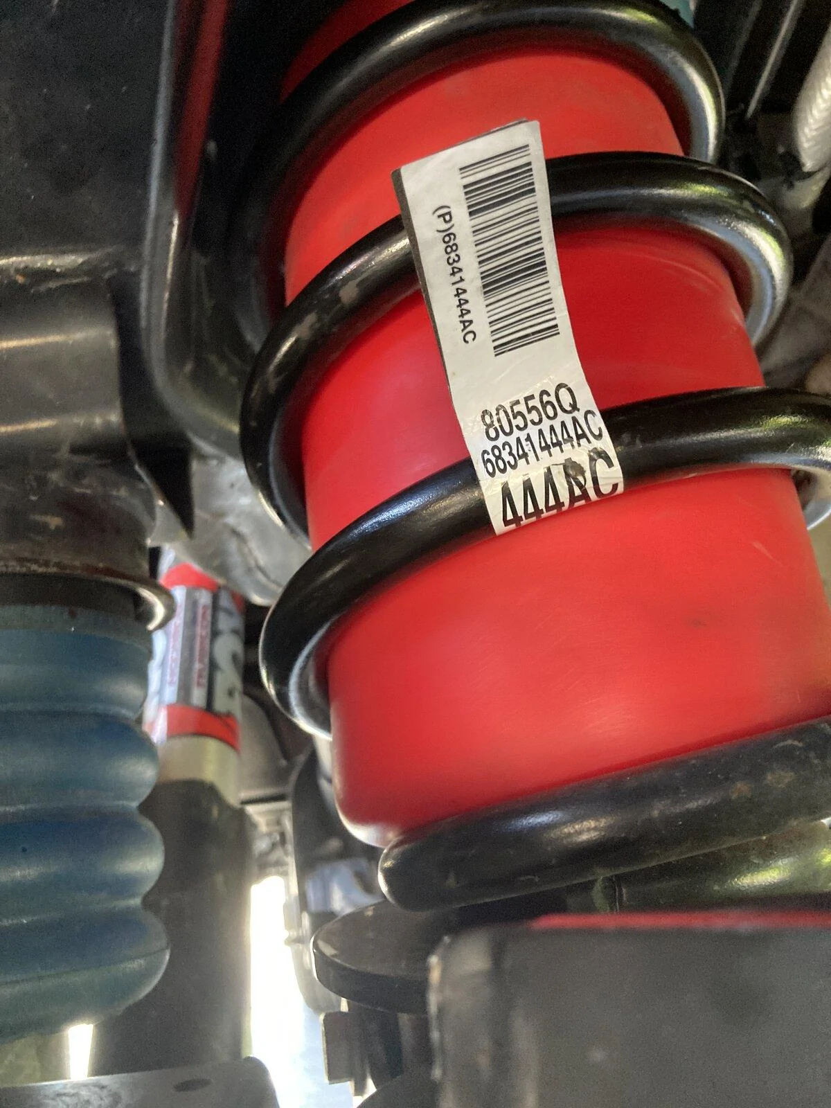

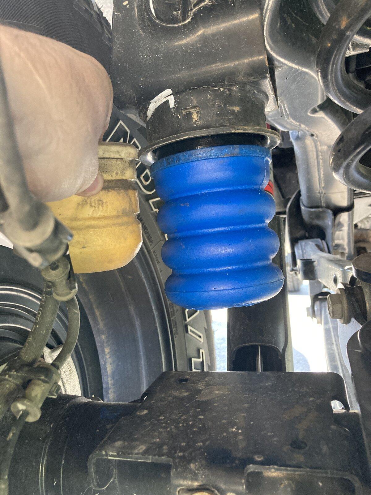

Has anyone measured the sumo spring for the gladiator? The website states 11x8x5”. Not sure what those correspond to since it’s a cylinder. I have about 6” between the bump stop and the frame socket with the 2” Mopar lift. Looking for something to just contact when I have the cap and RTT on.

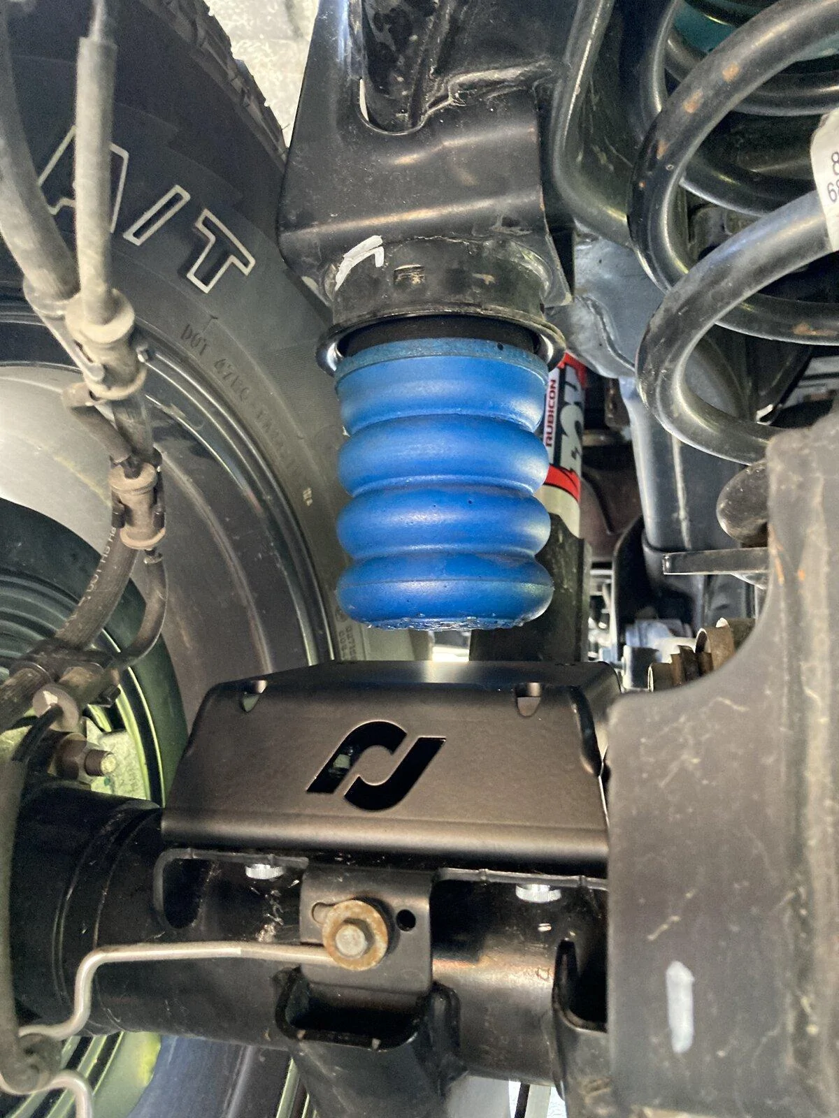

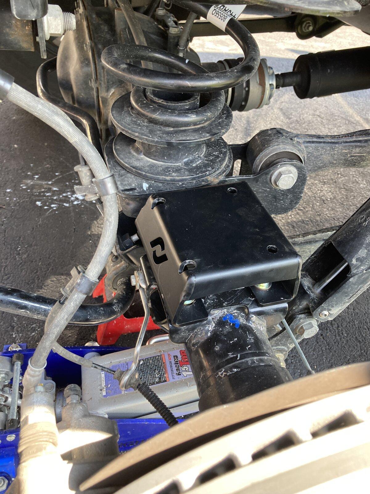

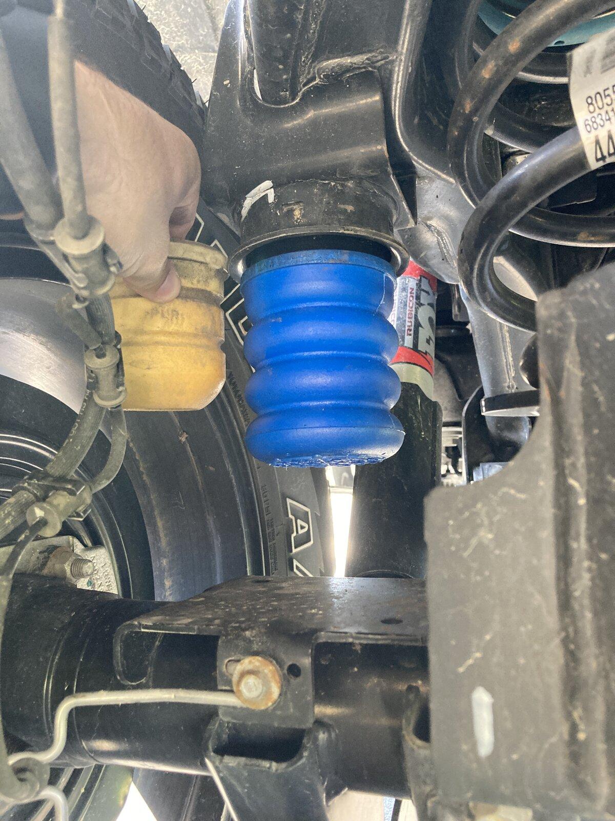

Here are some pics of it helps.
comparing the oem vs sumo
Jeep Gladiator Sumosprings/ Timbren for towing 1D4DF2AE-5D2D-4A45-886A-4BB40B211A0C
Jeep Gladiator Sumosprings/ Timbren for towing D7B73AE1-2A7B-452B-815B-4AFE107BDEC1

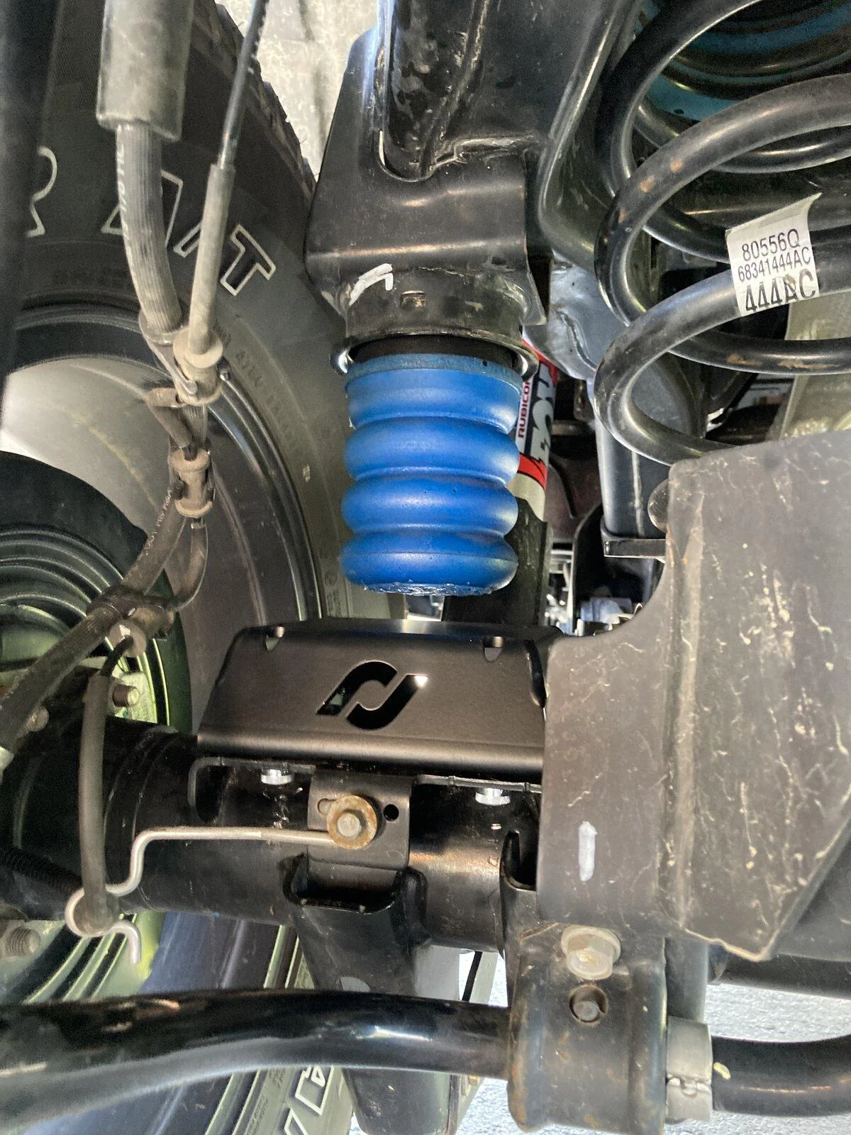

i added a 2in bump stop extension
Jeep Gladiator Sumosprings/ Timbren for towing ABFE9D5B-464F-4B9A-ACC3-DFD21B0702E6
after the extension the sumos contact with less weight needed in the bed. Making them more useful
Jeep Gladiator Sumosprings/ Timbren for towing 41725EE5-CC6E-4953-B3D6-1B8B90090775
Jeep Gladiator Sumosprings/ Timbren for towing DD5F178C-9B0F-49EF-AEEA-AE76DCB81DBF

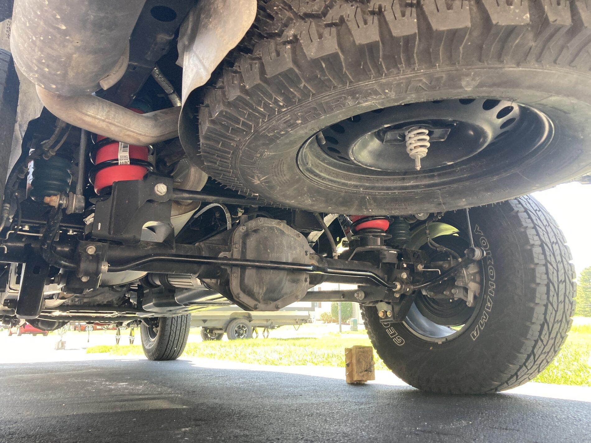

It wasn’t needed but I also air bags in the rear. %100 over kill for my JTMT.
