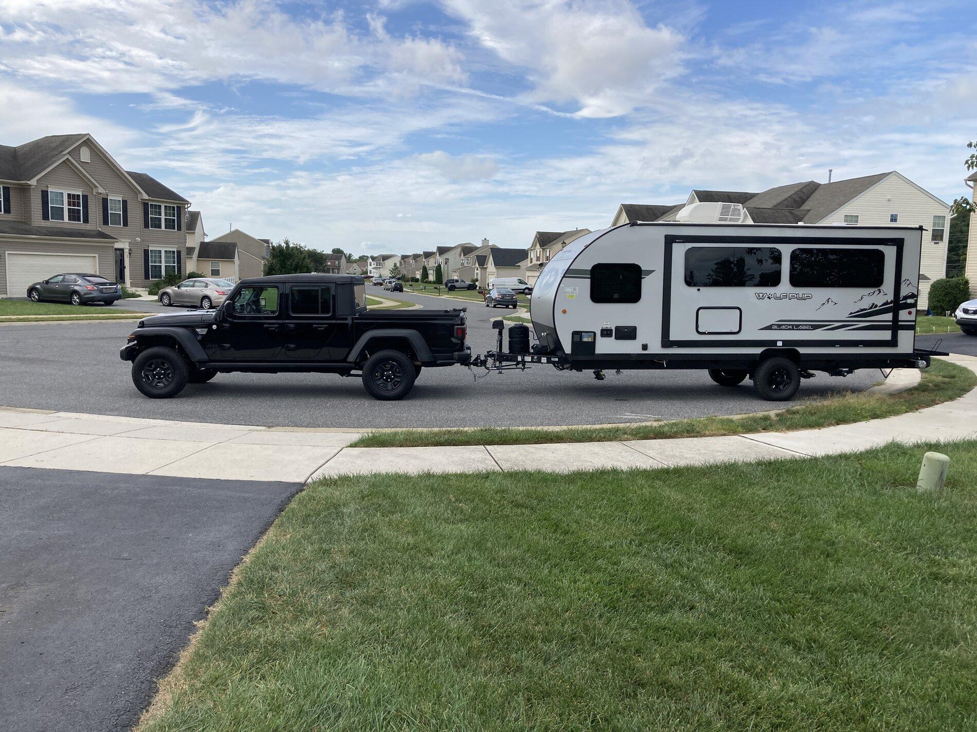

The combo of the two make for a very nice ride while towing. I run the bags at 20-25psi that way the sumos are just barely touching the contact pad. Im pleased with the combo for sure. My travel trailer is close to 5,000lbs loaded with a single axle and rides nice.
Good to hear. My dad had a wolf pup that I used often. He just sold it and bought a grey wolf 22rr. That is what I will be pulling. Looking forward to the extra space and 2nd axle. Not looking forward to the extra weight!

Yea that hitch weight will be interesting. With a good wdh and either the sumos or bags…or both….will make a marked difference. And thankfully the bags and sumos are inexpensive and easy to install
interesting side note, i put a set of sumos on the wolf pup aswell. They help with trailer movement and bounce. I sorta thought it wad a gimmick until i put them on. They really actually helped a lot!
