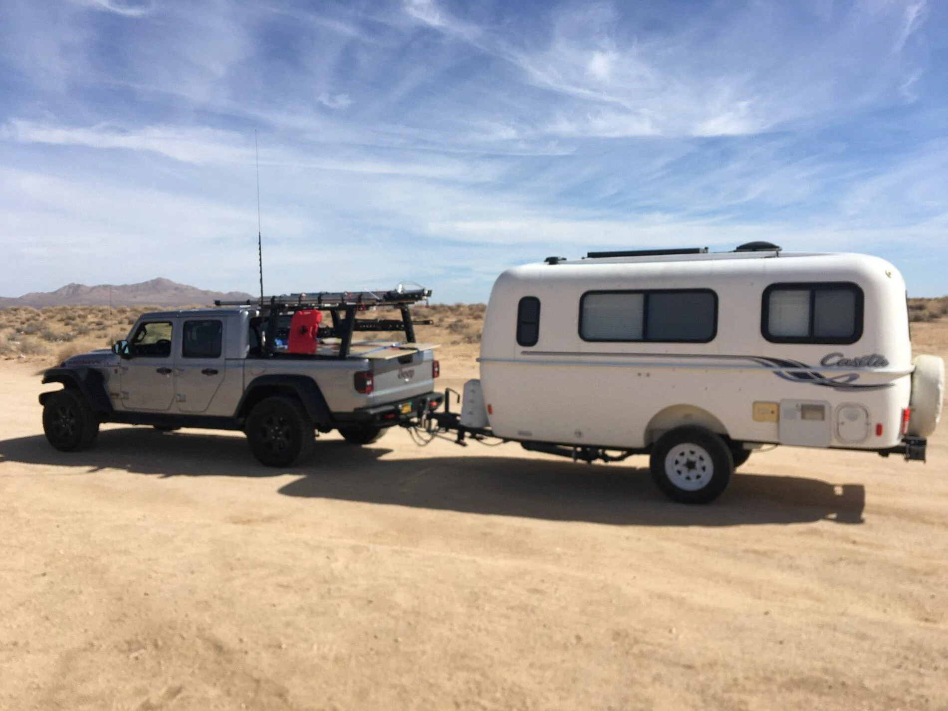

My trailer is about 3200lbs loaded and I carry a couple hundred lbs of stuff in the bed. I have an Anderson WDH and Airlift bags in the rear coils.
When I connect up the trailer I add about 25lbs to the air bags to get the truck near level then tighten the chains on the WDH to reach stock height and off we go. It hauls real nice until I get offroad then I release tension on the WDH so the dips in the road don't transfer too much weight to the rear of the truck through the WDH. I also drive real slow off road after reading about some bent frames with setups like mine.

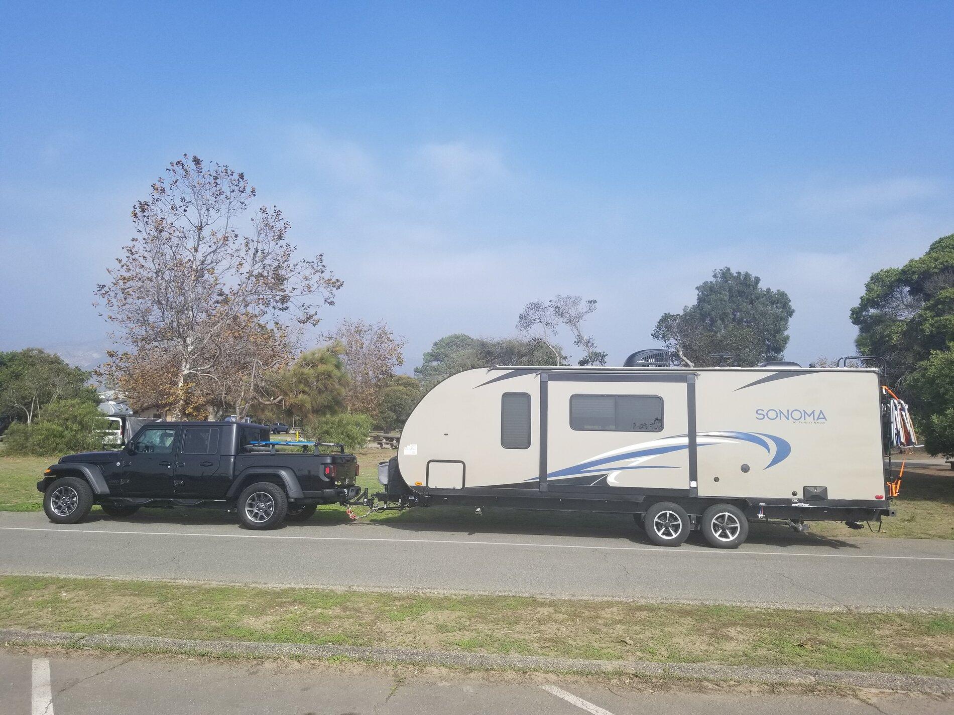

++++1 Airlift. Easy install with 2 individuals + floor jack without disconnecting any bolts. Lifetime warranty. true!! had mine replaced with free shipping 2 years ago.
Yes, 5 psi with no negative effects on handling, just make sure you do not have too much slack or air line could get caught between the bag and spring...you won't be able to add air! Guilty.
I prefer a two-line installation so I could tell easily which side of airbags is leaking, if it happens.
I have used it with my sienna van, toyota 4runner, honda pilot, and now the G.

It's 5300#. But, boy, I have to travel light. Good thing I have the max tow pkg.?
On the airlift, if you get it, customer service can look for the receipt for you if you bought it from a distributor. No hassle warranty claim. I had a leak on one bag after using it for 3 years, they sent me a set of bags for free!!!
