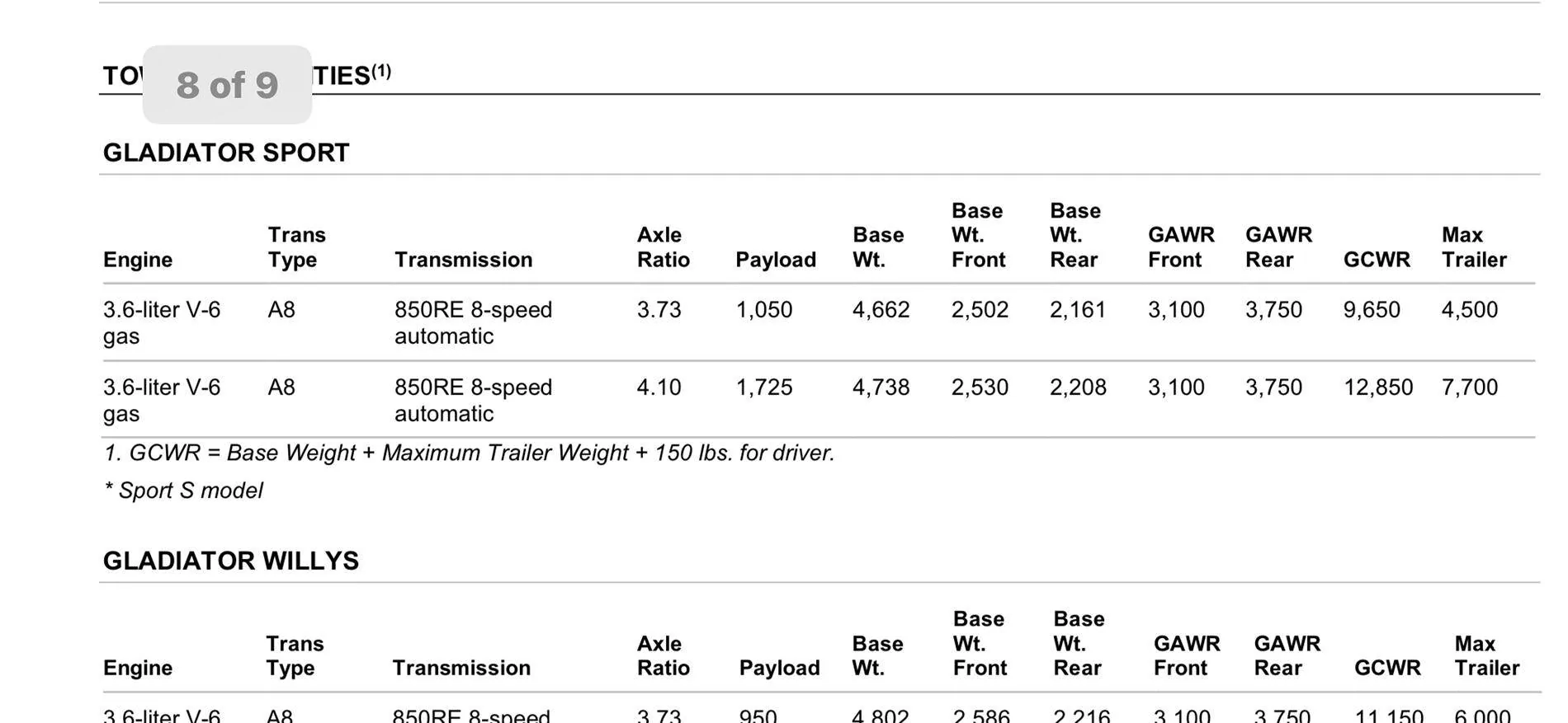

https://www.jeepgladiatorforum.com/forum/forums/forced-induction-aftermarket-supercharger-turbo.42/ Yes Rubicon is rated to 7,000 towing capacity. With a CGVWR of 12,450. However unlike max tow the payload is only 1,100 lbs! Remove the lower 10% tongue weight at 700 lbs, only leaves you 400 for passengers, gas, weight distribution hitch and all supplies! But 10% is the minimum, that’s only recommended on lighter than max trailer weight ratings, use the 15%? You could not even sit behind the wheel and be legal! Of course you are allowed up to 12,450 CGVW, so how all the extras in the trailer if not over 6,600 lbs to stay under the combined gross weight ratings. All that is a bit much with the 3.6, that will spend a lot of time in the 4,000-6,000 rpm range, all that is only with an automatic!
Sport Max Tow is over 7000.
