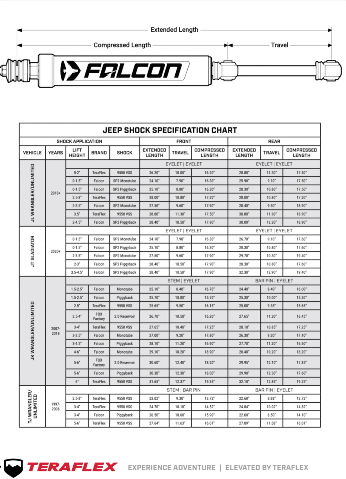

A lot of us with the 3.5" lift kits are running the long rear Falcon adjustable shock that has a total length of 32.30". it is a great length and a fantastic shock that can give you a ton of articulation, but, it does bring you to the brink of "looseness" on some 3.5 inch coils... For me, it's worth the extra fiddling and the retainers to get that full 32.30 inches.
Check out the Falcon shock length chart.
