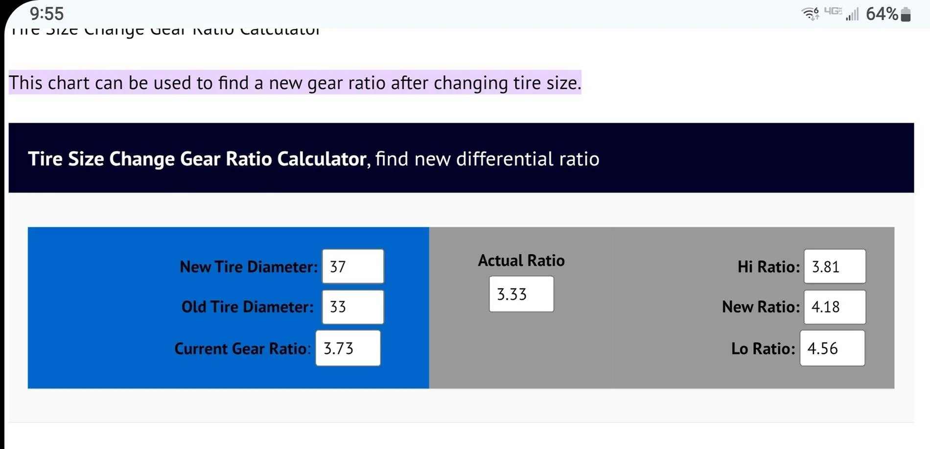

I stand corrected, on looking at the website that chart does indicate it is based on 65 mph, but still our trans are completely diff. So if I am out of overdrive of 8th gear and in 7th which should be close to the 1:1 I am still only doing about 1900 at 65mph. One still needs to know more information and one chart is not good for all vehicles.
Respectfully, you all are missing the point AND the information in the chart. Speed DOESN'T MATTER. ENGINE TYPE DOESN'T MATTER. MANUAL OR AUTOMATIC DOESN'T MATTER.
The RPMs and engine and gear selection or any of that isn't the point. The point of the chart is to find a final drive ratio that matches a stock vehicle using the tire size and ring and pinion in the vehicle. Forget about what the RPM is in the chart, except that it is the benchmark of stock gearing. IT is just a number to match, not real RPM.
If your Jeep in stock configuration came with 31's and 3.73, check the chart and find the numerical factor. Which is listed as RPM. The numerical factor is not your actual RPM! They call it RPMs but it is just a figure for you to match. If it says 2600 with 31's and 3.73, then see what your desired 37 inch tire rates with the same 2600. It might be 4.56 or 4.88. You want to match the fictitious RPM btwn stock and your desired tire size.
My goodness JeeperS and 4 wheelers and rock crawlers, etc have been using this chart with any and all engines and transmissions for decades. You diesel JT guys are hung up on diesel RPM... It isn't about that. It's about changing tire size and finding out which ring and pinion gear ratio (FINAL DRIVE RATIO) you need to match what came as stock.
I know that you all aren't engineers but it is basic math. Yeah, you have diesel, I get it, You are special. I have a gas JT but I have had several diesels in my life... They all use the same chart!
I have owned a few Ford Super Duty diesels and I used that chart. I had a BMW 328D (diesel) and i didn't put bigger tires on it, so I didn't use that chart. But it still would have worked. For my Jeep Tjs and YJ and Dodge Ram, all gassers, I used that chart. Every seasoned off roader uses that chart.
You have a diesel JT. So get over it, that chart is what you need.

OP doesn’t need that chart. He already figured he needs 4.22 gears to be equivalent to stock.
You can use formulas to calculate desired gear ratio or RPM with any setup. I’d rather do that than use a chart that has fixed parameters.

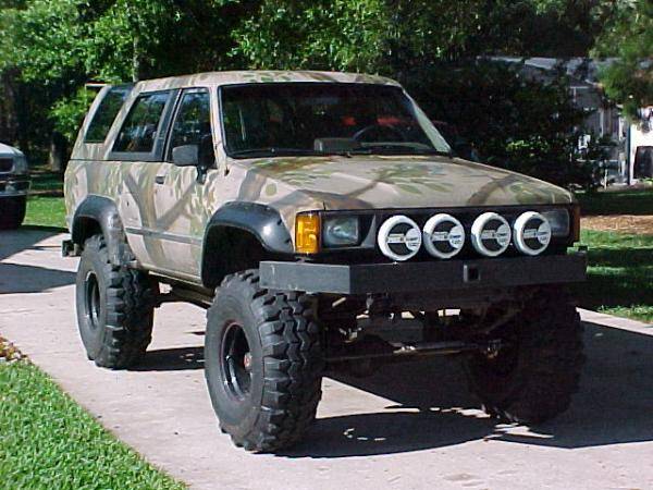

As a side note,
My '85 4Runner came stock with 32" tires and a 4.10 Ratio
I upped the tires to 36" TSL Swampers and 5.29 gears
I did before and after rpm test at 60 mph on the same stretch of road and found only a 50 rpm increase.
That anemic 22RE with barely enough torque and horsepower to carry itself would still pull 5th gear to the point of me not wanting to go any faster floating around on true 36s.

I use the same chart. It's easy to use IF you understand it.

That's the numbers I put into it just now. LOL
