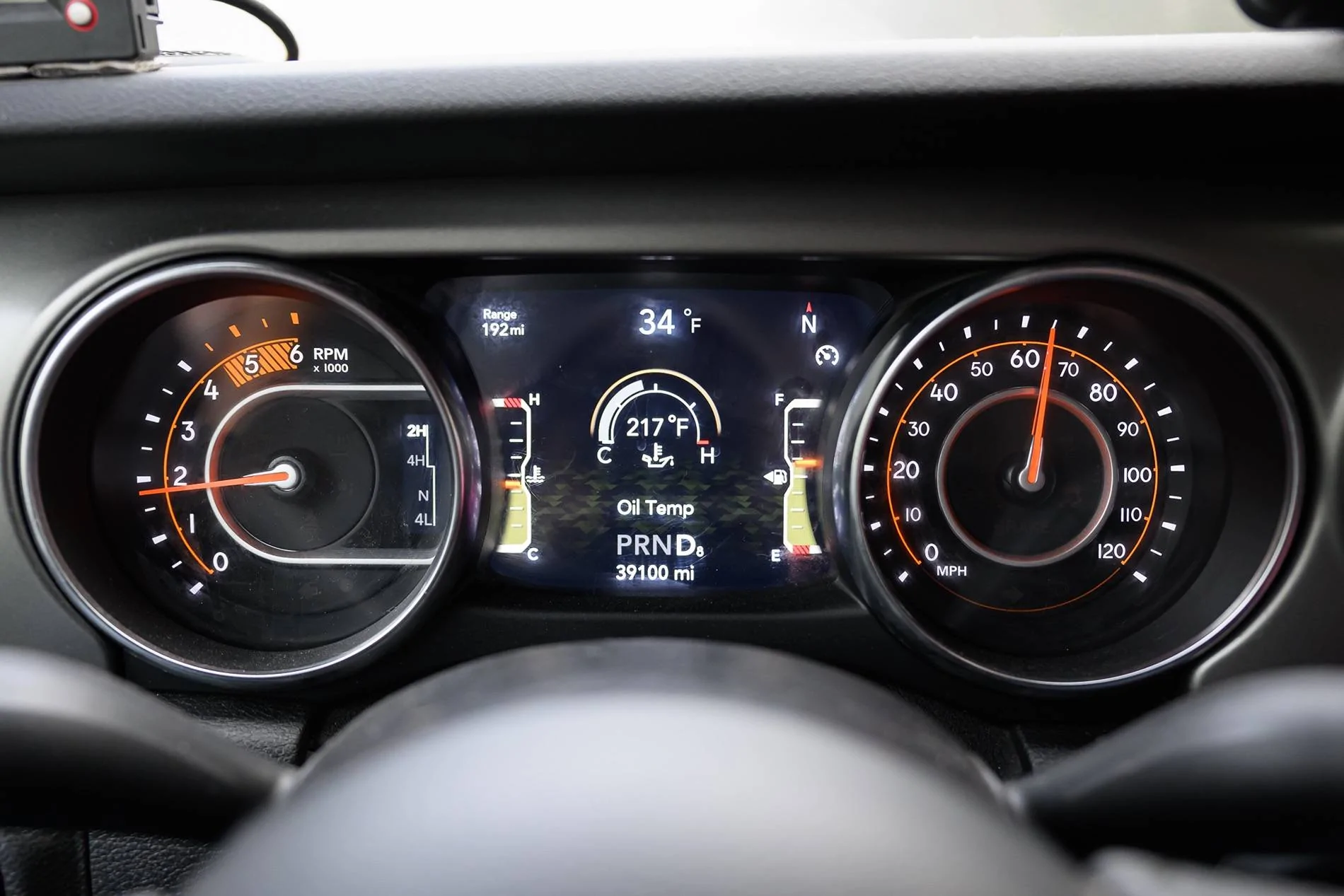

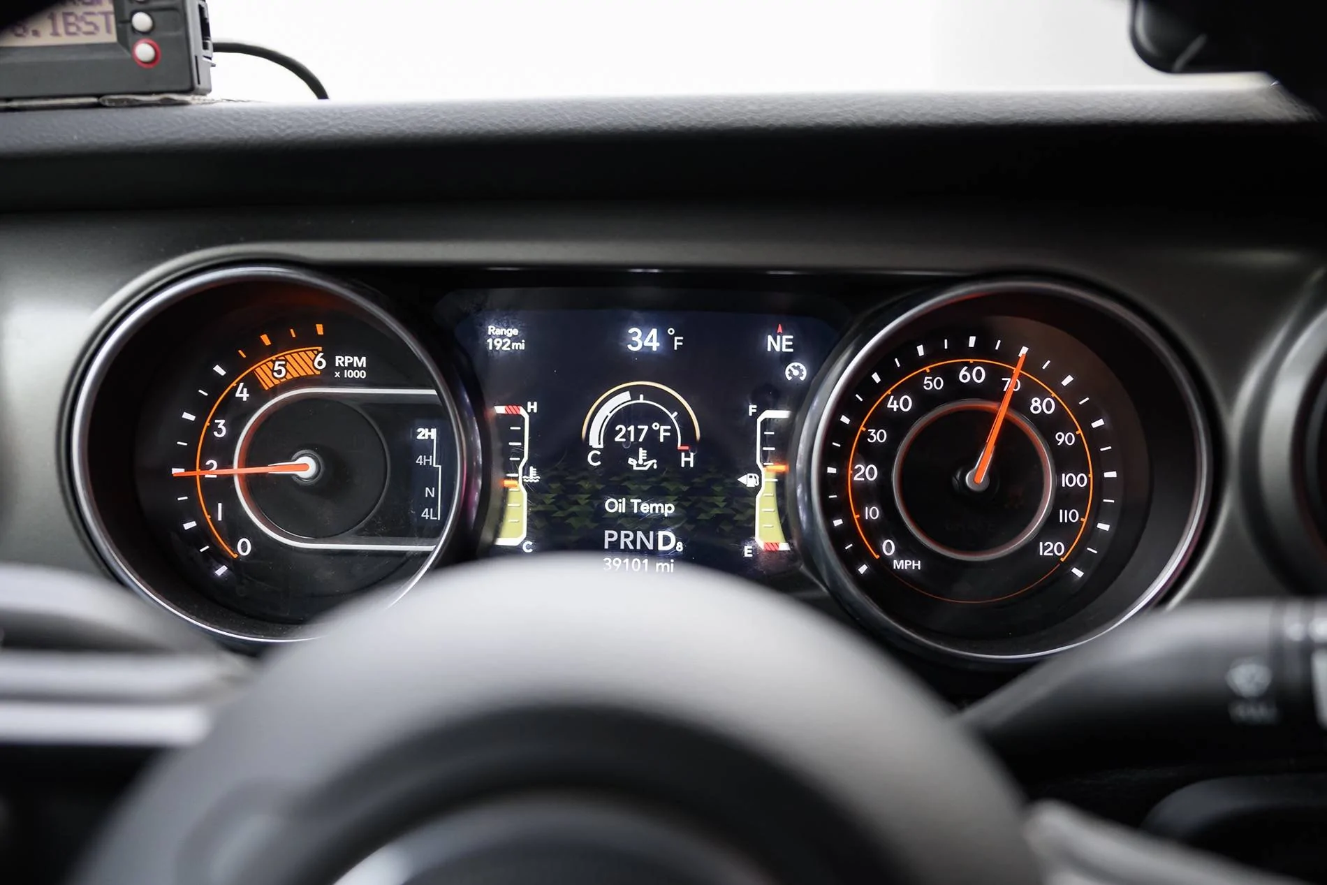

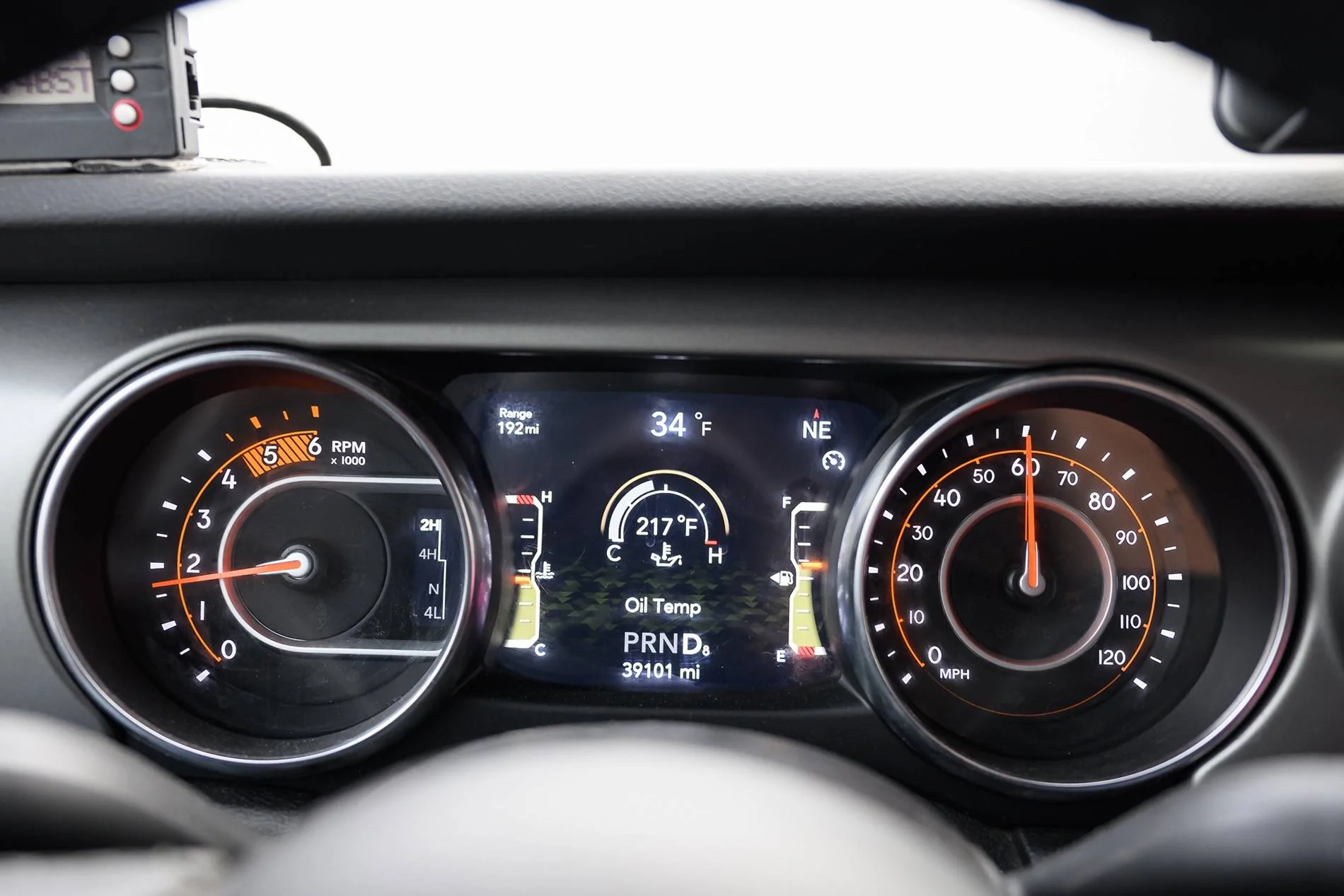

For reference. "37" inch Nitto Recon ATs with 4.10 gears. Been running this combo for a few years and love it. And my Jeep is about 7,000 lbs fully loaded.
Jeep Gladiator Swapping up to the 4.10s 20230212_FortFlagler_WABDR_007
Jeep Gladiator Swapping up to the 4.10s 20230212_FortFlagler_WABDR_005
Jeep Gladiator Swapping up to the 4.10s 20230212_FortFlagler_WABDR_006

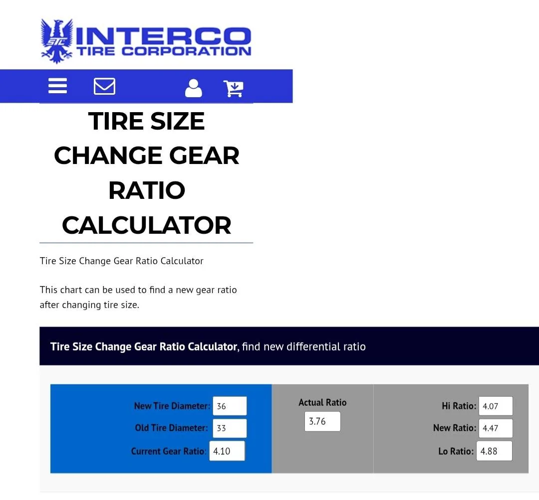

My advice, don't do it. I have a JTR with 4:10's and 37's.
A gasser with oem 4.10s going from oem 33s up to a 37s (36ish actual measured height) would need a 4.56 Ratio to get back close to oem power band.
I understand your disappointment of the performance with 37s on the oem 4.10 with the 3.6 gas motor.
Your effective ratio with a measured 36" tire and 4.10s actually dropped to 3.76 and a new 4.47 would bring that back to spec. The 4.56 is the closest.
I have done the algebra, checked multiple online Calculators and Gear Swap Charts.
For what ratios are offered by Spicer, the 4.10 ratio is what my truck needs.
Thanks for trying to help.

"TheSolarWizard, post: 1520303, member: 23291"]
there's a lot of weird stuff going on in this thread for seemingly zero reason
Two things you're missing here.
One
My 38s actually measured at 37 on the ground.
Rubicon oem 285 tire is 33". I measured mine at new at 300 miles when I went to 35s
Using 37 , 33 and the Diesel 3.73 for the math , the answer is 4.10.
Two
Running oem spec rpms doesn't increase EGT.
Running a higher 4.56 gear at the same speed will raise the RPMs and EGT.
