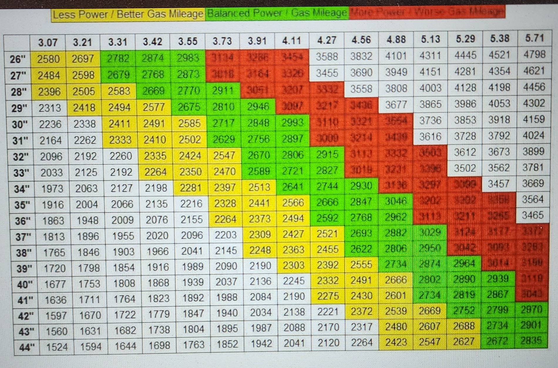

Curious, how do you figure 4.10s will get better MPG than 4.56s? I'm currently trying to decide which as well and while we obviously can't be too nit picky about mpg when we bought a jeep, I'd still like the find the "best" mpg ratio. The thing I found while living in Utahs mountainous areas is that my stock 33s Avg. Me about 22 to 23ish, my 37s put me at around 20, and a set of second hand sport 31s for daily driving put me at 25ish. So, if I was chasing the 25ish the 31s gave, your calculator says I need closer to 4.56 when entering 31s as the old tire. Wouldn't that be mostly true across the board? I wonder why others don't like 4.56s when that's what I would say is closer to a diesel sport ratio, while 4.10s are like a diesel Rubicon ratio (sort of).

The charts are the same…
That is exactly the point. The chart is the same for any engine or transmission.
I will try again.... I want you all to see it. It is not that hard.
You want to know the RP gear needed for a bigger tire size. That is what the chart does. It is not about RPM, or engine type, or transmission. It handles all. It is about final drive ratio which is what you need to upsize tires.
Put in your stock tire size and stock Ring and Pinion. It shows you a number in the center of the chart. Call it 'X''. Write it down. It doesn't matter if it's 2300 or 4500. Write it down. As I said, call it X.
Then, put in your new bigger tire size on one column, and try to match the X number that you wrote down and find your R&P in the top row.

2022 JTRD
Stock Tire = 33
Stock Gear = 3.73
RPM on Chart = 2470
And
New Tire = 37
New Gear = 4.11 ( 4.10 )
RPM on Chart = 2427
Chart says your suggested 4.56 Ratio puts the RPMs at 2693.
4.10 with measured 37" tire drops 43 RPMs below oem spec.
4.56 with same tire increases RPMs by 266 at the same speed.
Running 43 RPMs below spec is not going to lug the engine and the actual tire size will shrink up to an inch with wear bringing the -43 rpms right back to baseline.
Increasing RPMs raises fuel consumption and wear on the engine in an apples to apples traveled distance.
Even someone "who fell out of a stupid tree"
can see which one ( 4.10 ) is closer to the oem spec.
Same results across multiple Tire/Gear Calculators confirm 4.10 is the closest to oem spec.
I have no doubts 4.10 is the best option.
40s on a 4.56 = 2491 RPMs only 21 over spec
I may not be a smart man, but gearing for a 40" when running a 37" wouldn't make me smarter...

Yes. Finally sense arrives from others. Thank you!
It is not about RPM, it is about final drive ratio. FINAL DRIVE RATIO. Tire size to ring and pinion needs.
You want to match as close to stock final dive ratio..... unless...
Unless you want your engine to spin faster or slower for economy or power at the low end.
Be well. Jeep on.

Overland EcoDiesel comes with 255 = 32" tire and 3.73 gears
I'm guessing the 37s you're running measure closer to 36, very few manufacturers stated size is an actual measurement.
Using those numbers, going to a 4.10 like you did , dropped you 53 RPMs below oem baseline, which probably gave you a little better mpg at highway cruise speeds and offset the loss caused by the new wider and heavier 37.
Be well. Jeep on.
If you want to keep the same final drive ratio, tire change percentage = gear ratio change percentage.
It's so simple you don't need a chart.

Pulled the trigger today and ordered the Spicer 4.10s from the gasser and Master Install kits.
Don't want to lose the top end highway mpgs that would come from upping to the 4.56s.
Since adding the Mopar 2" lift and going up to Nitto Ridge Grappler 38x11.50r17 last Saturday, I have felt the need to bring the power band back closer to oem spec.
The actual 37" tire on the truck dropped the ratio to 3.3 and effected what I feel is unacceptable fuel consumption at launch from stop.
I ran Nitto Trail Grappler 35x12.5x17 for the last 3 years and felt the 3.73 ( 3.55 due to 35" tire size ) was adequate since I don't tow and live in Flat Earth Florida
Tire Size Gear Calculator sez 4.22 to get back to oem spec, so it will end up being. 12 underdriven with 4.10s.
That small amount of underdrive should be acceptable at launch and give a fraction better highway mpgs.
