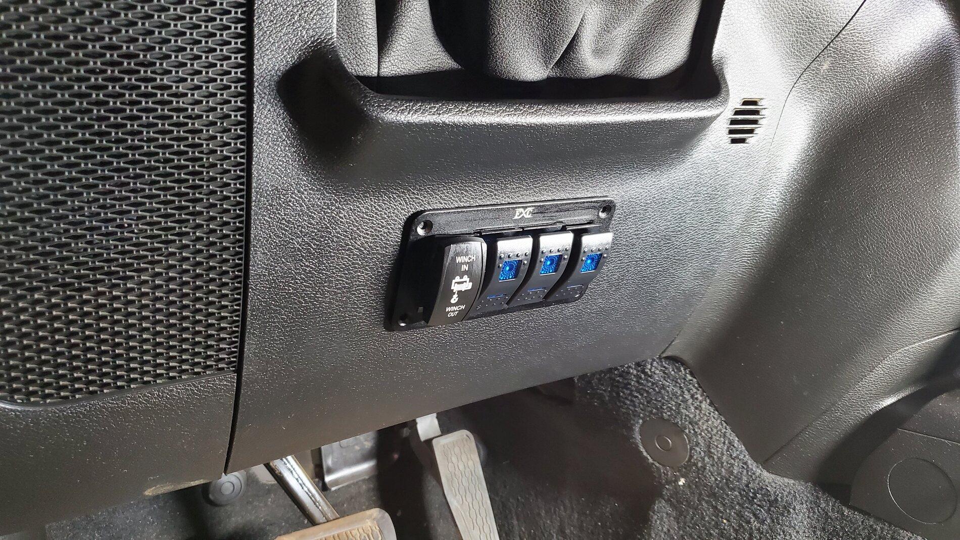

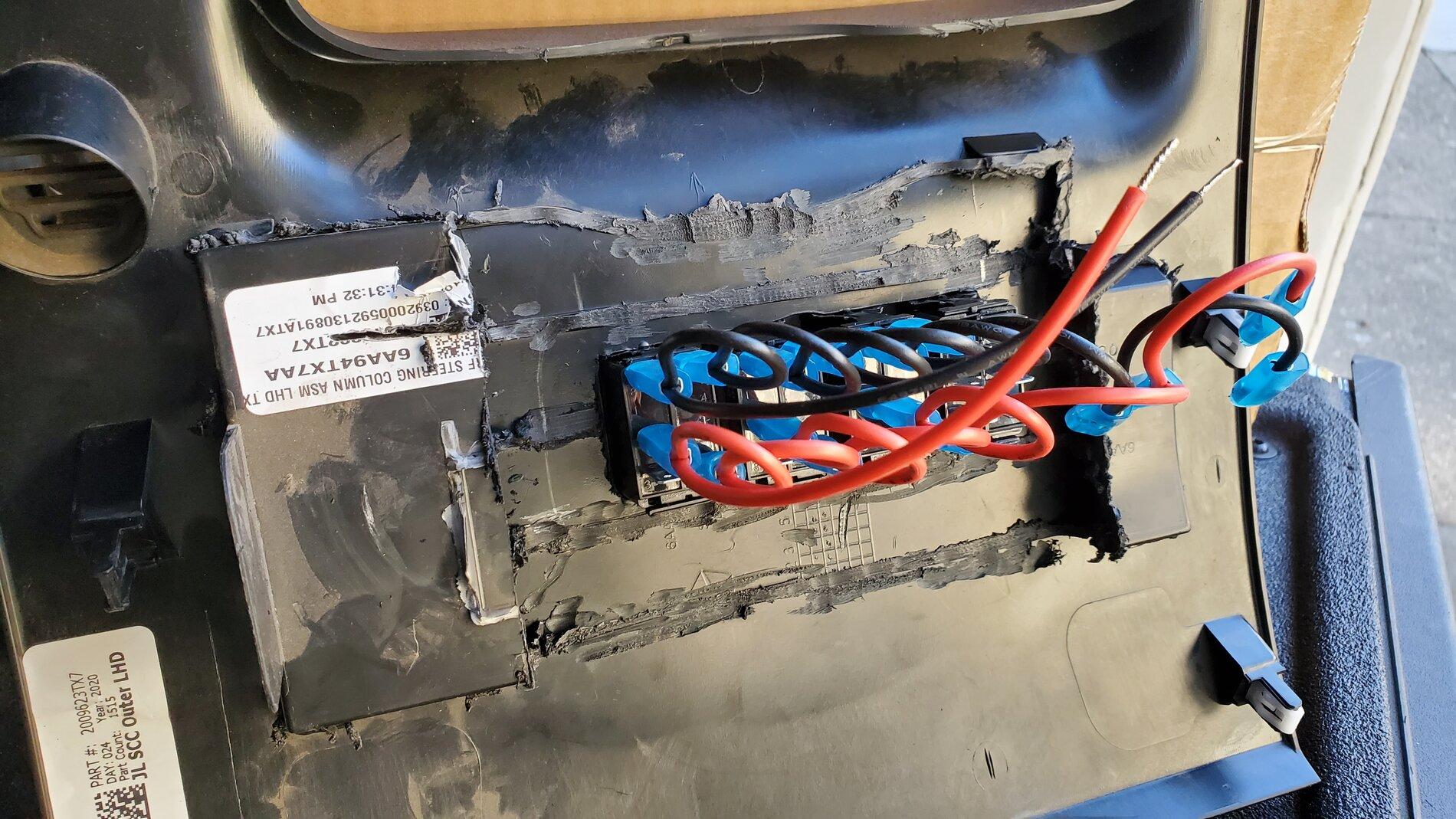

This is what I did because I needed more switches then the 4 factory switches.
Mounted an extra 4 switches under the steering wheel. One is a winch control so I don't need to take out the remote, one is for driving lights, fog lights, and gmrs power.
How much cutting/drilling did you have to do?
