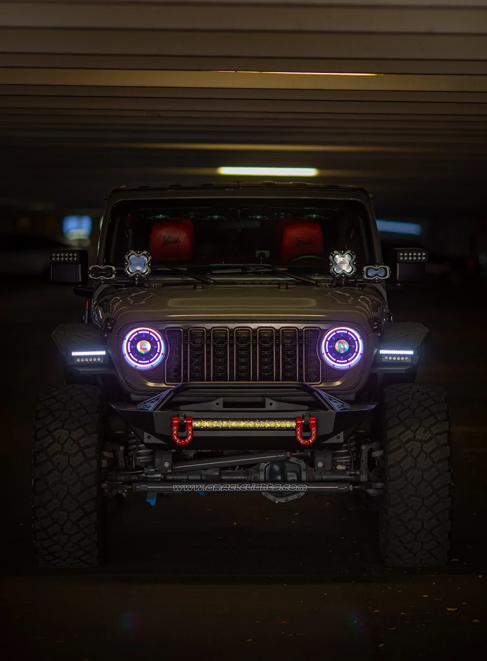

Mirror lights are definitely a solid option if that's the direction you're leaning. One of the biggest pieces of feedback we hear from Gladiator owners is that they like keeping the A-pillars clean while still getting useful peripheral lighting, or the versatility to have A-Pillars aimed to enhance with even more lighting! If you have any questions, we're happy to help! Forum members can also use code GLADIATOR10 to save some $$ at checkout.

Mirror lights look super cool but mirrors get broken on the trail a lot. If there was a product that replaced the mirror MOuNT and had some kind of LED lighting in it I’d consider mirror lights. (Like an Amber 3 strip LED that goes out at an angle slightly to the front and out to the side. :like: ) One of my favorite shorter trails is named “Broken Mirror” for a reason…..
