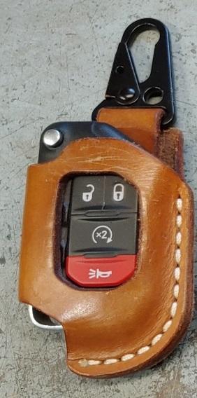

Fob never leave my pocket - for that matter, it never goes into my pocket or leaves my side.
Passive entry, don't even have to touch fob.
Jeep Gladiator Tazer - Disable Feature that turns in reverse lights? fob-holster
