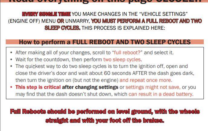

I have a 2024 Mojave with a Taser. Newly installed several months ago.
I’m still learning it…. One time, early-on… it didn’t remember my start/stop was ON. Then… at some point, the Kill3Honk was OFF when It was supposed to be on.
At that point, I removed it and did a firmware update (it was running the same version, but I ran the update anyway) and did the whole reboot & sleep cycles.
It’s been fine ever since….. Knock on wood.
I’ve made LIVE setting changes - without doing the sleep cycles (you shouldn’t need to on LIVE settings). But that’s about all I’ve messed with.
