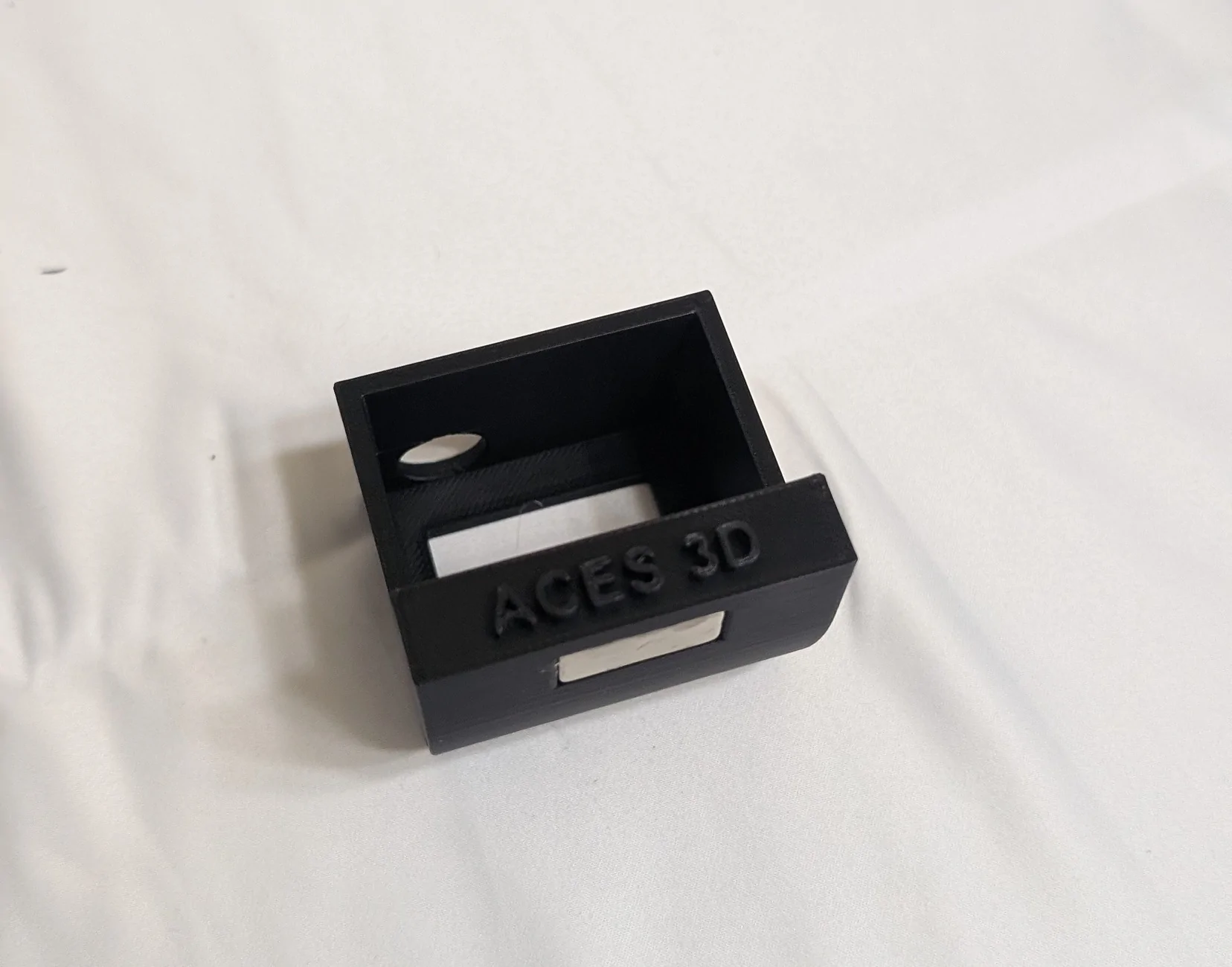

I made a 3D printed magnetic holder to mount the tazer in under the dash, kept it from 'hanging' around on the cables -
Jeep Gladiator TAZER installation.... Loosing mind.... PXL_20260309_153730393
