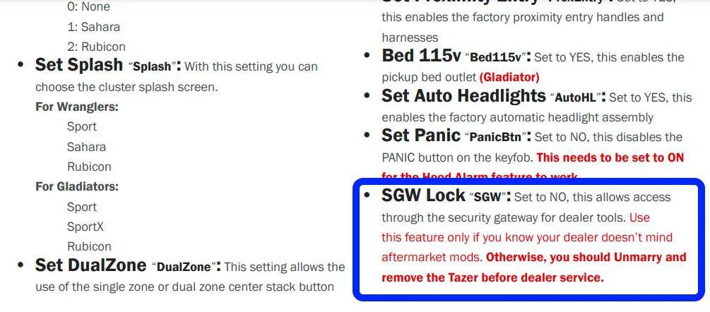

Always unmarry the Tazer JL before any dealership visit... also remove the Tazer JL and be sure to you reconnect the Security Gateway...
Yes, even if you are just bringing the vehicle in for an oil change, etc..
If you leave the Tazer JL married and drop the vehicle off at the dealership ..... and if the Tech there uses the wiTECH 2 to perform a PCM reflash to incorporate a Stellantis recommended software update(s), the wiTECH 2 will overwrite everything the Tazer JL had set previously.
Yes, even when dropped off for just an oil change, very often a Tech will hook up the vehicle to the wiTECH 2.... especially if the dealership work load is light and the Tech is looking for $/for work.
-->But an even bigger issue... is that when you do your next Tazer JL, unmarry in the future.... your JT/JL would/could lose whatever new update(s) done the last time at the dealership.....and all would be returned back to the original settings. This being done can cause big issues to include leaving the JT/JL, unusable. To get things corrected would not be covered under factory warranty.

And REALLY doing your homework would tell you that the firmware doesn't know if Tazer, Jscan, AlfaOBD or wiTECH made the parameter changes, so if an update is going to overwrite settings the vehicle owner made, it's going to be the same if it was done by a Tazer or Jscan, or AlfaOBD.
Tazer added this years ago. Digitally, there is no reason to remove it. The only reason is if you have a dealer who would void a warranty because of it. And that's the same dealer that would void it for your tires and lift anyway.

Or if you feel you need to remove the Tazer, just don't unmarry it, and it will retain the non-live functions like tire size, same as if it was programmed with Jscan.
Unmarrying it is more a cover your @ss thing for Tazer; if you would not revert any changes you made with Jscan or AlfaOBD before going to the dealer, then there is no reason to unmarry the Tazer for a dealer visit.
The changes made with Jscan and AlfaOBD are options in the computer that are designed to be changed. The connection is only long enough to make the changes, and they are not things that you would revert before going to the dealer.
The Tazer is meant to stay connected and rides on the bus to be able to override the computer for the 'live' features. It can also make the changes that Jscan and AlfaOBD make.
A problem with the Tazer is removing it while leaving it married. This keeps the changes to the computer in place, but if the dealer does a computer update access to the Tazer can be lost and assistance from ZAutomotive is required to get it working again.
The Tazer is great, for what it does, but not something I would ever buy. In six years of JT ownership, I have not yet found a need for anything it offers.

Just an FYI….for ya’ll who live in a state with yearly inspections & emissions testing.
I learned……when you reboot (and/or unmarry) the Tazer, it resets/removes all the emissions data.
I took the Tazer out (unmarry, reboot, etc) the night before I took it to the dealer for inspection & emissions. They couldn’t perform the emissions test cuz the data was reset when I rebooted the Tazer. I had to re-schedule and go back 2 weeks later - while driving it to create ‘drive cycles’ to gather emissions data.
For next year…..I’ll probably talk to a local mechanic for inspections. From what I understand, I could leave the Tazer in place for the inspection.

Do take a minute to read through this thread... You'd be surprised how many guys/gals use the ZAutomotive security gateway extension incorrectly..
https://www.jlwranglerforums.com/forum/threads/➿-security-gateway-extension-cable-use-explained-➿.111159/
Oh ..... Just unmarry, remove the Tazer JL and reconnect the security gateway.
IF your JT were to then go into low range, your JT would simply get an EVIC message but the JT would not go into limp mode, etc... It is unlike say a JK that would have a real pissy fit if you did this.
Note.. Hopefully, that dealership Tech will not use low range, considering what you are taking the Jeep in for.
DO after you get through this thing.... research on the JL Wrangler forum/my past posts about having what I call a hybrid approach... You have and enjoy the Tazer JL that is terrific and has great features, but you do your gear settings and tire size with JSCAN. This way when you unmarry the Tazer JL, you do not lose your tire size and gear settings..

Well, if you want to enjoy / use a Tazer JL with less bother... you should address certain things..
You use JSCAN for gearing and tire size so you don't have to deal with say bother/issues/headaches when going into the dealership for work that as you know, requires the unmarrying of the Tazer JL on your JT which results in gear and tire settings being undone.
There is no marry with JSCAN as there is with the Tazer JL.
A $25 JSCAN license and an inexpensive JSCAN recommended BT Scan Tool is all you need. You use your unmarried Tazer JL for the security gateway bypass module. I should mention, JSCAN is way way easier to use then doing feature selections with the Tazer JL.
-Hope you read how to properly use the ZAutomotive security gateway extension cable.
