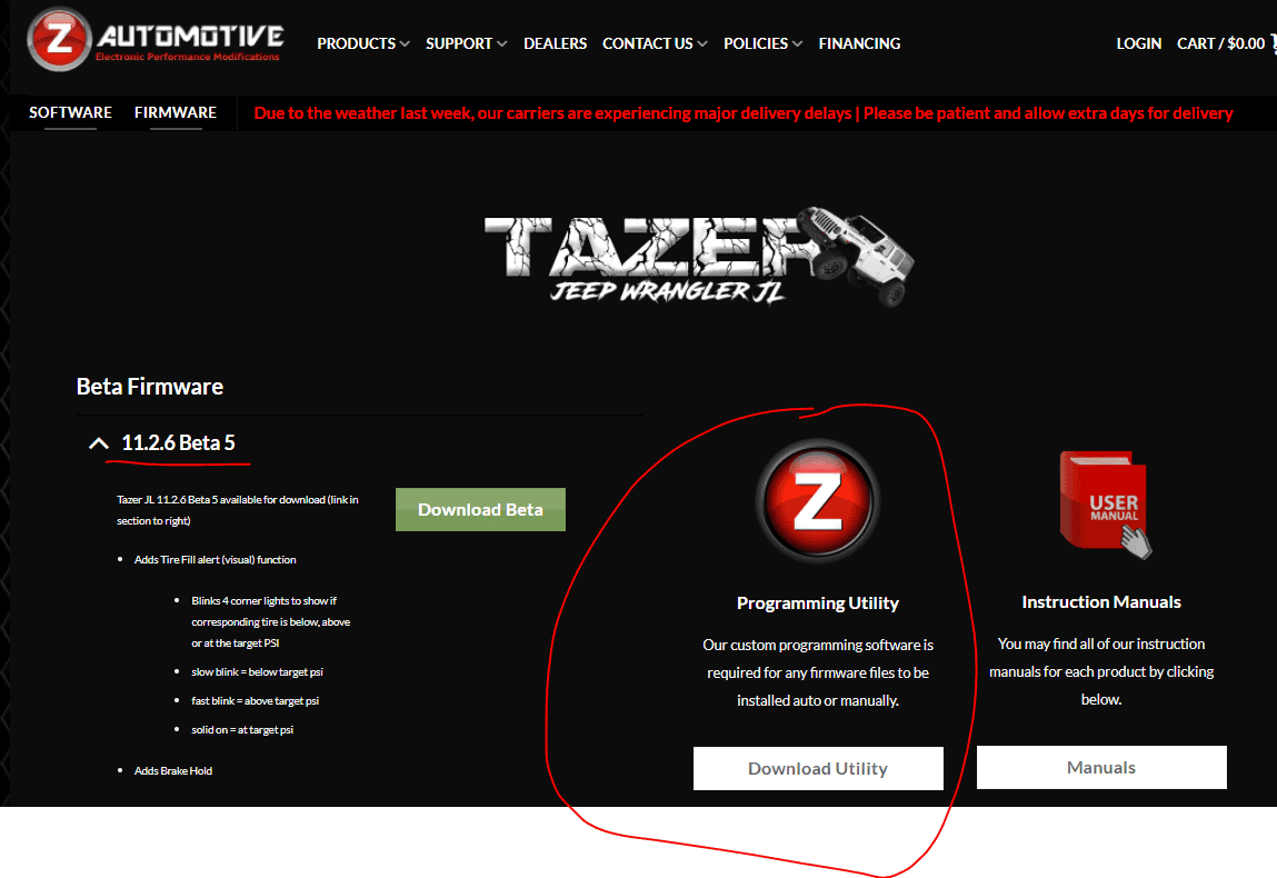

The ZPU utility program you use when working with firmware, will reach out and get the current final release firmware, automatically... NOT so in regard to a/any beta.
To install an available beta ...... Go to ZAutomotive's website and download the desired beta to a folder on your laptop... then point the ZPU utility program (Manual mode) to the Beta and let it load the firmware on to the unmarried Tazer JL.

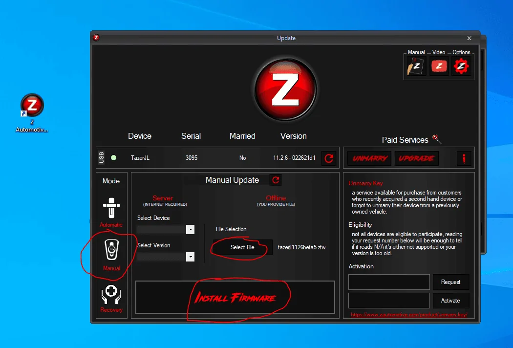

For those of you doing an update for the first time (me included) don't be scared... I unmarried my Tazer just to be on the safe side > I wrote down my settings to re-select them after I marry it back to the JT.
1) Download the Z Programming Utility tool
Jeep Gladiator Tazer JL Mini 11.2.6 Beta 5 Firmware UPDATE!!! 1615160654010
2) Go to "Manual" > Select file > Install Firmware
Jeep Gladiator Tazer JL Mini 11.2.6 Beta 5 Firmware UPDATE!!! 1615160610792
