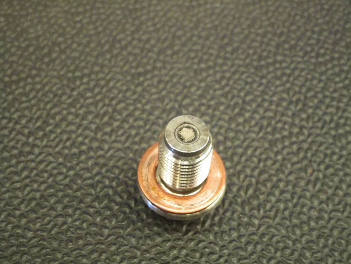

I now have 30k on my 2020 Willys 3.6. Here is a picture of my magnetic drain plug from my last oil change. No metal here.
Jeep Gladiator The 3.6 Tick Bites Trail Recon at 31,000 Miles oil drain plug
I feel like a heavier weight oil might help too with the high temps the 3.6 runs. Dealer advised me to add BG MOA at each change. My tock showed up a month ago at 43k now torn down ata shop waiting on parts

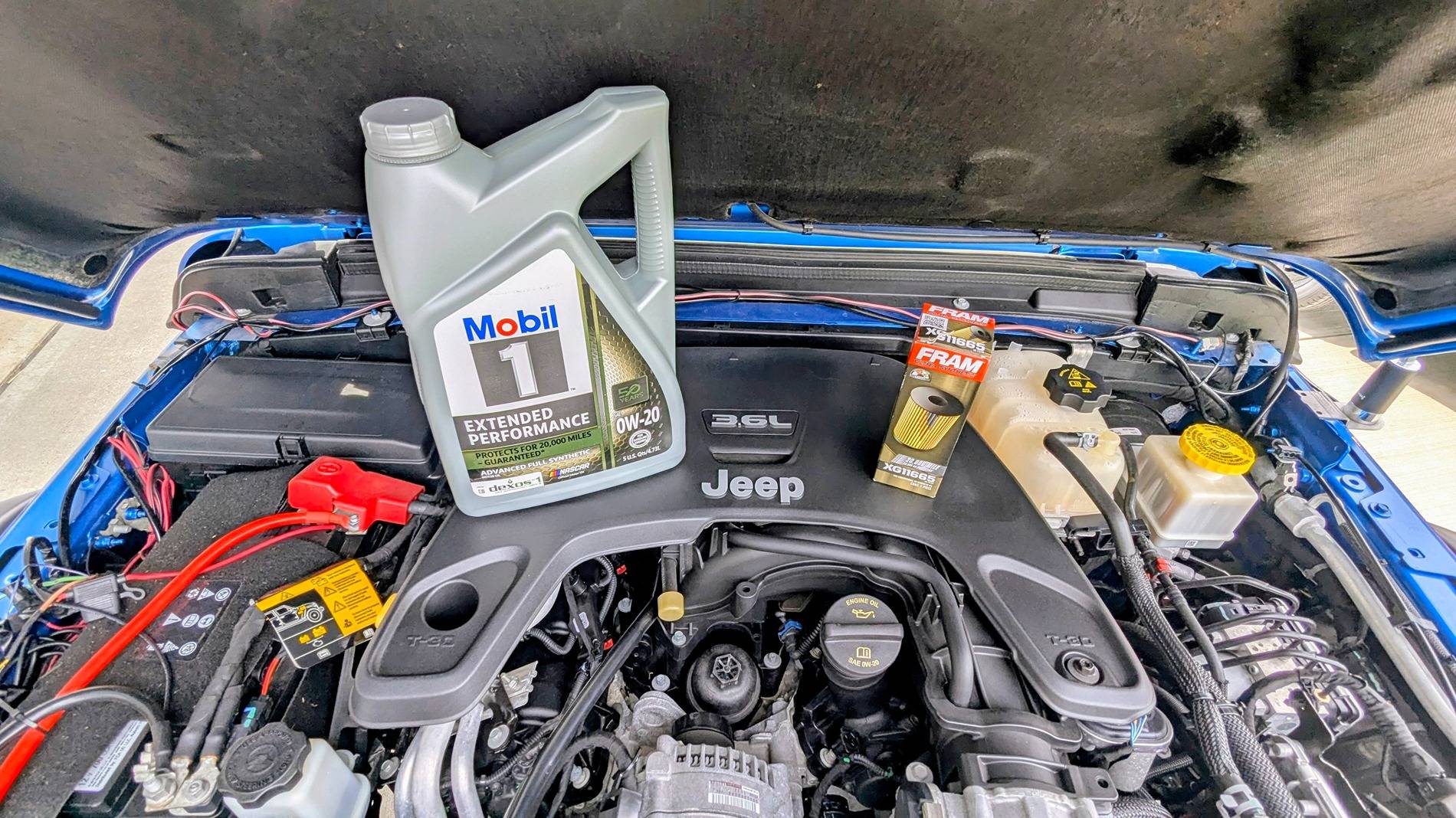

Here´s today´s oil change. I am at 4600 miles on the previous change. I usually do 5k, give or take a few hundred miles.
Jeep Gladiator The 3.6 Tick Bites Trail Recon at 31,000 Miles 94aff753-b319-424c-80b8-e9e70e7ee478~1
