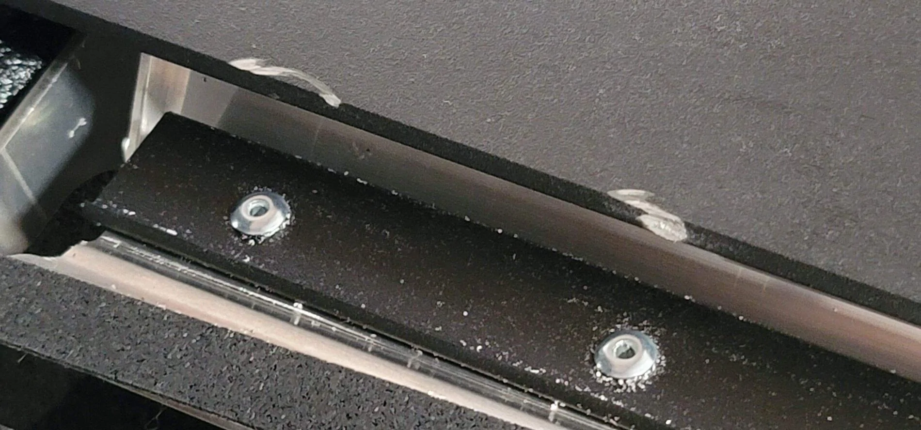

Is anyone else's side rails like this? No black powder coat in the groove? Looks just like overspray
Yes, mine are like that, not sure why they don’t just paint in the groove as it would look better, debating just spraying it myself eventually
Yes, my rails are the same way. Definitely just overspray. However, does not bother me.

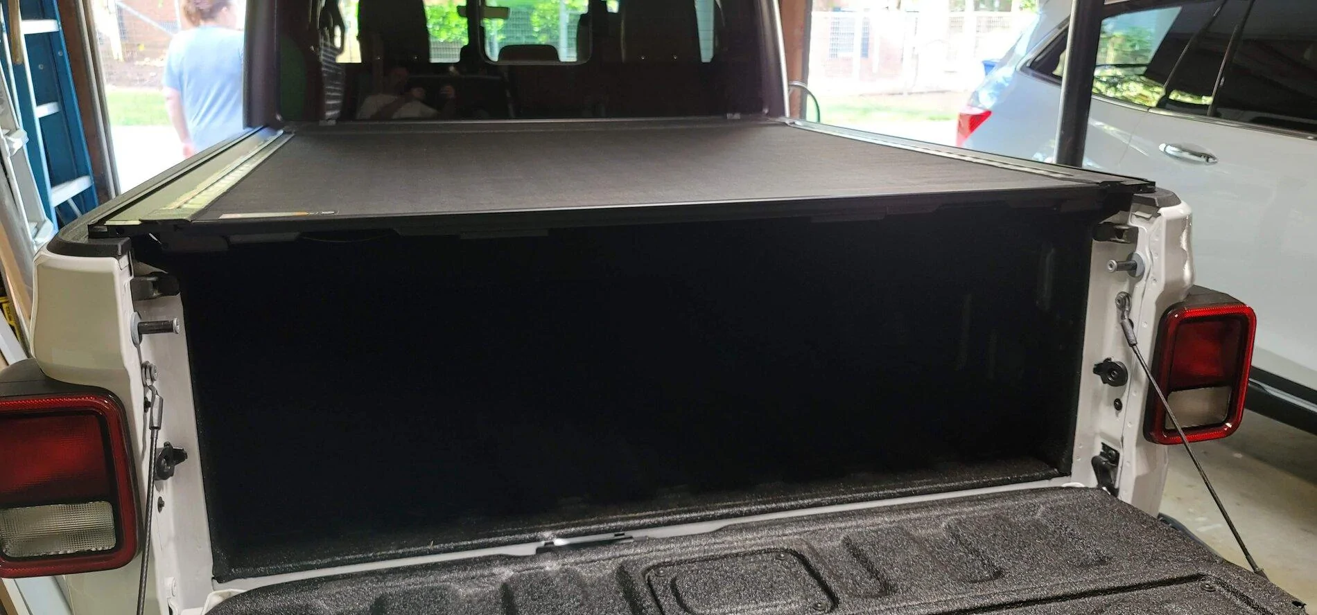

Mine also isn't square along the cab. The passenger side is closer to the cab so it rolls better
Mine isn't square either. The flange seems to overhang the center of the bed, but curve in to each side. With the weatherproof strip not likely to be an issue (I hope).

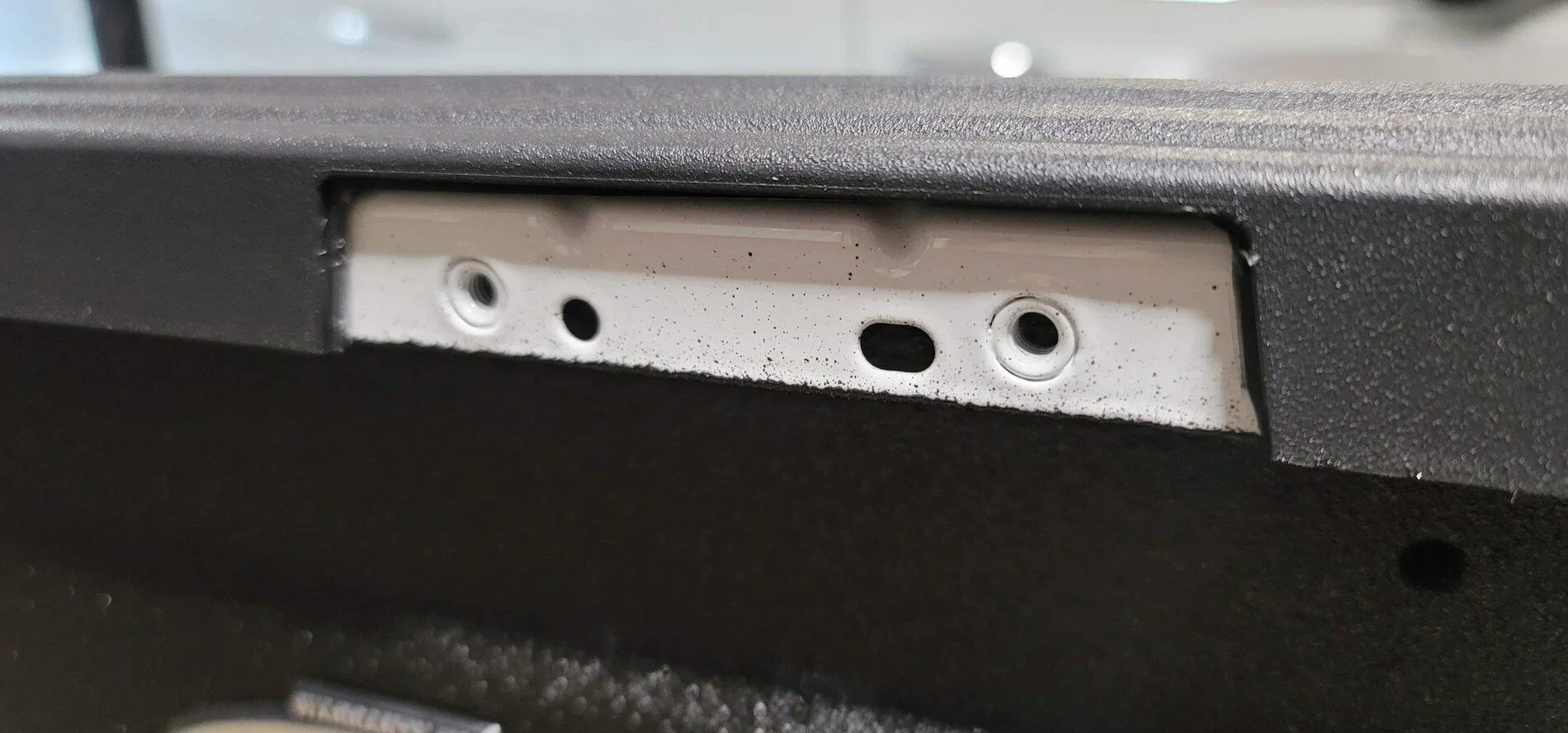

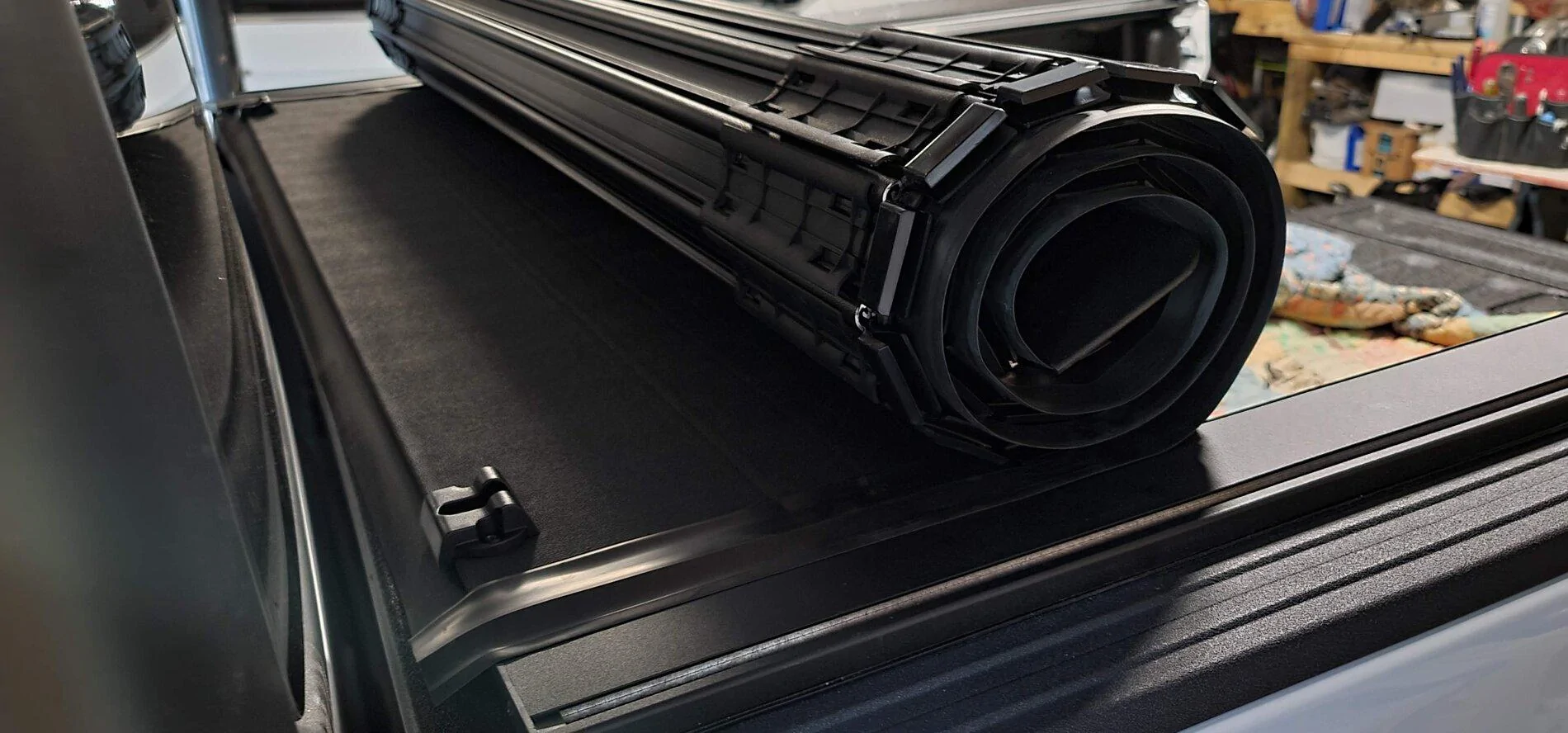

My X4S arrived today. I have some of the same issues as others. Not lying flat near the front, missing washers, damage on the rail with application of the rivets and the cover near the rear keeps popping off which is concerning for water intrusion. I'll see how it settles out.
I went very slow on the install. If I did it again could probably do it by myself in less than an hour. Make sure you try all screws to in the rear connections to clear factory paint, and LineX in the front for me. Having a drill with Torx bits and socket adapters would really expedite the process.

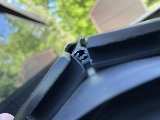

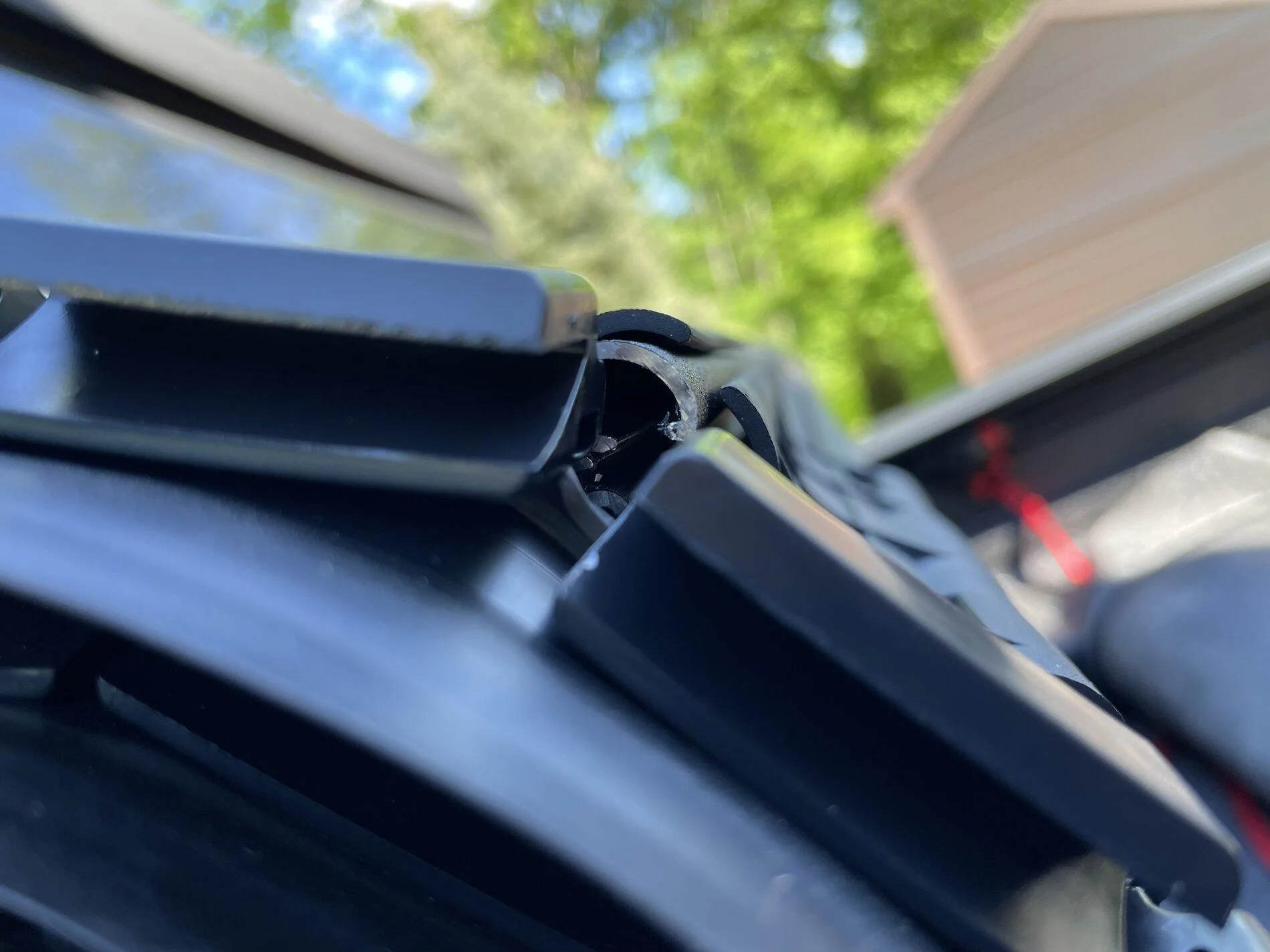

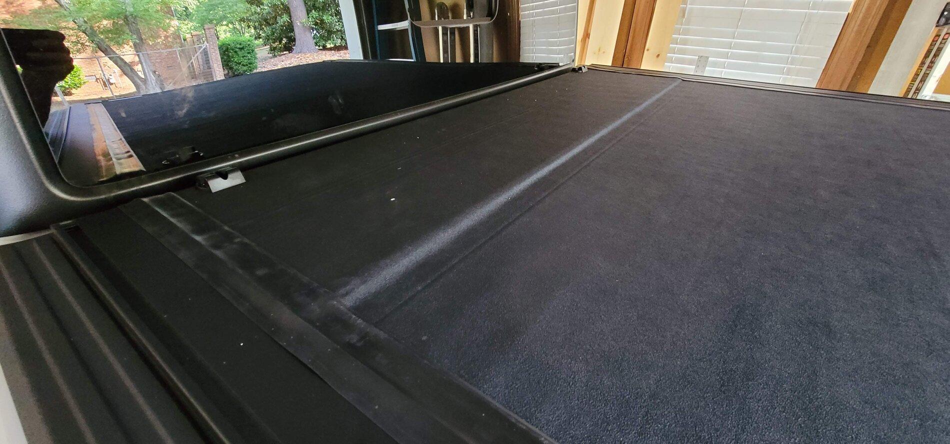

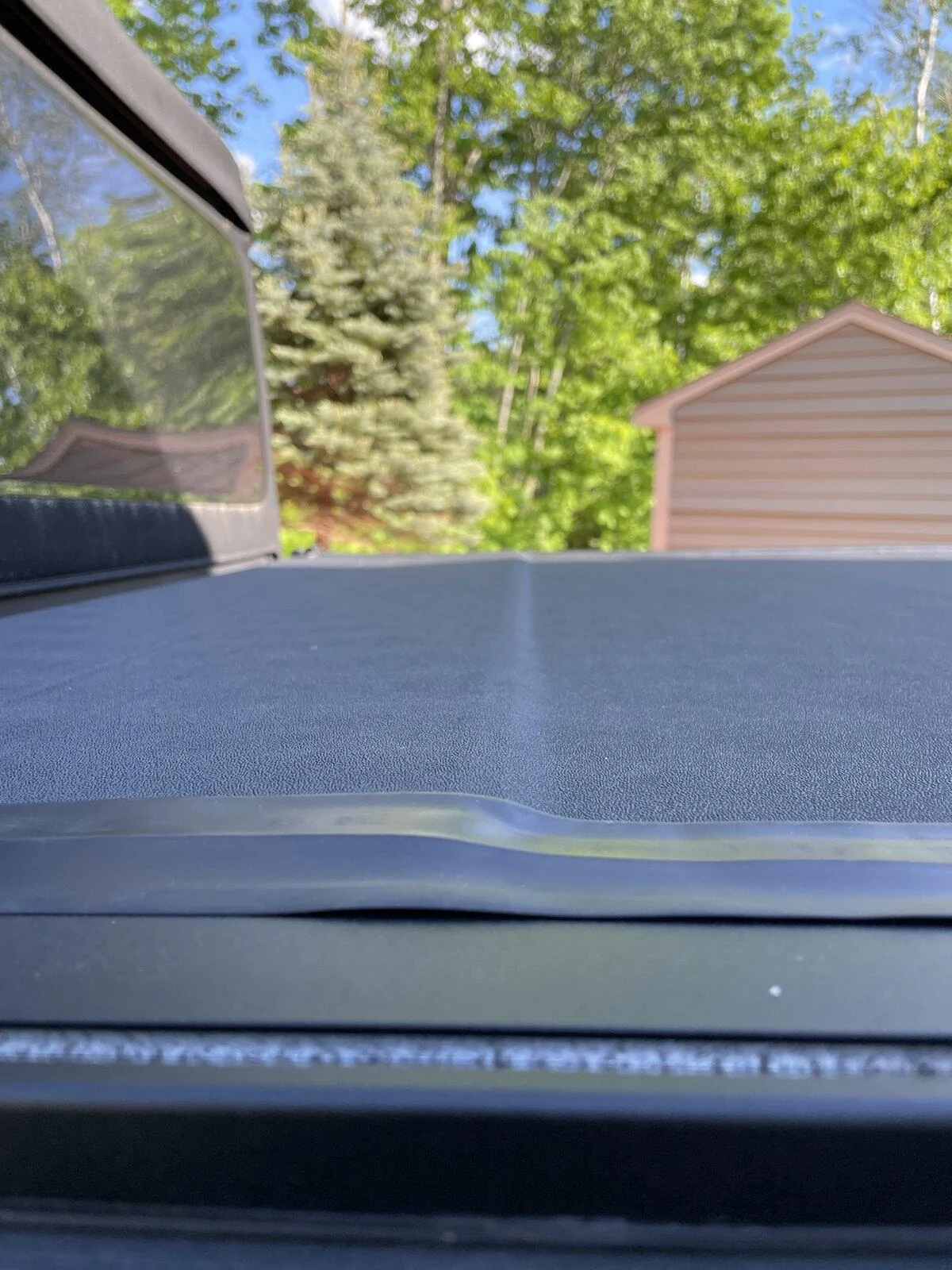

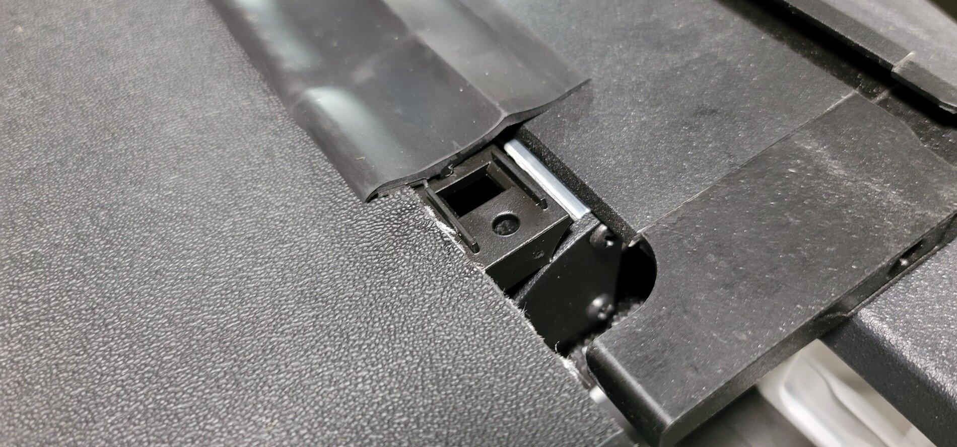

For those that are having “bump” issues it’s going to be a broken top. I got mine today and had a “bump” in it and come the find out there is a piece that’s easily broken during manufacturing. If you inspect the slats while it’s rolled you should be able to easily see it.
this is what it should look like as you unroll it those 2 pieces “mate” which locks it together.
Jeep Gladiator The All New BAK Revolver X4s - Information and Group Buy 14F5EDBA-0F63-42E0-A06D-A7FA5D40245F
you can see in thpicture that the metal “interior” piece is not there so it has nothing to “lock” into which creates the bump.
Jeep Gladiator The All New BAK Revolver X4s - Information and Group Buy D113C8E4-F7AF-4179-85B5-7439104695F0
spoke to manufacturer and they knew exactly what happened as soon as they saw the picture. It’s not something we can repair unfortunately.
This last picture is just the bump when it’s closed.
Jeep Gladiator The All New BAK Revolver X4s - Information and Group Buy 3AF66F0C-EA12-4CE1-950A-0B3D612C7B4B
they will be sending me out a whole new top
