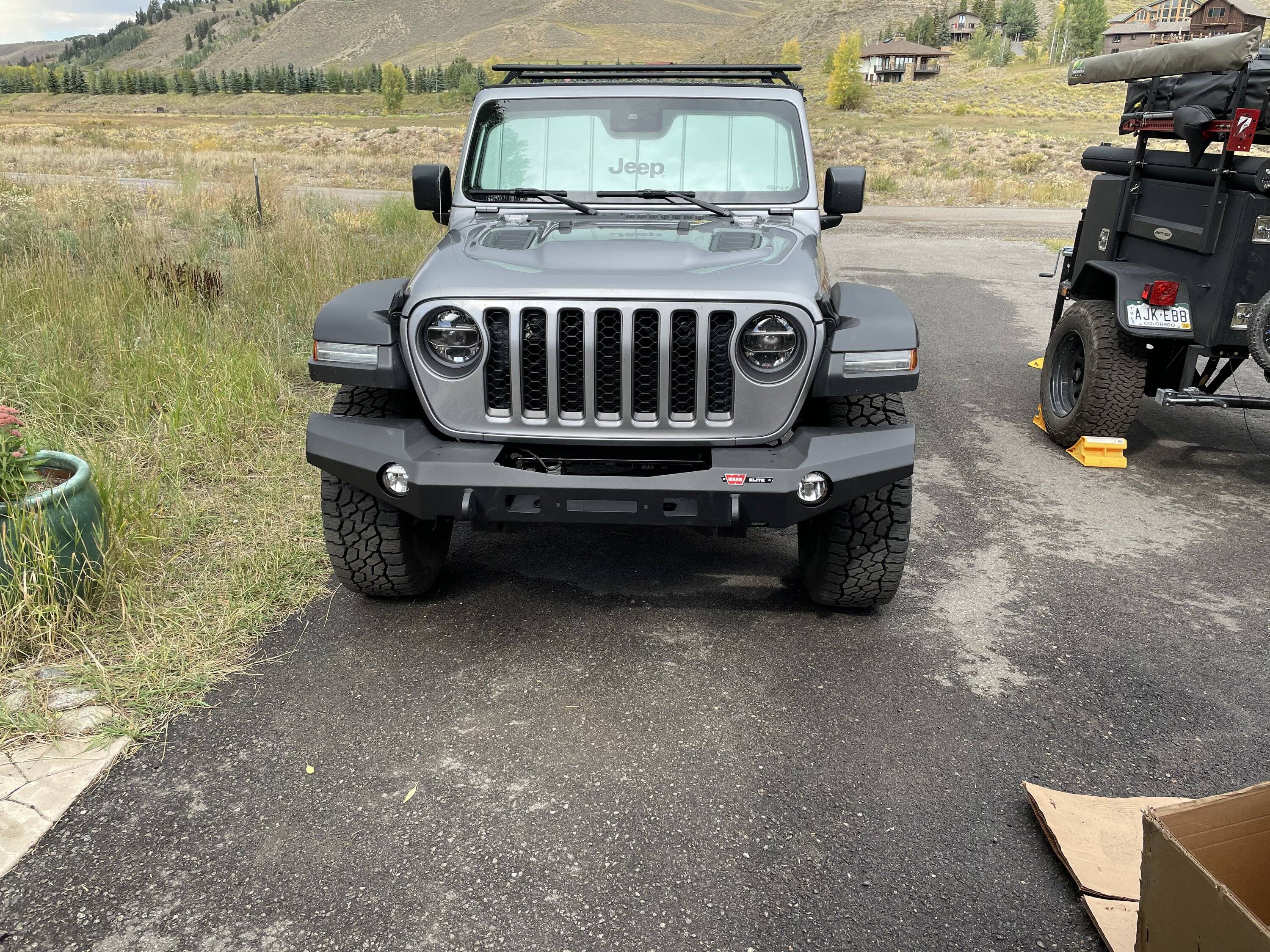

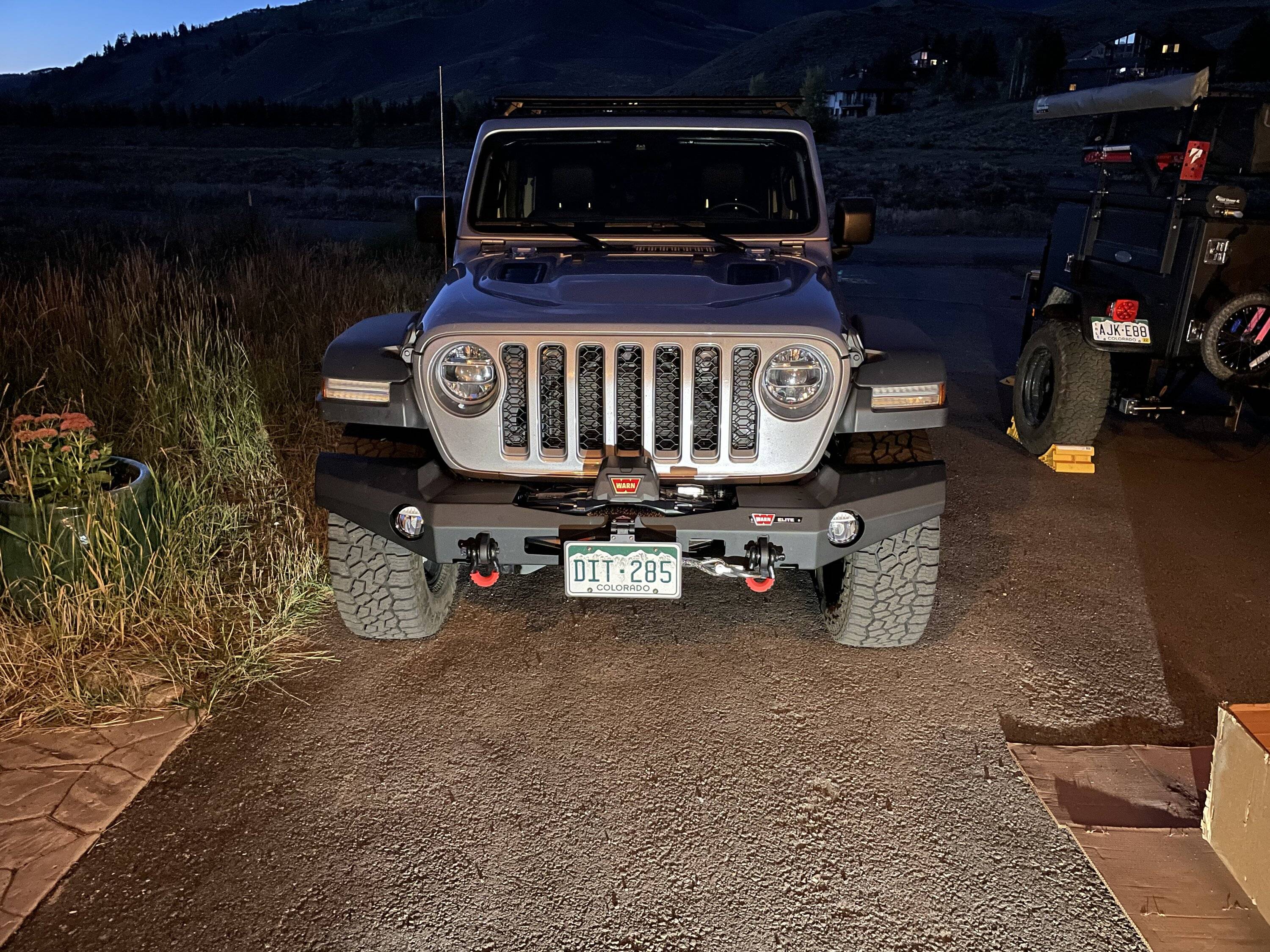

You’re fine. Many people, including me, added steel bumpers and winches well before any lifting. You’ll be fine. Mine is a rubicon as well. I had zero ride quality issues when adding it on a stock rubicon. My bumper at the time was around 80lbs, plus whatever that 12k winch weighed. Enjoy!
This is mine in September of 2021 when I installed the bumper and winch. It’s otherwise bone stock in these pictures.

Love all the full width options, just wish more of them would add an option to meet up with the Rubicon/Mojave fenders. The small gap for some reason really bothers me. Only three full width options I can think of so this, AEV, Rock slide engineering, and ARB Bondi.
Besides that, great look!

The gap never bothered me, but it’s obviously personal preference. For what it’s worth, with 37’s and a 3” lift, it sometimes did touch the tires at full articulation (tire stuffed within 1/2” of fender). Never on the road, or with the stock tires though. I modified mine to fix that. So if you’re planning on 37’s and heavy rock crawling, it might not be the right choice. But ever tire and wheel combo is different, so many might never have that problem.

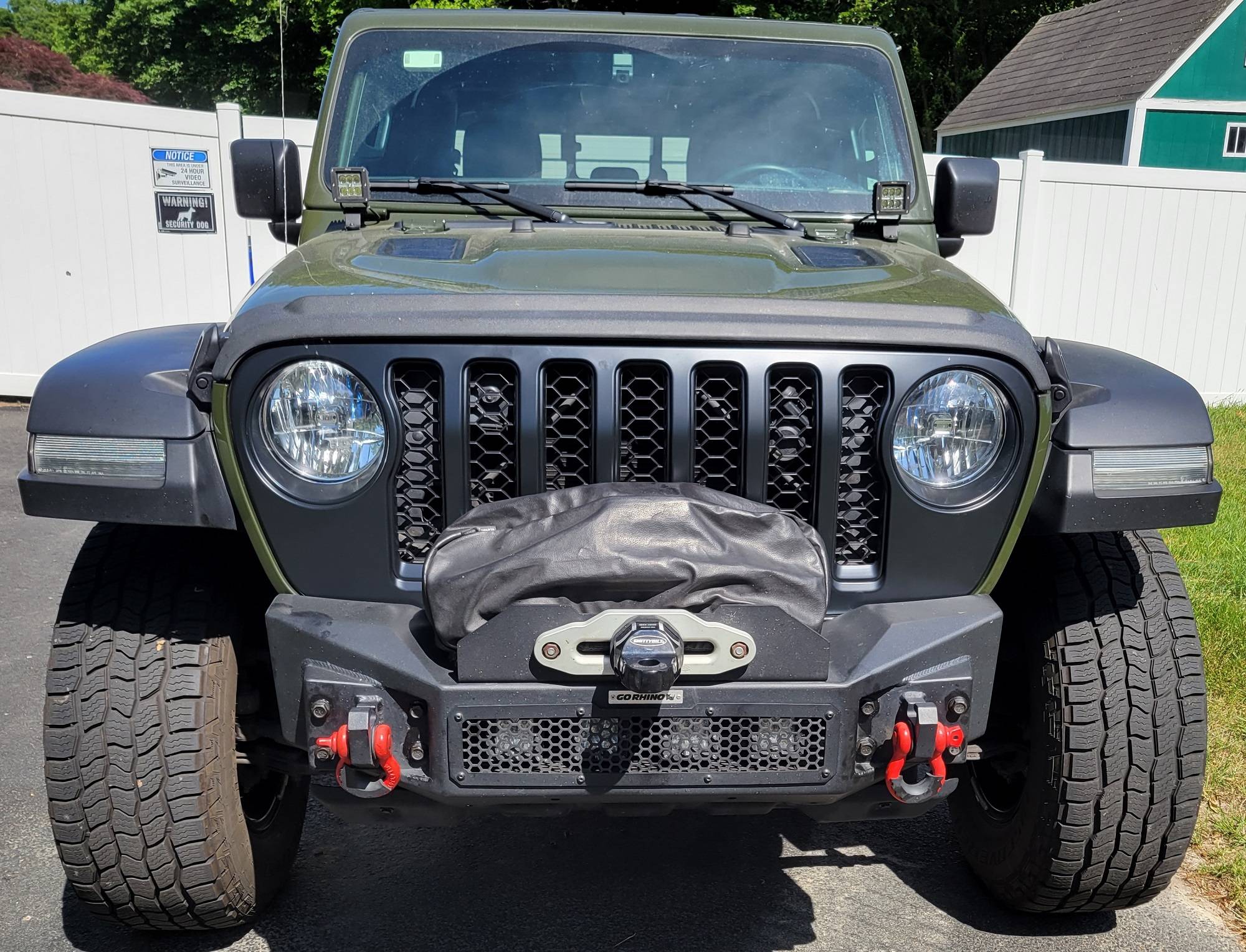

There's a gap there probably because they need the bumper to also fit JTs that don't have the higher fenders (like my Overland). You can see from my photo that the Rubicon fenders would have a larger gap. Bumper is a JCR Vanguard, which I believe they discontinued.

You’re very likely correct.

They 100% did. This was on my list when I first started looking but now they only have the mauler? Love your bumper though
AEV provides options for both fender options which is cool.

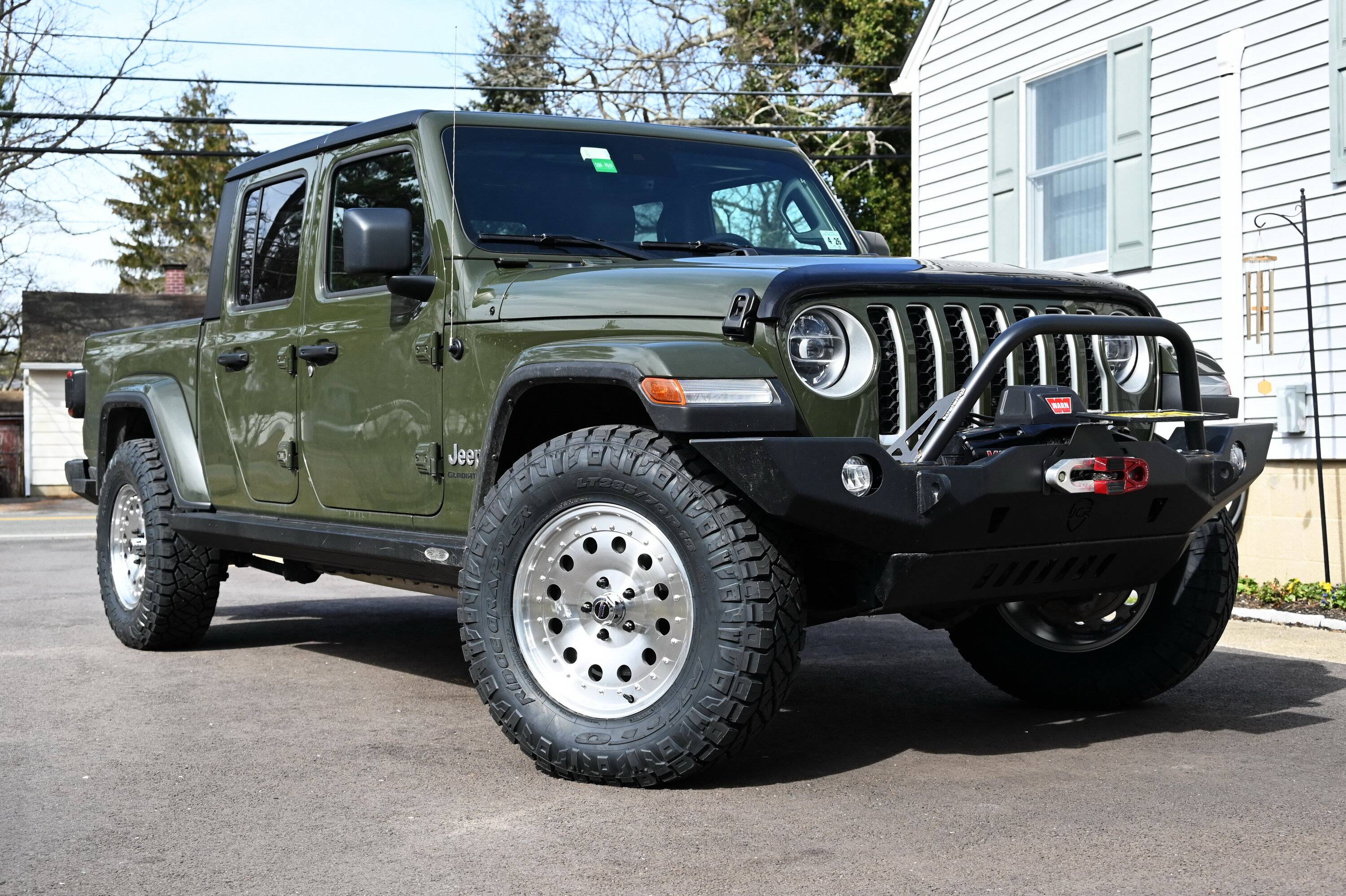

When I installed my Go Rhino stubby, I just used a couple of extra thick washer on the forward Rubicon steel skid mount fasteners to get clearance.
