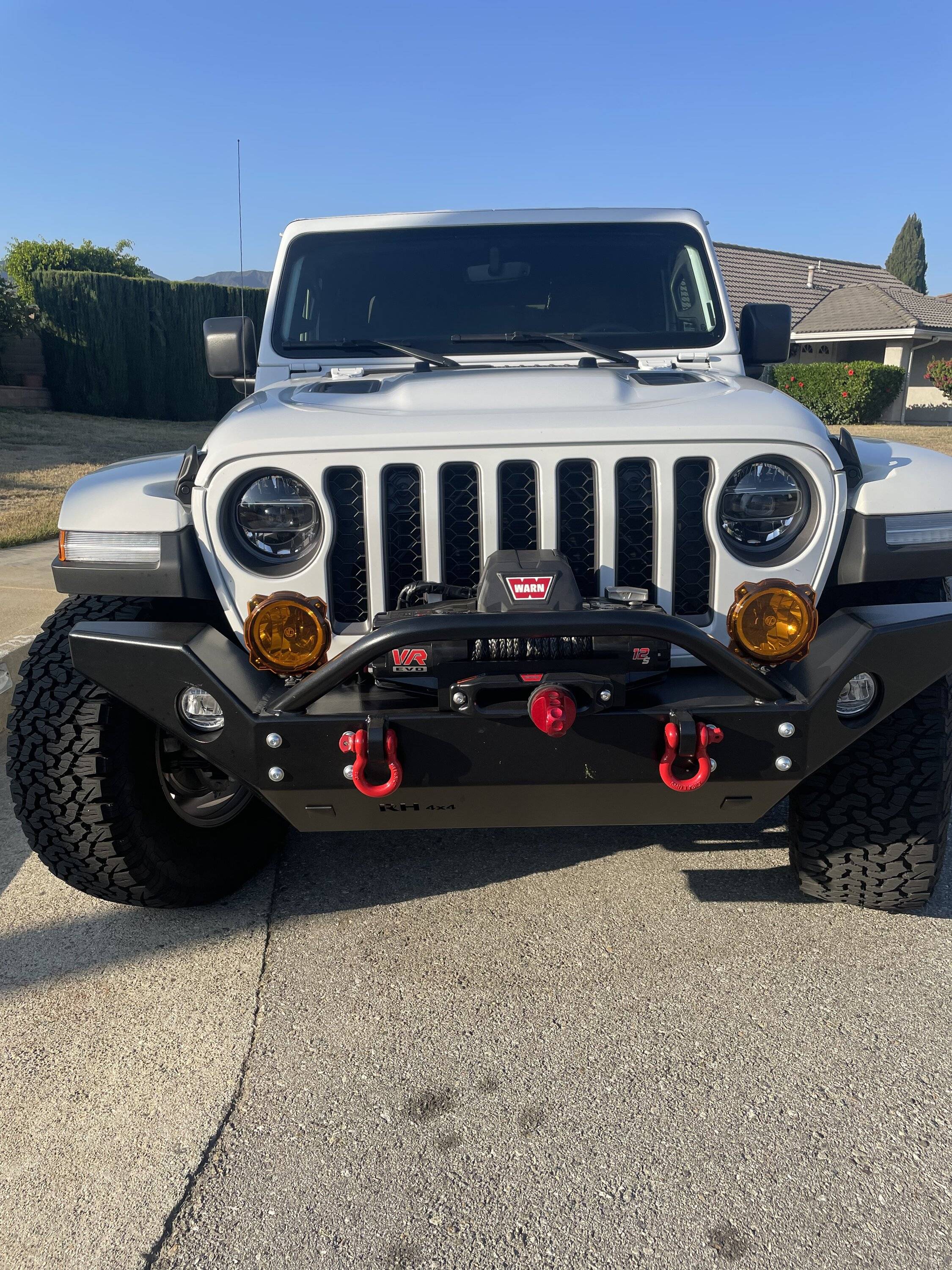

It comes with a skid plate. I used theirs as the original skid plate would need some tweaking to fit.

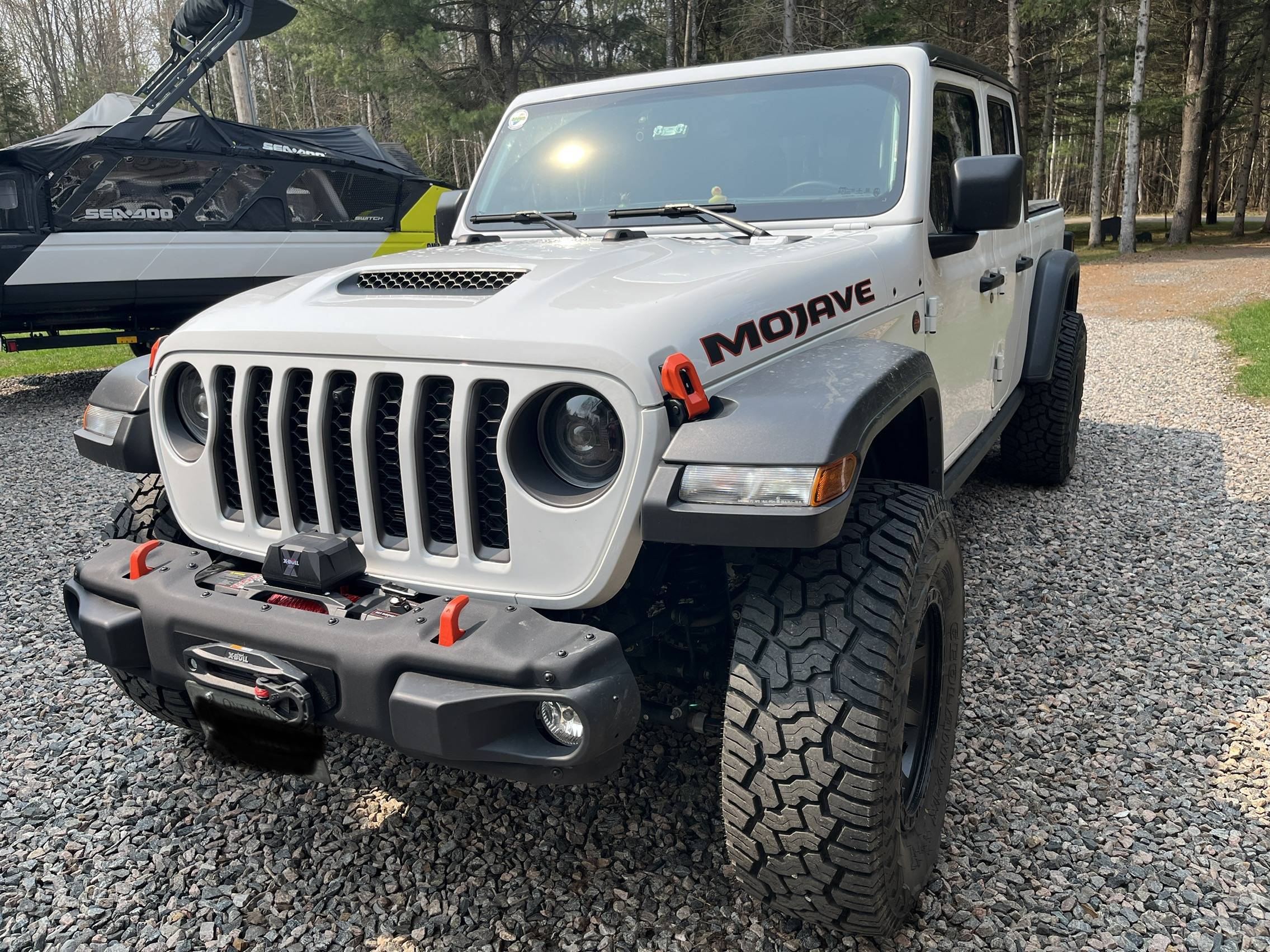

Mentioned above but here it is with a pic. Rock Hard full width 37 lbs.
Any issues installing with the Mojave skid plate for the reservoirs?
If not, I'm going to call Rock Hard and see if they can make me one without the bar
You can’t use the Mojave skid plate. The rock hard bumper has the skid plate built in.

The removable outers weigh 17lbs, the center section only weighs 53lbs. The plastic bumper weighs 32lbs. If I recall the front springs are around 150lbs/in. That 21lb difference spread across the front springs will result in .07" of sag. You definitely couldn't see it with the naked eye, it would be hard to measure with a tape if you moved the jeep at all between bumper swaps. Even with the ends in place you're only looking at .13" of sag.
