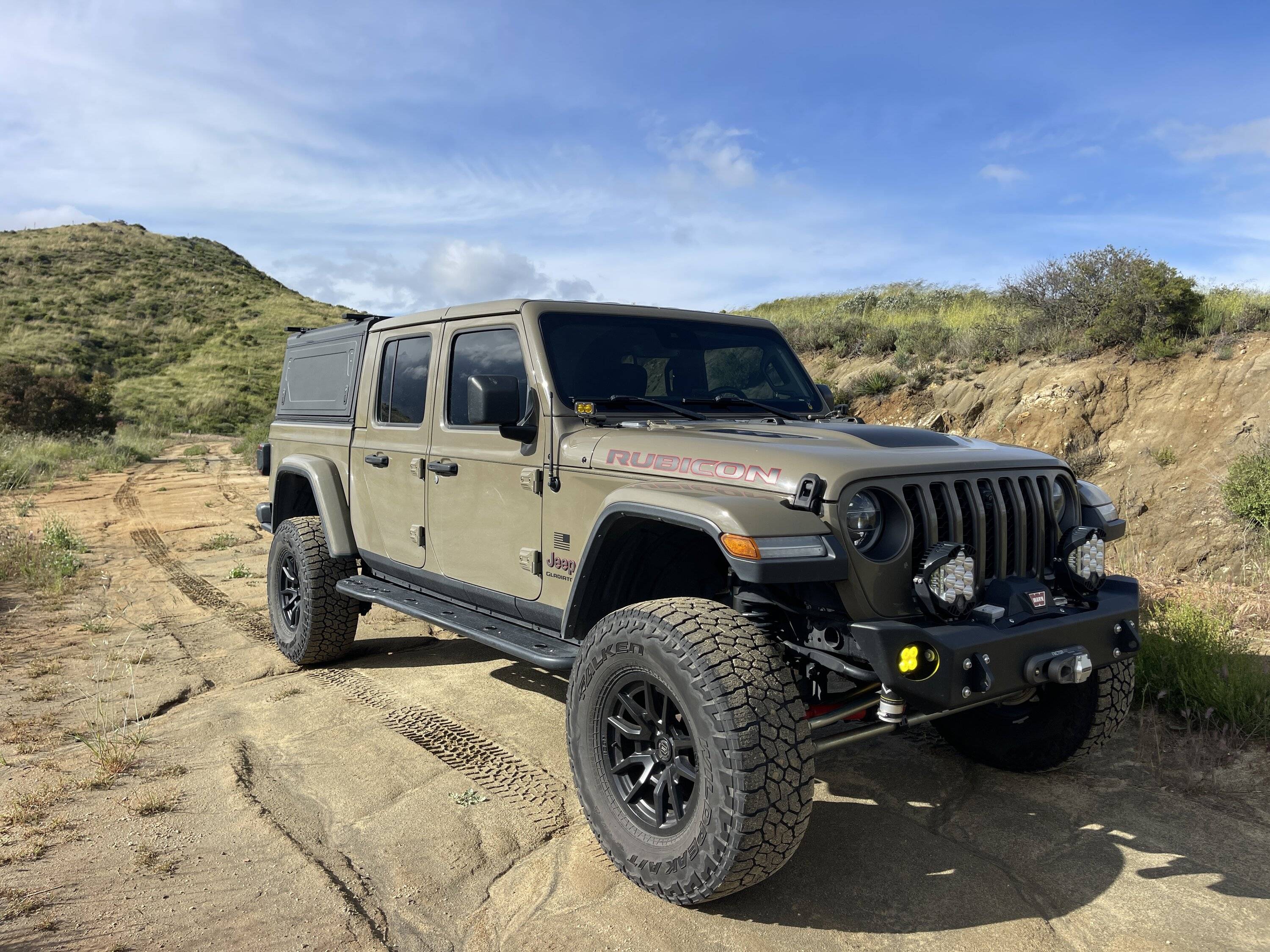

Rock Hard, 37 pounds, flat tow approved. Not cheap, but high quality. It's what I have on my Mojave along with a Warn Evo 8s.
This is exactly what I did but got the Warn 12K. The thing is a work of art.
