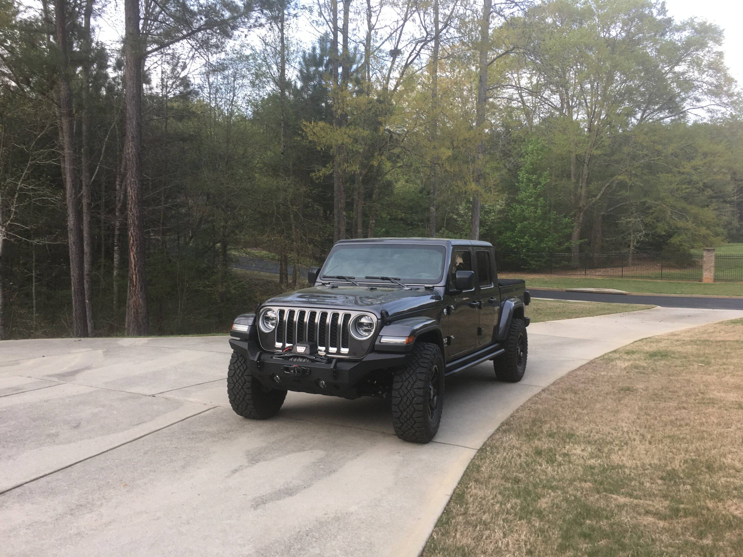

DV8 FBSHTB-17 with Apex Badland 12k winch. I did use the adapter brackets from DV8 for a JK to JL bumper install.
Also, the OEM fog light brackets work perfectly with this bumper. I had Halogen from the factory but replaced with aftermarket LEDs when I bought the Jeep. So halogen fog lights on a JL seem to share the mounting pattern with the JK. I posted a pic of them installed before mounting the bumper.

It will fit. Front bumper is the same. If you don’t use brackets you have to oval out a couple holes on the bumper.
I had to purchase the lights separately

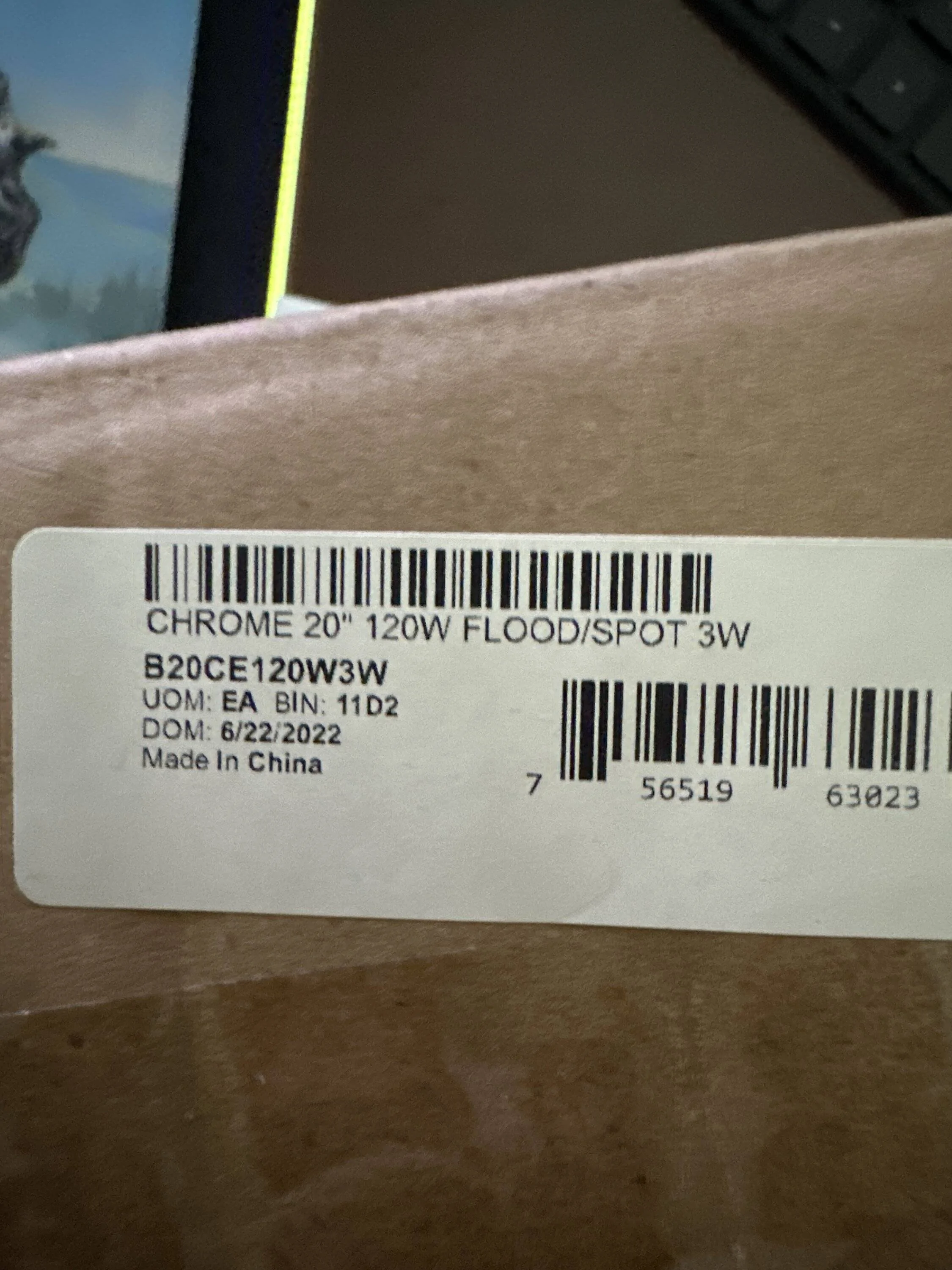

It is the DV8 light bar. Not sure what the complaints are but it has worked well for me.

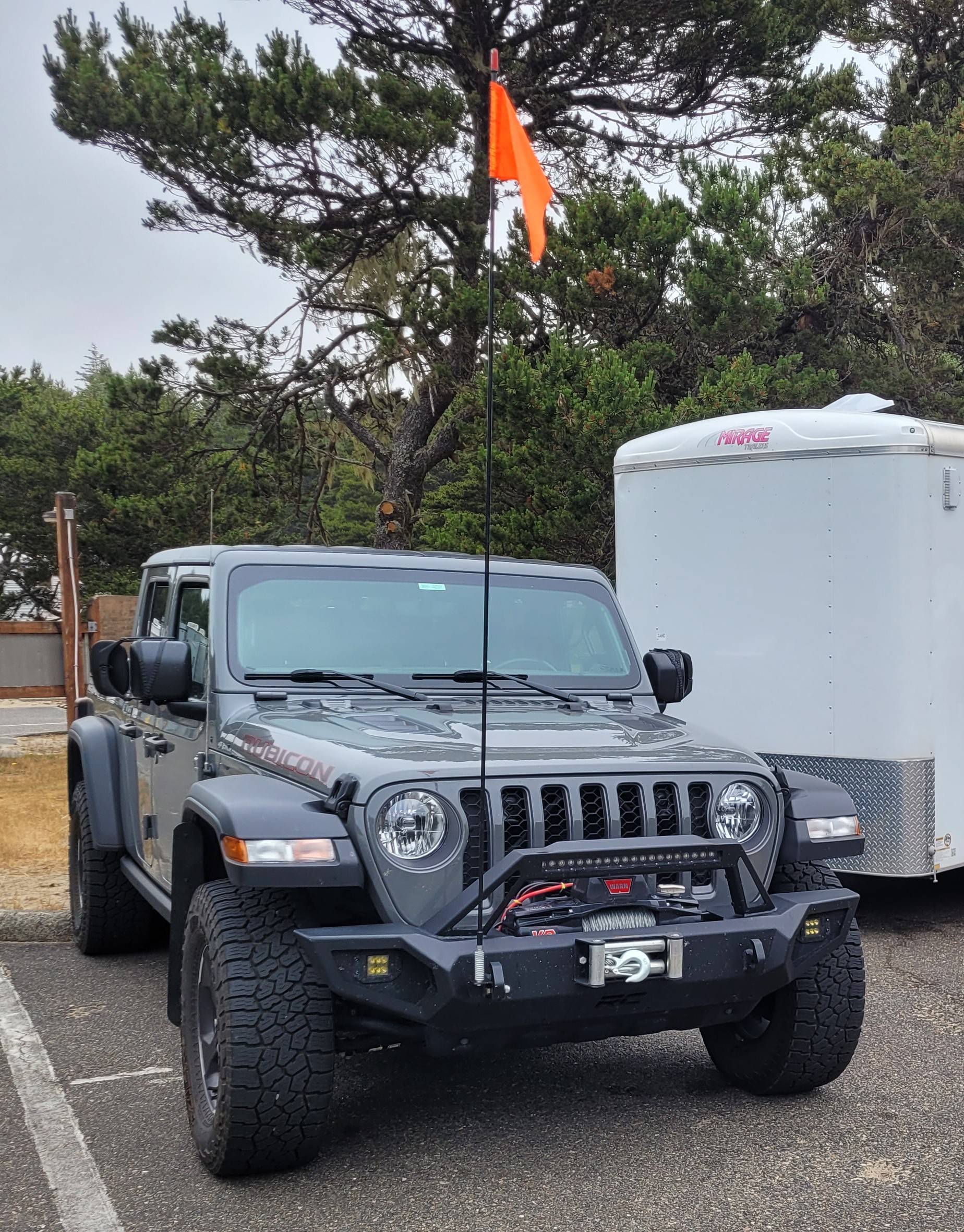

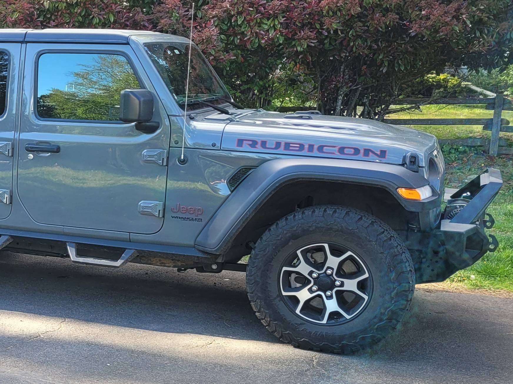

Rough Country, had it on my JLURD with the RC skidplate. When the wife took over the Wrangler I put it on my Gladiator JTRD with the stock metal skidplate.

This is model 10585 correct? I have a Mojave but it says specifically that it will NOT fit/work with a Mojave. Not sure why - looks great btw.

Yes that is the model number.
My guess is it has to do with the remote shock reservoirs. Or maybe their skid plate. I used the factory steel skid on my Gladiator.

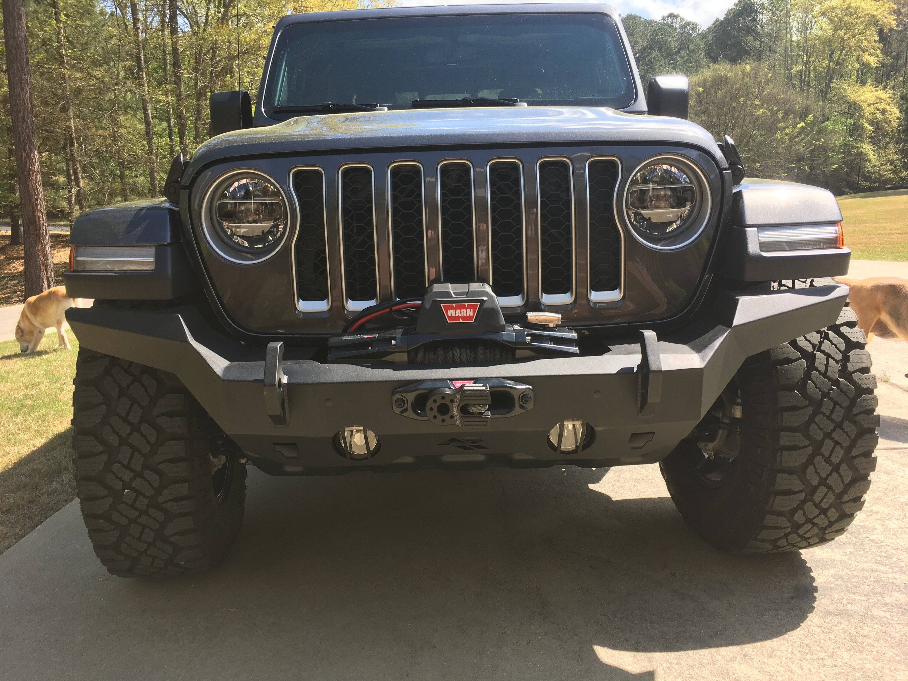

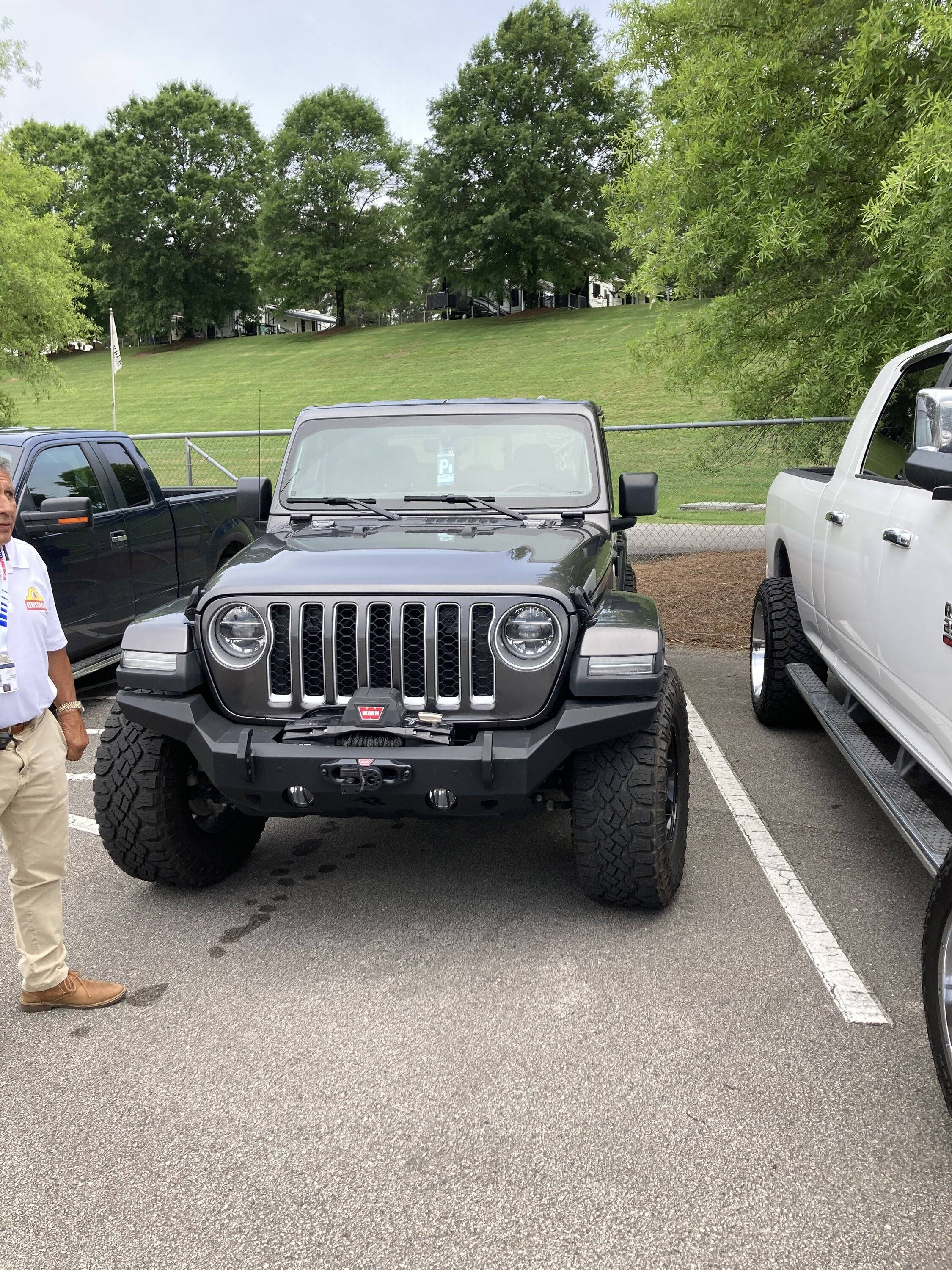

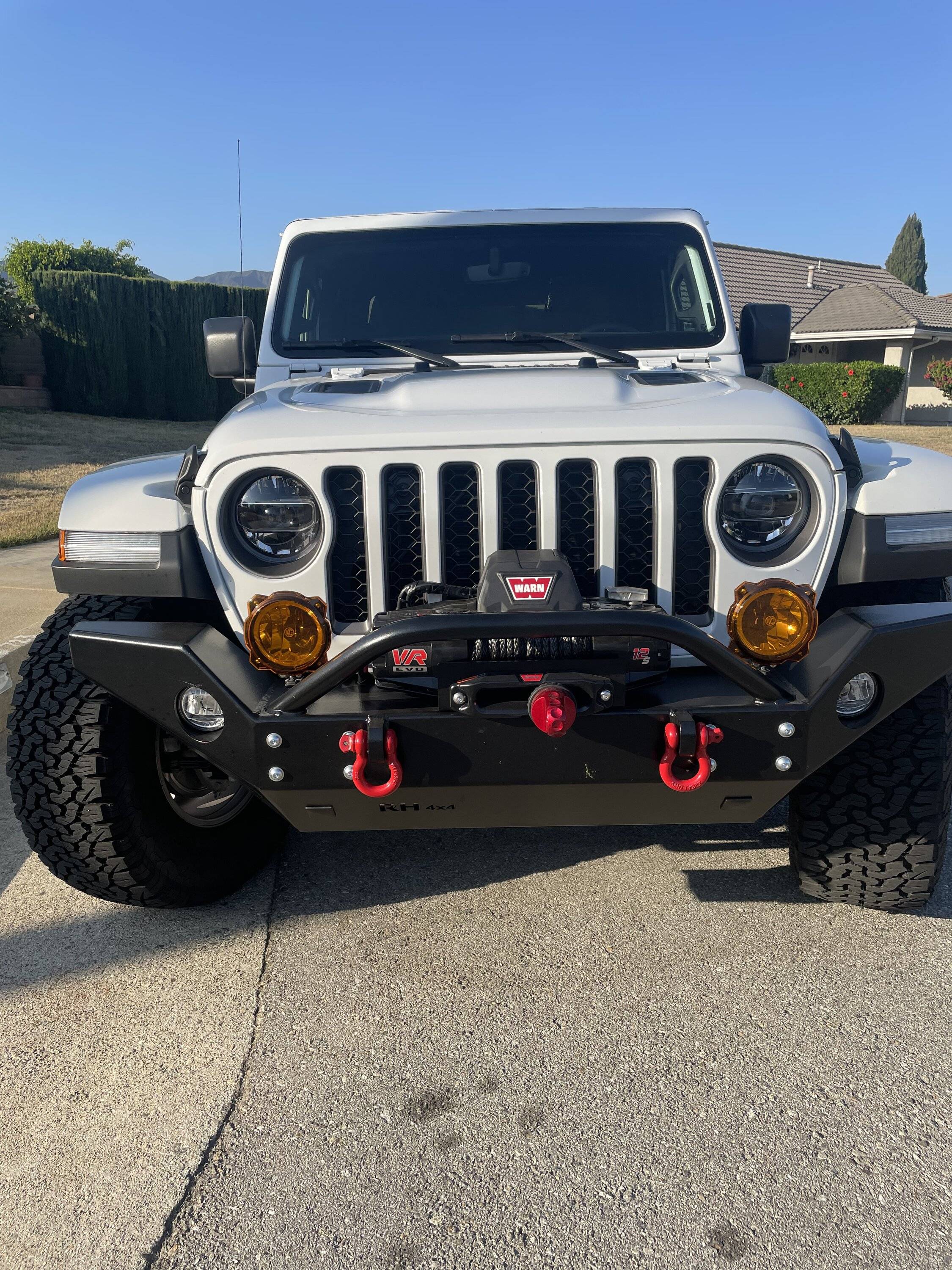

Rockhard Alu and Warn 12K winch. Bumper weigh 37 pounds. KC 6 inch LED driving lights.

Nice - any idea how much your front end dropped after adding that bumper /winch combo? I have the same bumper but without the winch right now. I was debating adding the winch.

I have the Mopar 2 inch lift so it really didn't drop at all with just the weight of the winch as the all bumper weight is the same or less than the plastic one with all the re enforcement stuff. The winch weight total is about 75 pounds. Glad I went with aluminum.

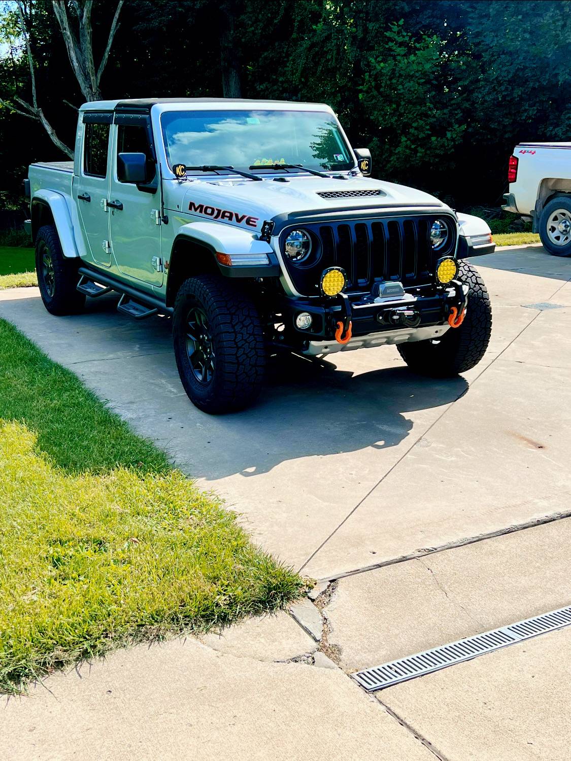

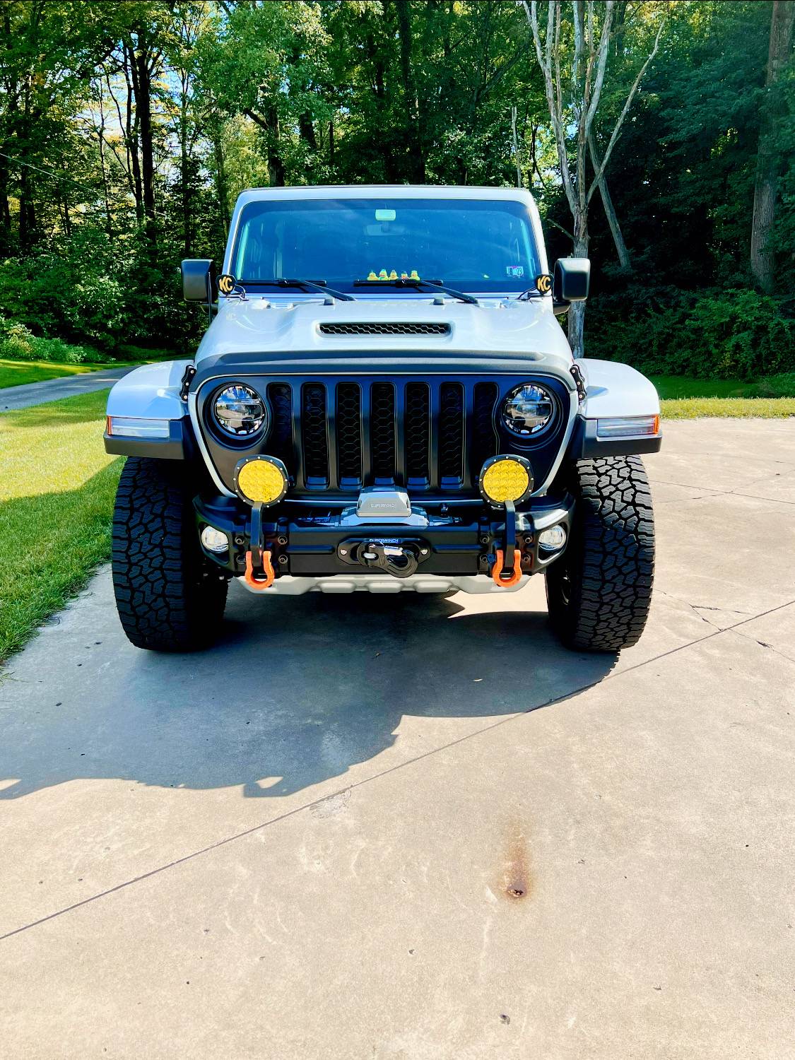

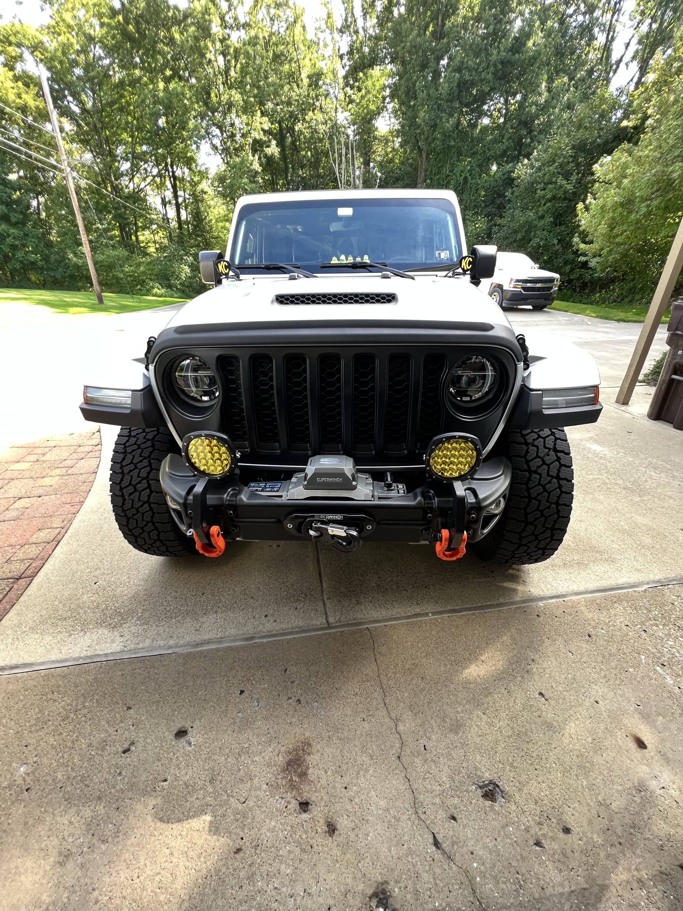

My front end mod is complete, thanks to all for your suggestions, RuggedRidge Arcus bumper, SuperWinch SX10SR and BIGLION.X 7 inch round of road led amber lights......... :)
