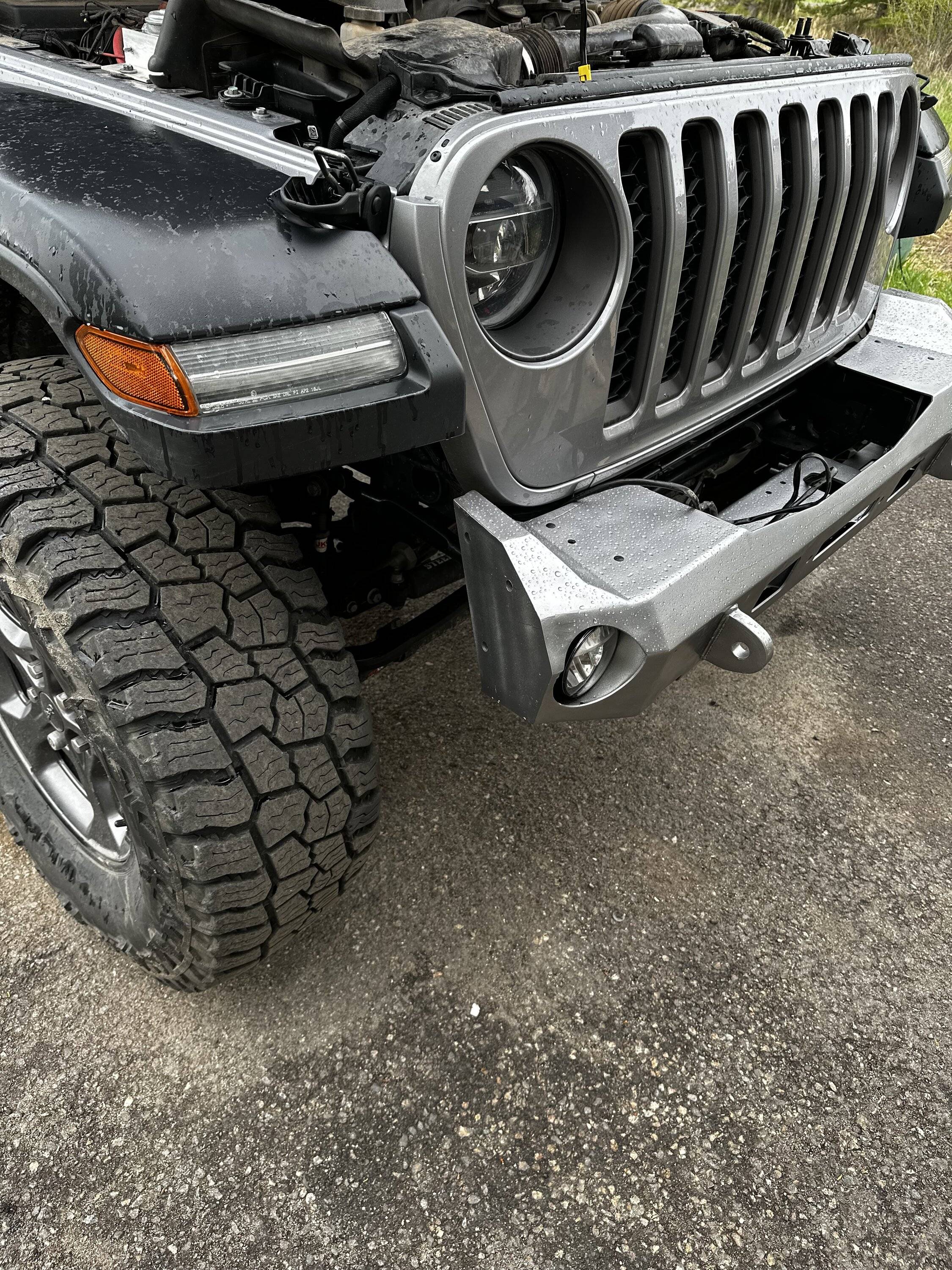

I know it’s a personal preference thing but I hated that the stock bumper didn’t have shackle mounts. I really do like the look of the Rubicon steel bumper but when performing any recovery, I really do prefer to have a more positive attachment point over a hook.
And in full disclosure, it did take me two tries to get the plastic pieces cut correctly…lol. Thank goodness they were cheap!

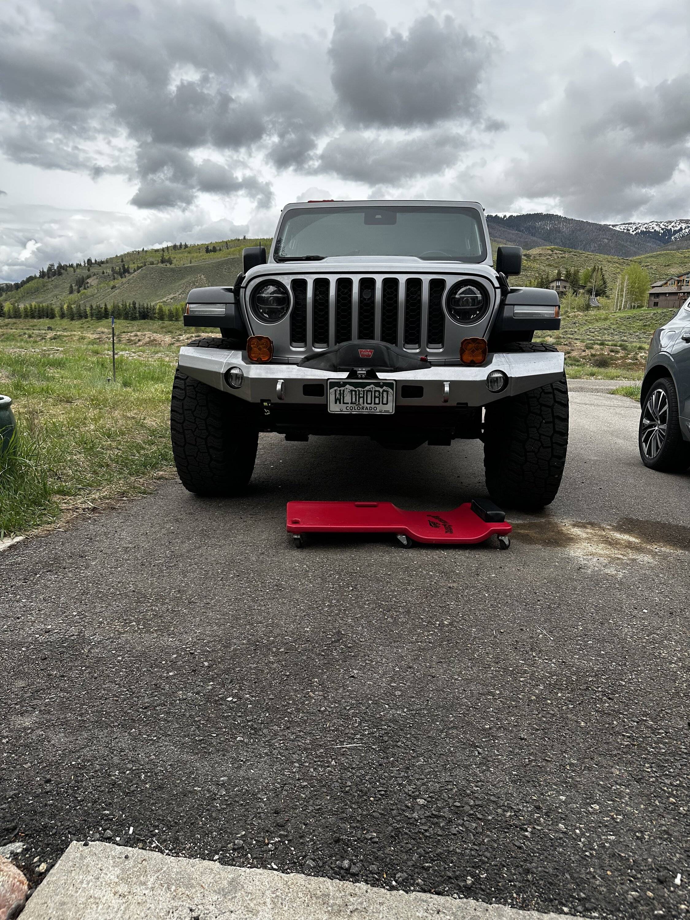

Thanks.
Agreed. I did some winching last week and several of them had the open hooks, and I would have preferred a closed point.

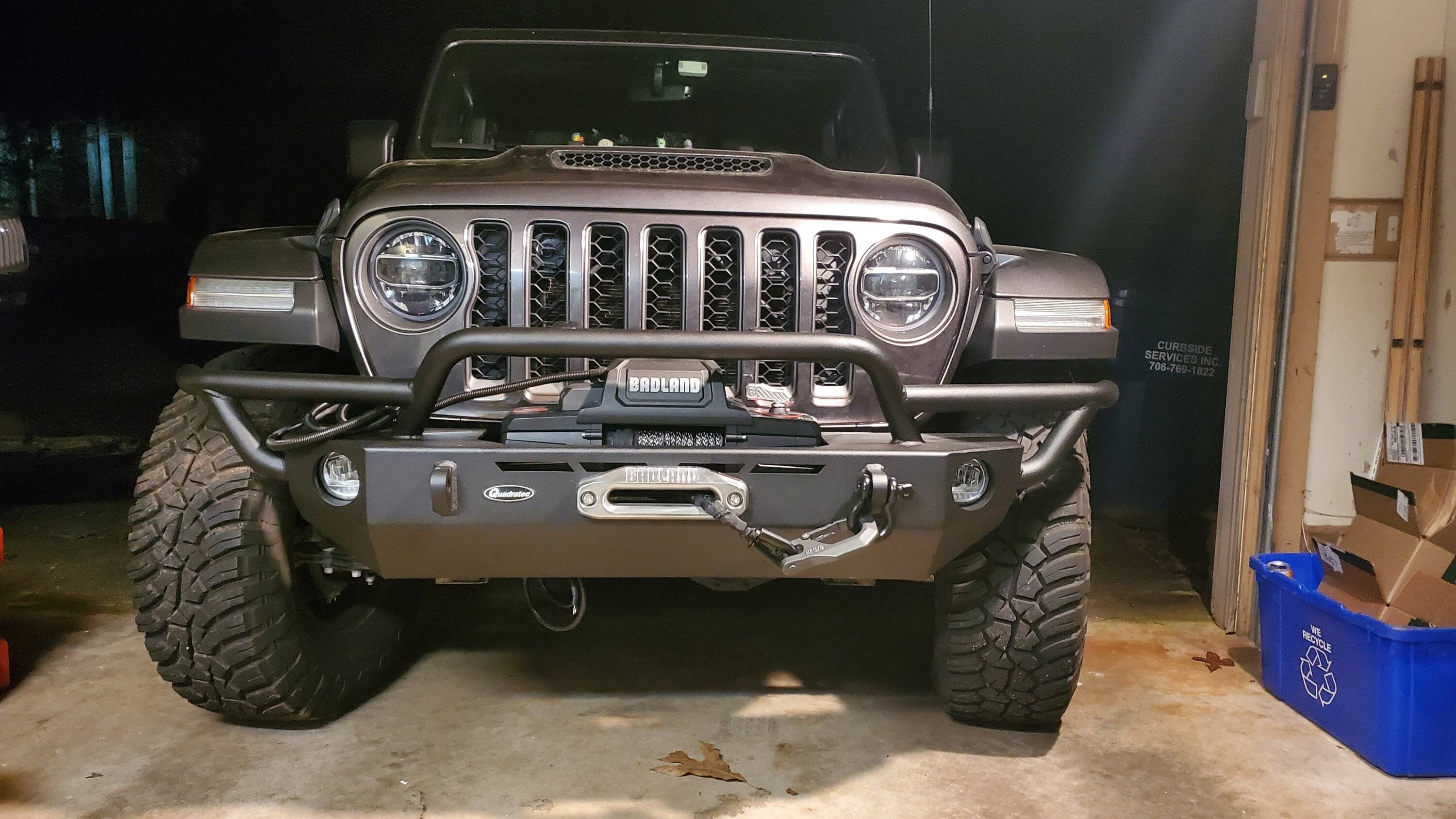

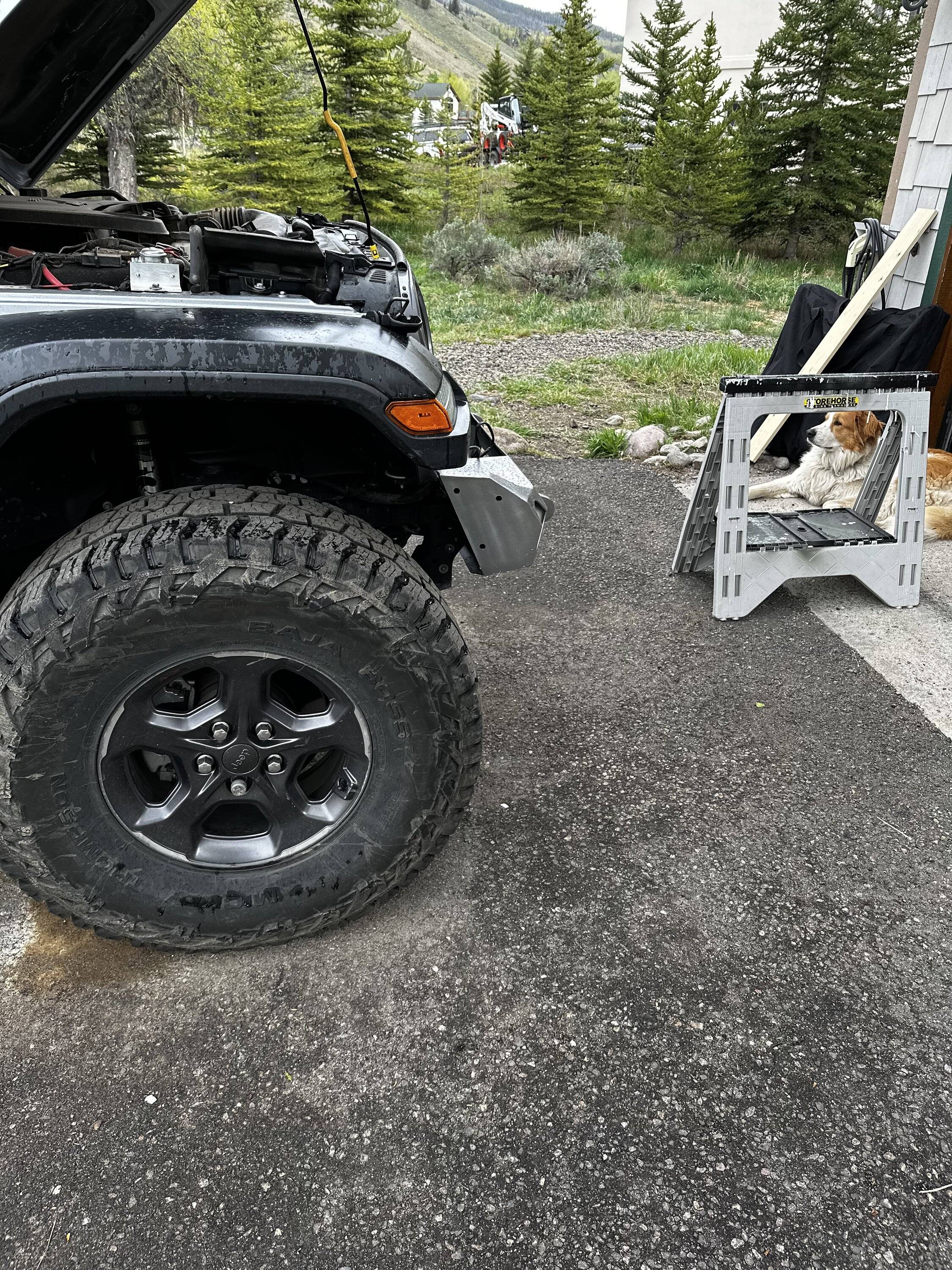

Finished installing the Metalcloak front bumper. What a PITA! If you plan on using the stock skid, expect cutting about an 1” for clearance. Also if you have a Mojave, trimming of the shock reservoir mount is necessary.

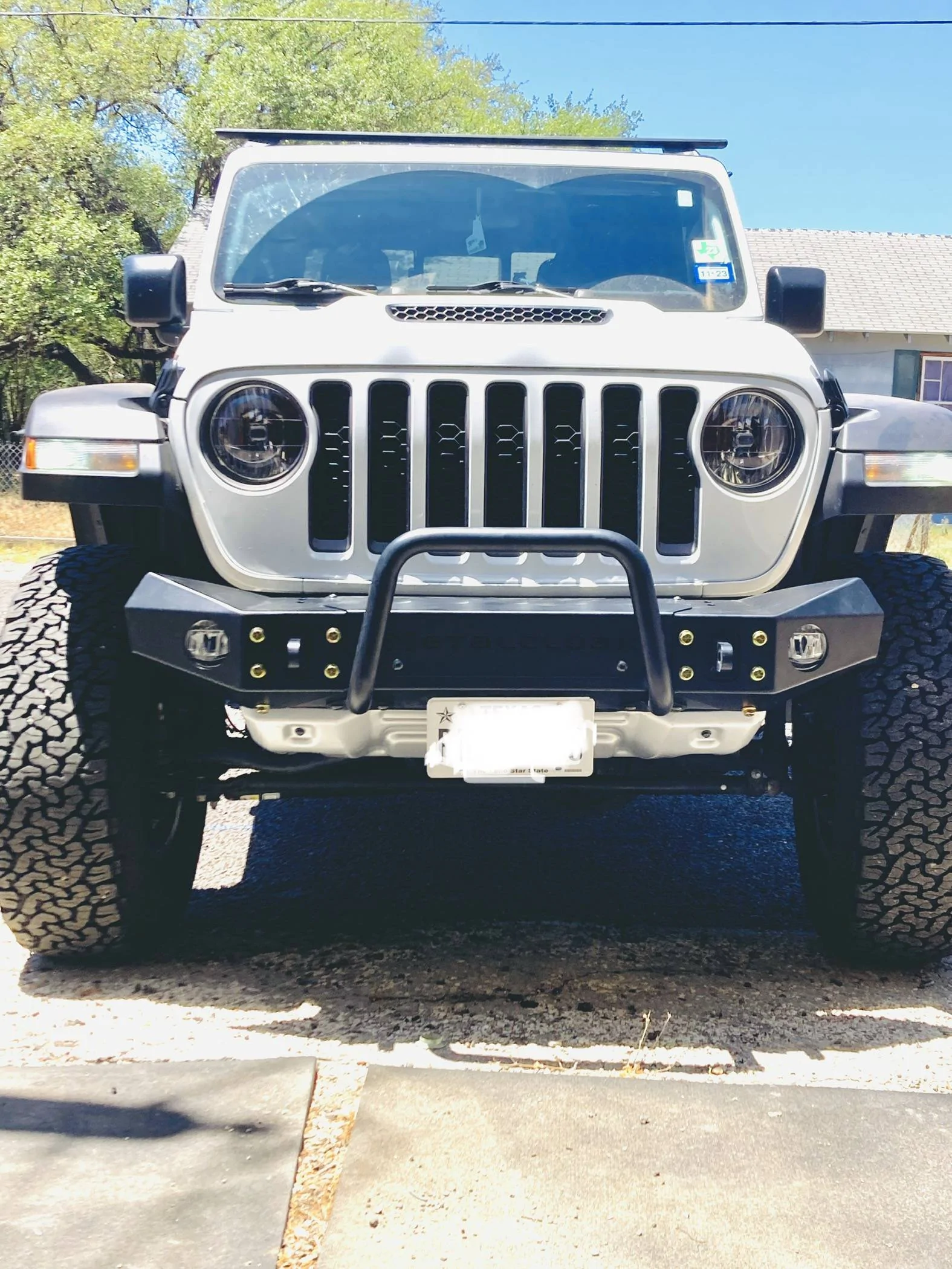

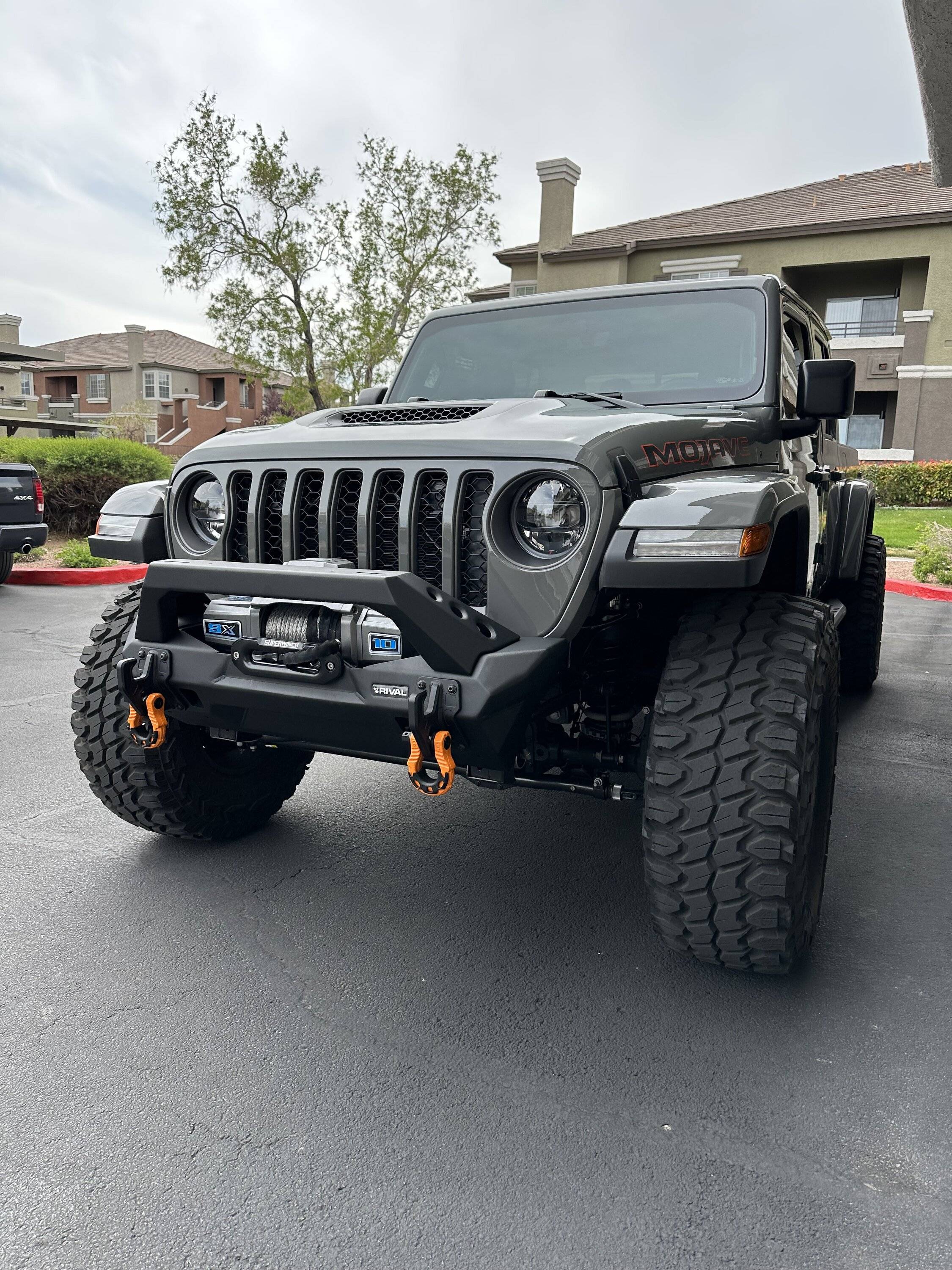

Rival 4x4 stubby bumper. It looks great and is pretty light, BUT just know there's NO space for factory fog lights. not a big deal to me since I'm going to ad alot of lighting

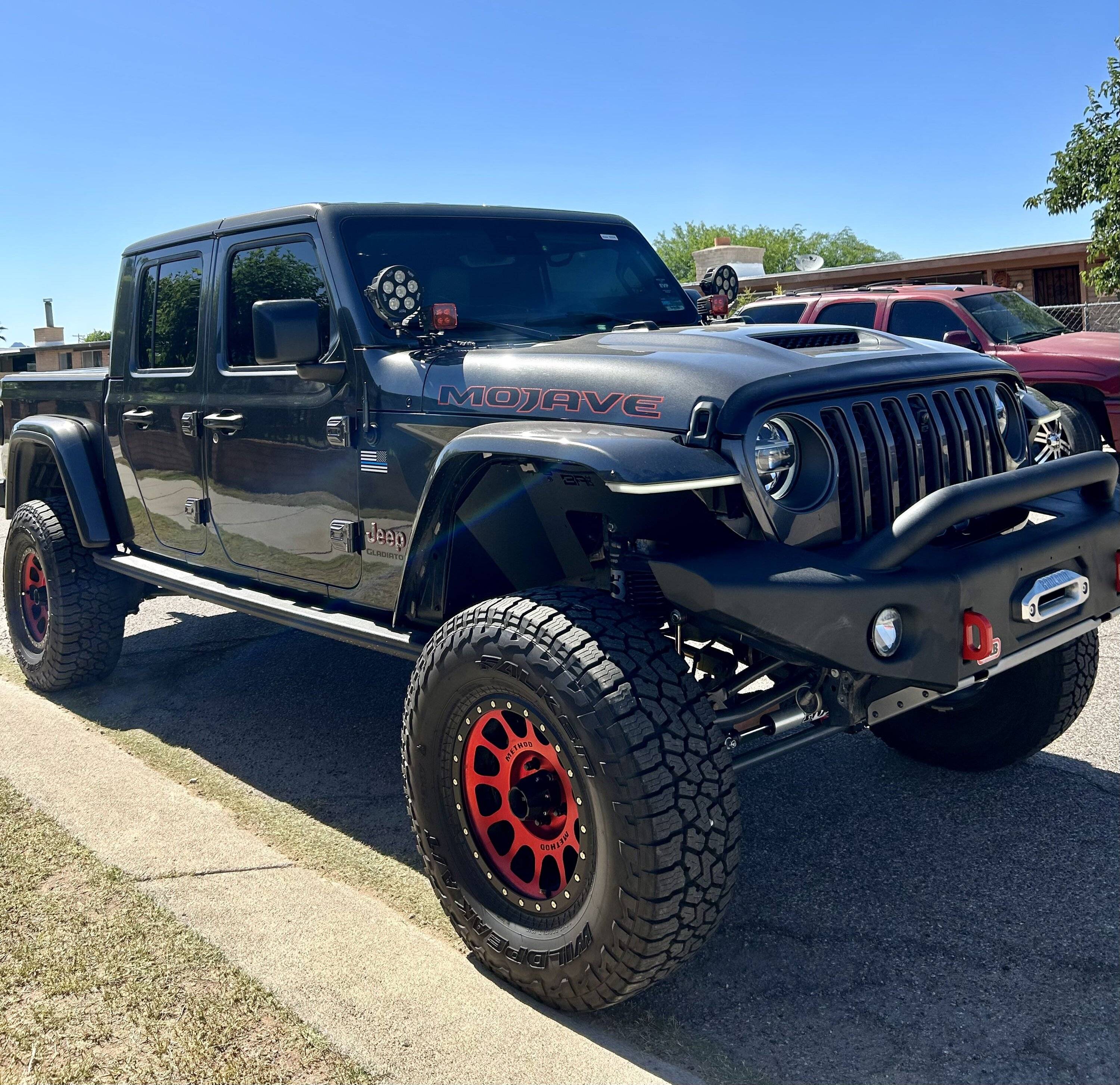

Rugged Ridge HD Full width bumper… *note* I have an EVO Lift, with 35’s and the sway bar disconnected the tires chewed at the bumper under full stuff if you were steering*…. So there were some modifications made
it’s now a stubby…. I loved the wings under the fenders but when wheeling they were in the way ( which I thought was ludacris, especially with roughly 4” of lift in the nose and 35’s ?) so they got kicked to the curb, then I welded caps on both ends (3/16” steel) I kind of dig it since it doesn’t look like The factory RR stubby and I still get those meat hooks up front!
Im NOT a fan of the full length bumper look, BUT the change you made looks RAD!!!

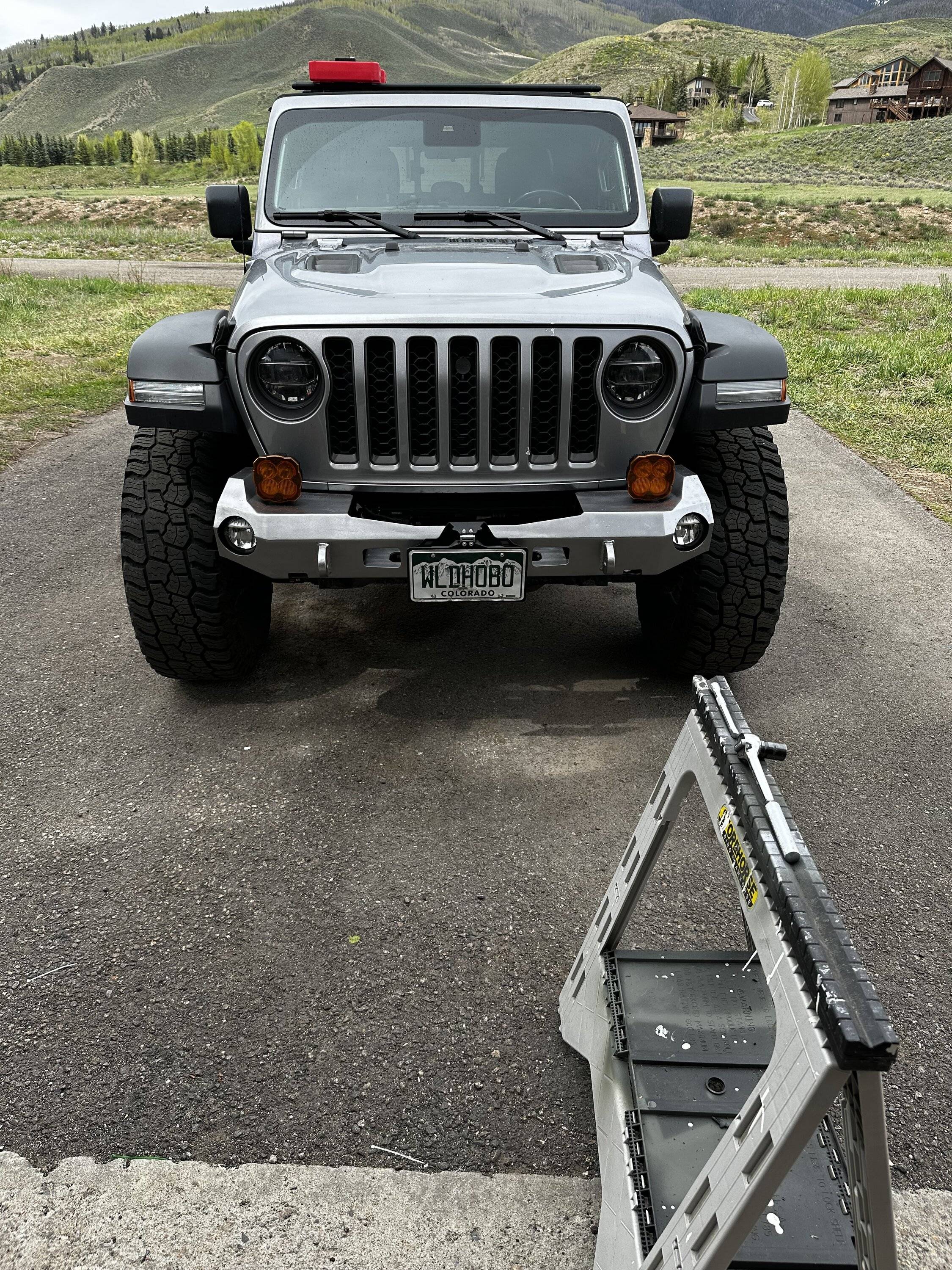

I know the feeling. I chopped my full width for the same reason, welded caps on the center section and the wings, and now it’s modular. I can remove the wings with three 1/2” grade 8 bolts for off roading. If you still have your wings you could probably do the same.

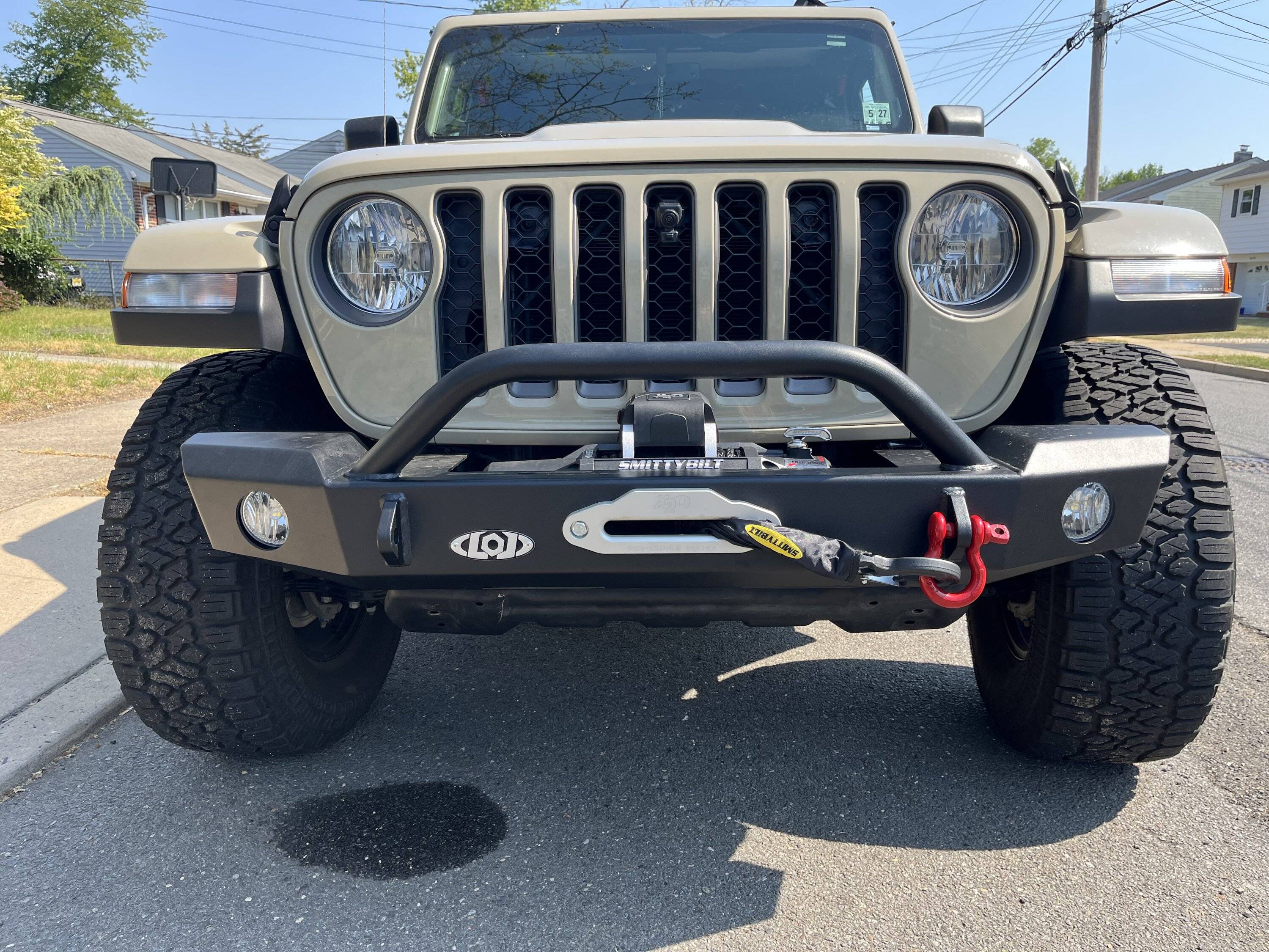

LOD signature series mid width bumper, fog lights & skips plate fit. Smittybilt X20 gen2 10k winch. Waiting on my other Crosby shackle to come in.
