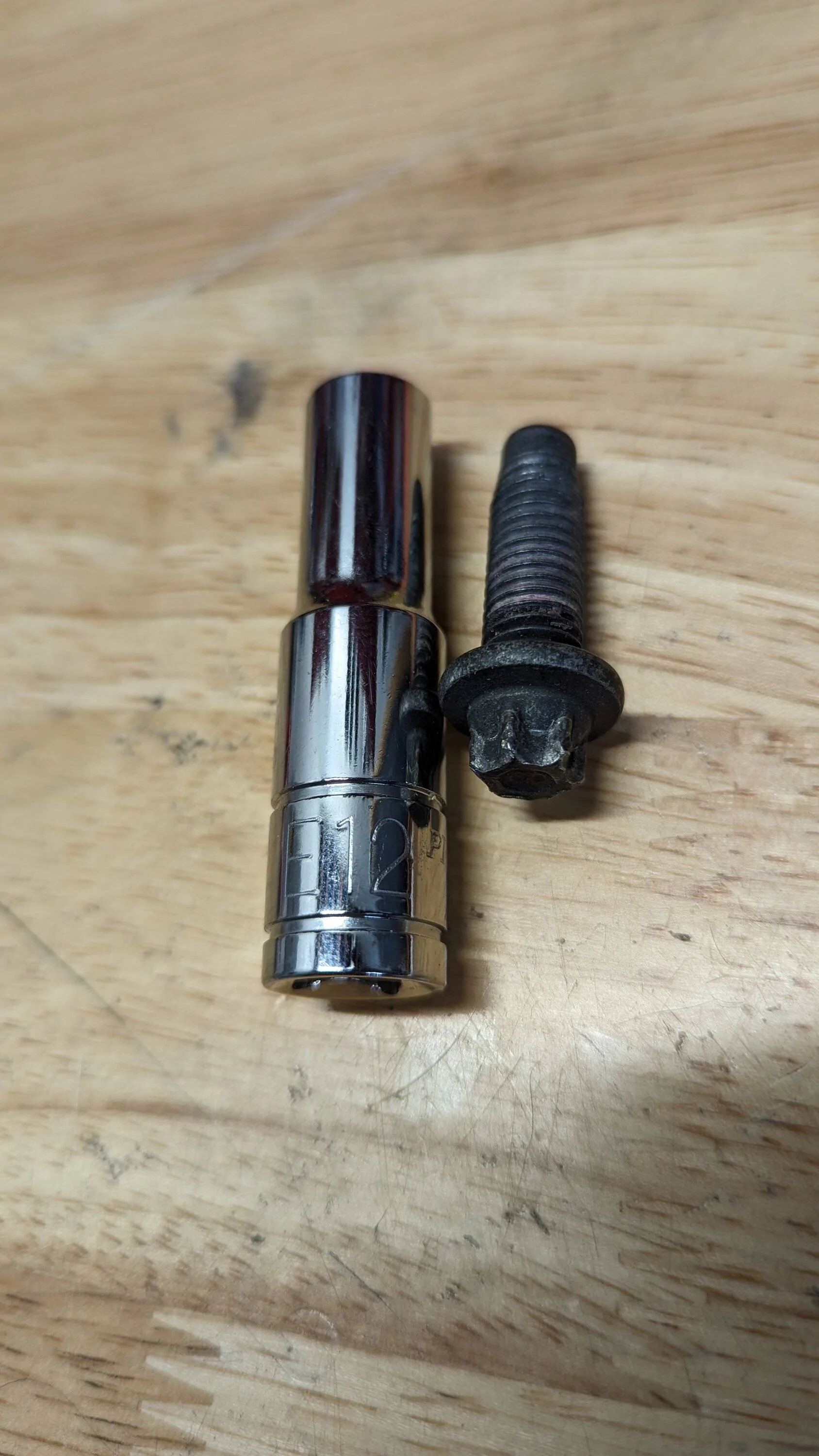

I was using a regular socket also, worked for all but that one.
I have a feeling the above sentence is tied to the below sentence
Turns out... It was stripped out/damaged from the factory.
Not judging, i did the same thing not knowing etorx was a thing. if it makes you feel better new seat bolts from the dealer are cheap as shit (you're welcome to ask me how i know, but you've probably already assumed correctly).
Anyway, i now own etorx bits

Nah... it was already that way. The first one near the door, came off easily. As soon as I applied any pressure to the second one(damaged one) the socket immediately slipped. Many others have taken them off with the 3/8"... without issue.
BUT , you are correct, the right tool for the right job is definitely preferred. I knew the male was a star/torx, but I didn't know the name for the female (etorx)... but now I do.
I have the set @Jefe1018 recommended on order.
I will be replacing the bolts with an allen head. Doing a DIY seat jacker.

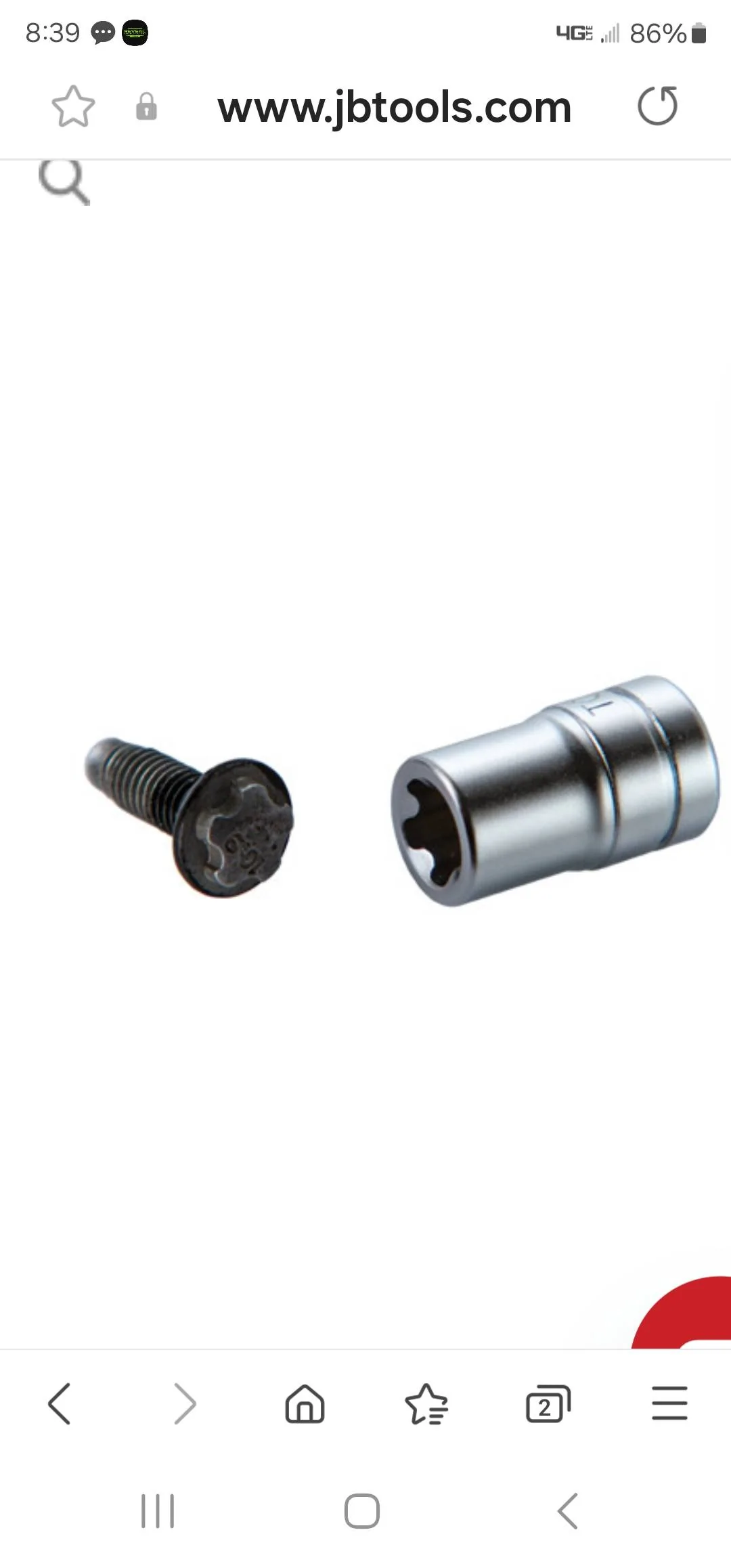

My son informed me that Tesla has special hardware, 5 lobe star head bolts. He was even fooled the first time he came upon one. He also mentioned to me of another alternative the people don't consider. That is the difference between torx and torx plus. That you may find interesting for your bolt.

Cut a line with a dremel and get a punch in there and turn while you smack with a hammer
