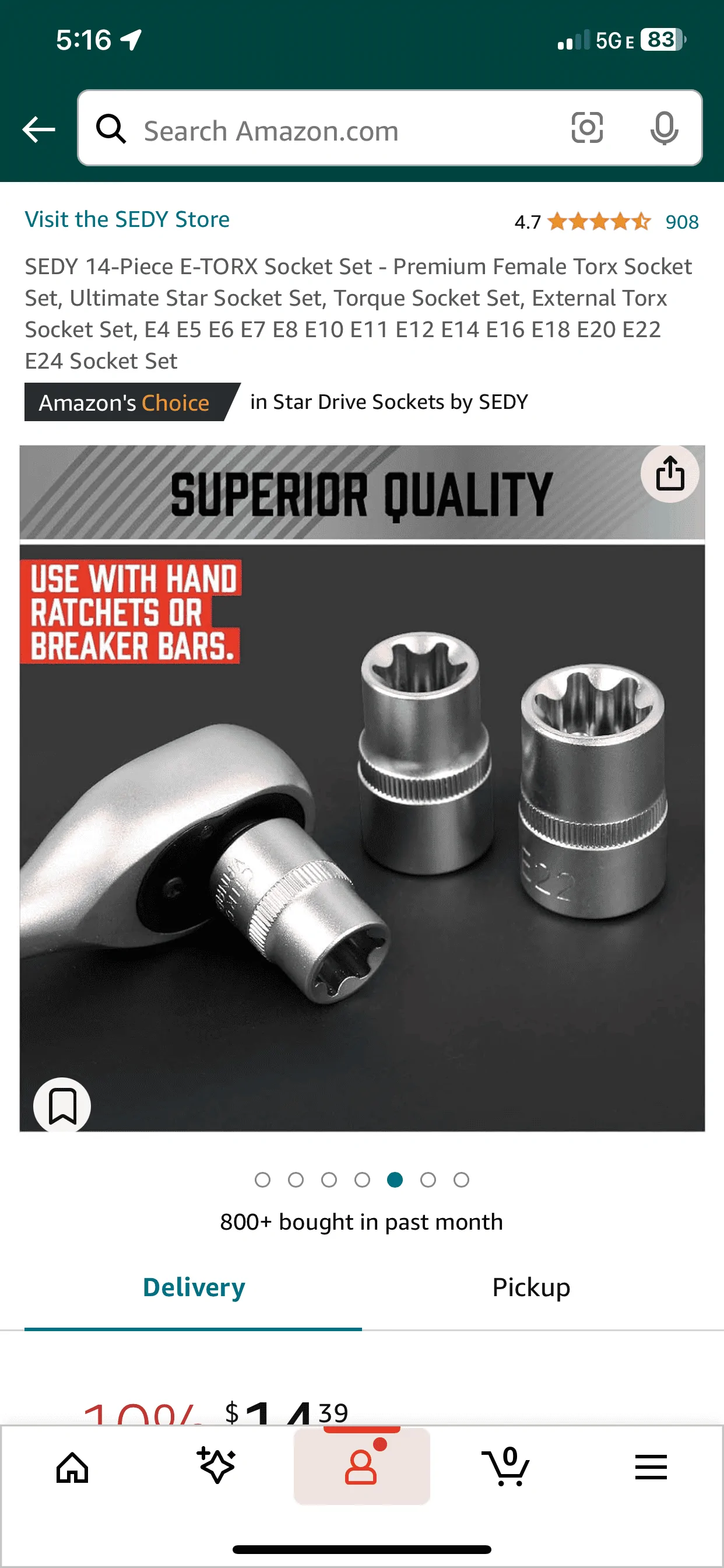

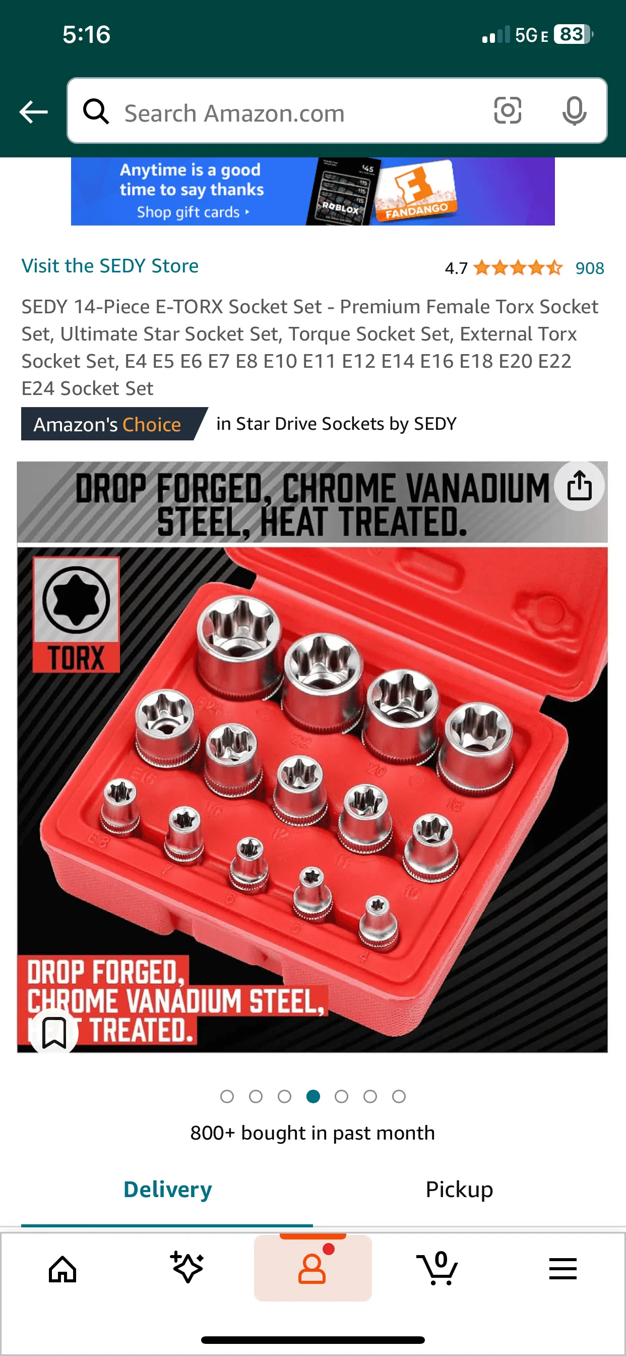

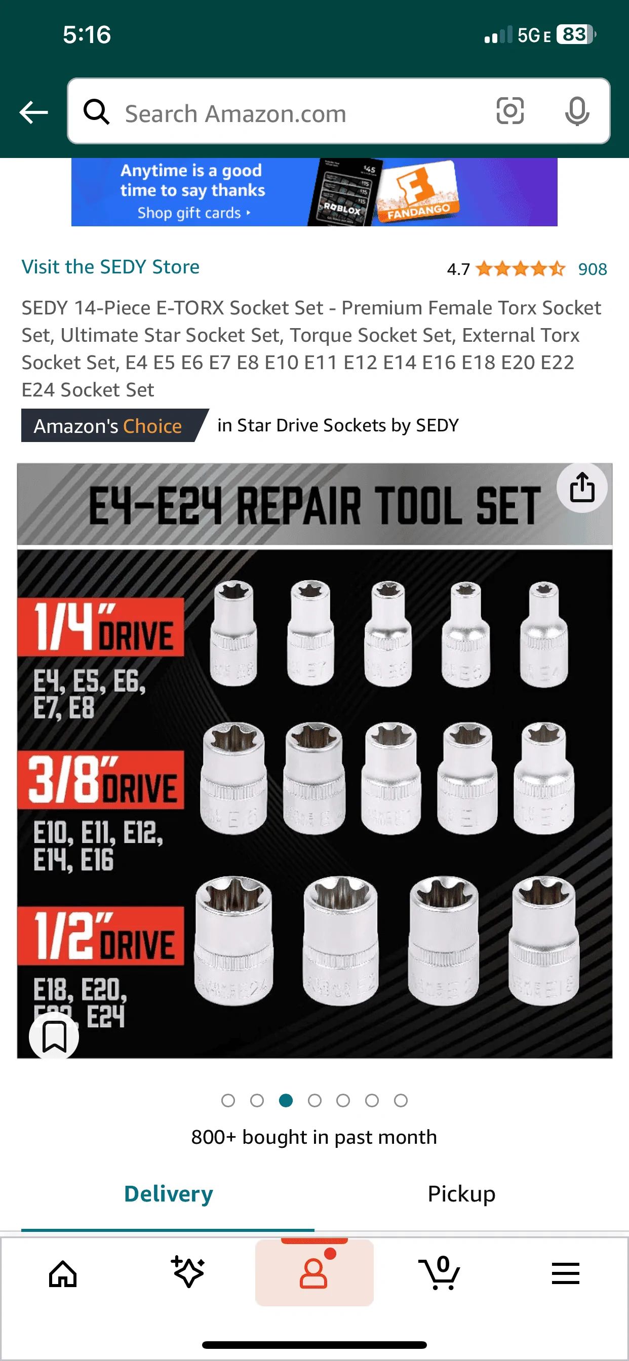

and yes (after researching)Torx and STAR... in my case E-Star is the same thing... torx is just a name brand.
An E-socket is essentially a female Torx. If memory serves me correctly it’s between a 12-14. I got my mini rail set at either AutoZone or O’Reillys and ended up getting a sale item on a large craftsman set. The picture below show the image of it.
They really have great bite, but you need to make sure that you’re on it flush and not in an angle. Additionally the bolts at the front of the seat you need a long extension to get a good flush attachment to the bolt head.

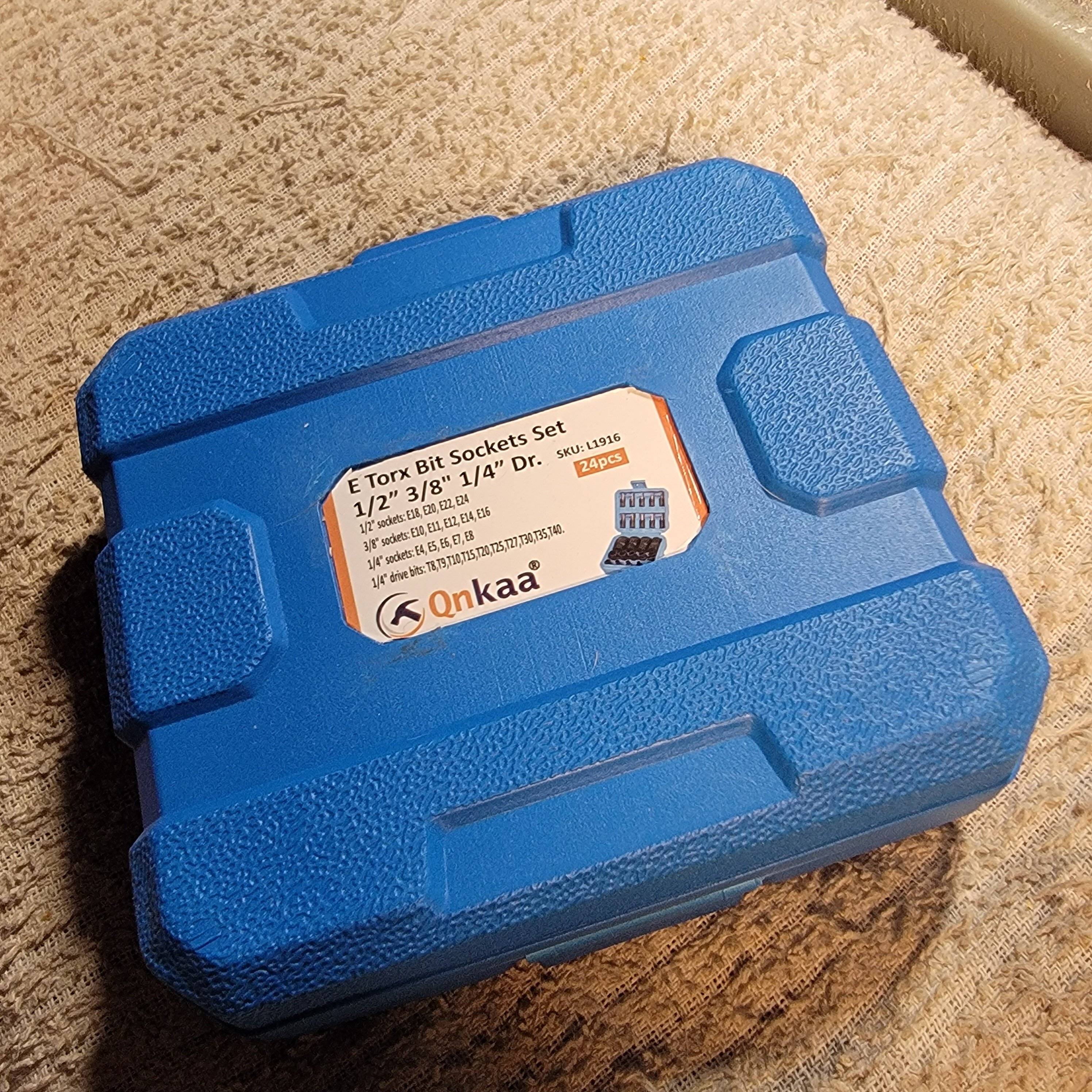

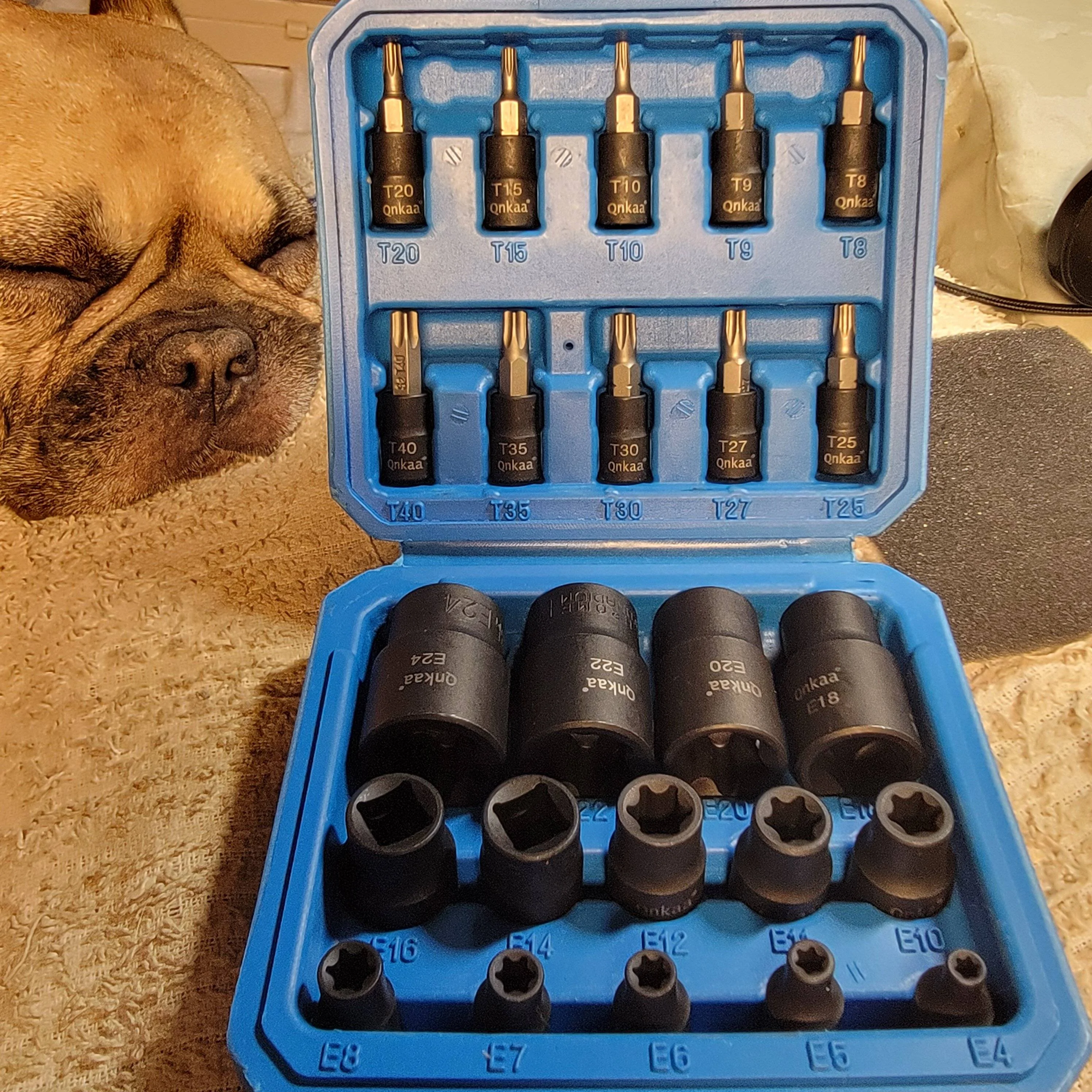

I ended up getting my set in. I didn't go with the set @Jefe1018 suggested like I planned because I really wanted the #11 socket and more of the smaller T-bits.. but basically the same set.
I will report back , hopefully they will do the trick.

Wait a minute! You got your new tool set and took a picture of it? I would have slapped that thing on and gave it a while. Assuming the new tool kit was near the Jeep!
Looks like a nice kit. Impact quality?
