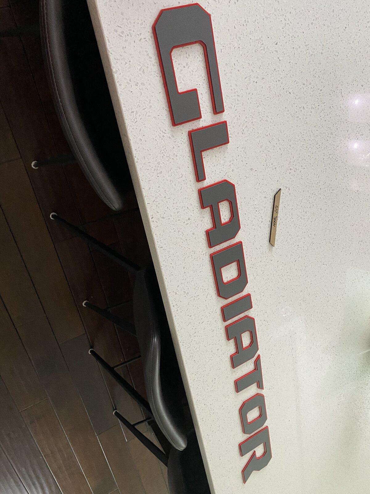

They ship to Canada, ordered mine last week, and just received them yesterday. I’m Vancouver BC.
Will do install next week. Lined everything up on kitchen island easily using spacer. The straightedge method on tailgate with provided spacer should be the way to go.

Yes sir, that is the way to do it. You won't be sorry.

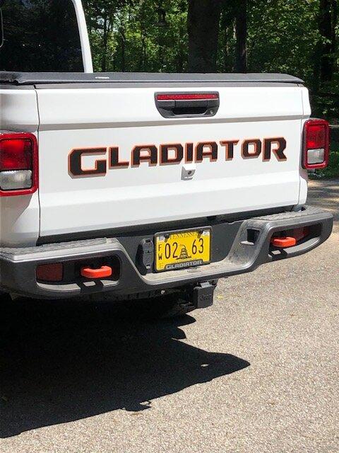

I understand your rationale for removing the tailgate and defeating the gravity thing, however, one thing to mention is that I used a 60" straightedge and using painter's tape, I found that I had four very nice registration points. Those are:
a) The rear camera was key for centering the "I". From there you use your spacer to keep everything in synch
b) The bevel crease in the tailgate that runs left to right and is beneath the tailgate opener
c) Finally, the two tail lights.
By taping the straightedge at the exact same point on those two tail lights I found a true and level point from which to work that was plumb with the universe.
If you remove the tail gate you will lose those two valuable reference points.
Don't let this sway you one way or another as your idea has much merit, but just consider all of the options and this will come out just great, I am sure.

Copy, I hear you, and that point makes total sense, which is probably what I’ll do. I want this to be as bang on and symmetrical as possible.
Thanks for the input ?
