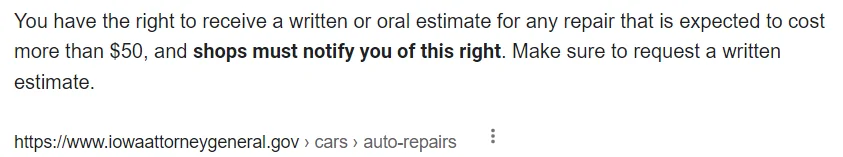

Is that even legal? In California a written estimate is required prior to charging anything.
250
40,620
54,308
Very good question. I don't know if it's law here in Iowa or not, but dealers act like it is because before they'll touch non-warranty, you have to sign off and agree to the estimate, etc.
OK, you got me curious and I looked it up - straight from the Iowa AG ->

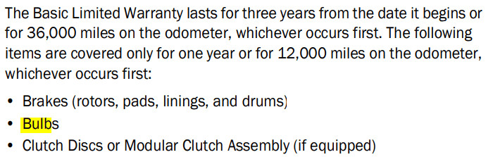

Lights are covered for 1 year/12,000 miles.
So.......... no, it's not 3 nor 36,000 for lights/bulbs - it's in your book.
The following are covered for ONE year or 12,000 miles so they can say sorry, and charge you at 13,000 miles or 12 months and 1 week.
Jeep Gladiator Third Brake Light 1673496707276
Jeep Gladiator Third Brake Light 1673496730445
Most of us treat replacement LEDs as "bulbs" and frankly, I'd bet that they can say "that's a bulb" because when you put LED in your headlights you post that you used an LED bulb.

Lights are covered for 1 year/12,000 miles. - at least if they are considered "bulbs" and frankly, everyone calls even LED lights "bulbs"......... well, most do.
Think of those who put LED "bulbs" in their headlights, so, if it can be called a bulb, it's 1 year.
My dealership said that they aren't considered bulbs because it runs on a board. I had 22,000 miles on mine when they did it and said it was covered. I really just said not sure if it's covered or not And my guy without hesitation said it's definitely covered for the full 3yr 36,000, same as led factory lights and led factory brake lights ECT... are. Normal bulbs are under the 1yr, 12,000 mile warranty though that is correct.
