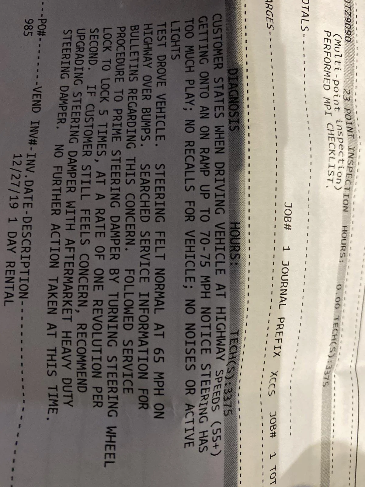

Nope, even gave me a car for the day..
That's part of Jeep Wave. Not sure how that will work with smaller dealerships that don't have loaners! Guess I will find out Monday when I argue with 'em about the cover again.

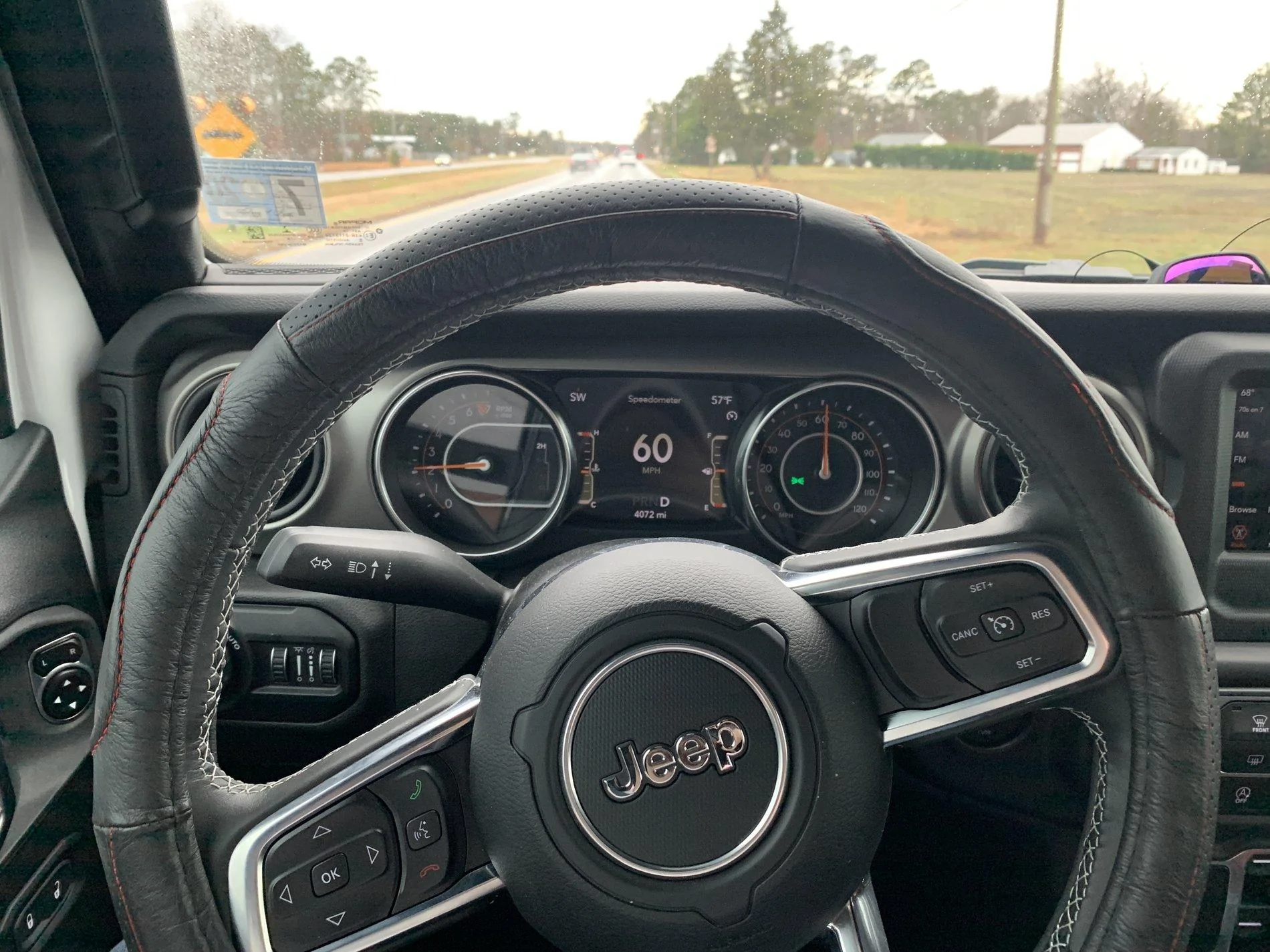

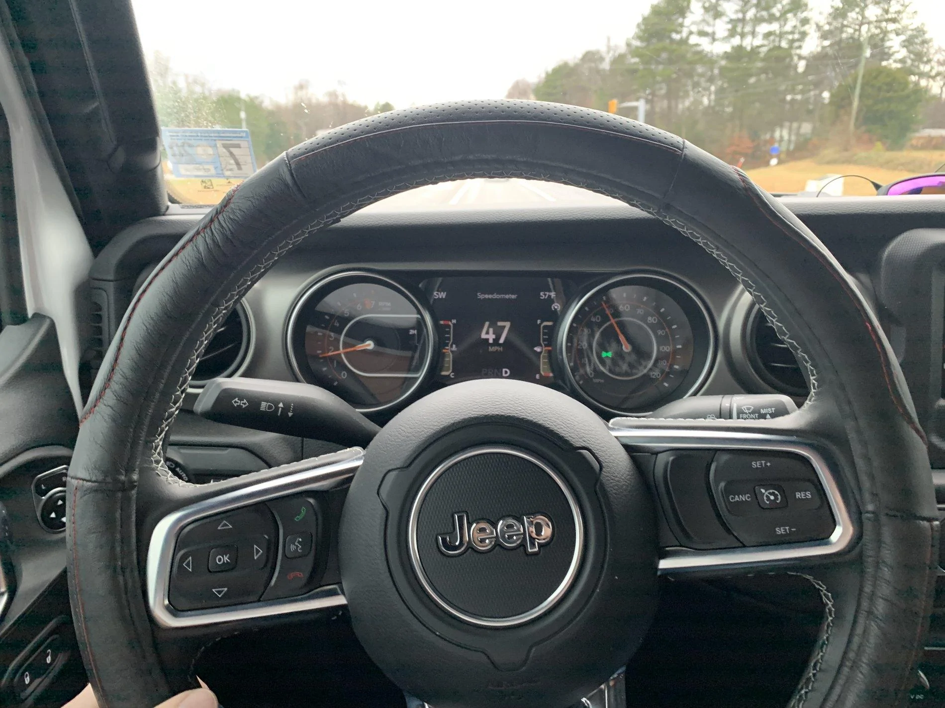

So I had the factory stabilizer and upgraded to the Fox IFP 2.0. The IFP was having the issue of it would push outward, when it was supposed to be neutral. I said what the heck so I’ll just go ahead and upgrade to the ATS, which I threw on last night.
To be honest I’m not that impressed. Even at the highest setting I wouldn’t say it’s not tight or firm. I was expecting a more drastic difference.
I think I had a more drastic improvement from the stock to the IFP, than the IFP to ATS.
Also I have found my steering pulls to the left now with the ATS. Here are some pictures, the first is the left lane, the second is in the right lane:
Jeep Gladiator Those complaining about the steering... get the Fox Steering Stabilizer 1D0A41AF-0A8D-439B-A2CF-D1BB09EEBA73
Jeep Gladiator Those complaining about the steering... get the Fox Steering Stabilizer 44D62867-95B6-4529-B8EA-F4507A4F0571

So I threw the IFP back on and “charged” it like stated from the dealer in the above post.... and wala... noticeably more stable on the highway, more stable over bumps and pot holes, better than the adjustable ATS on max setting.

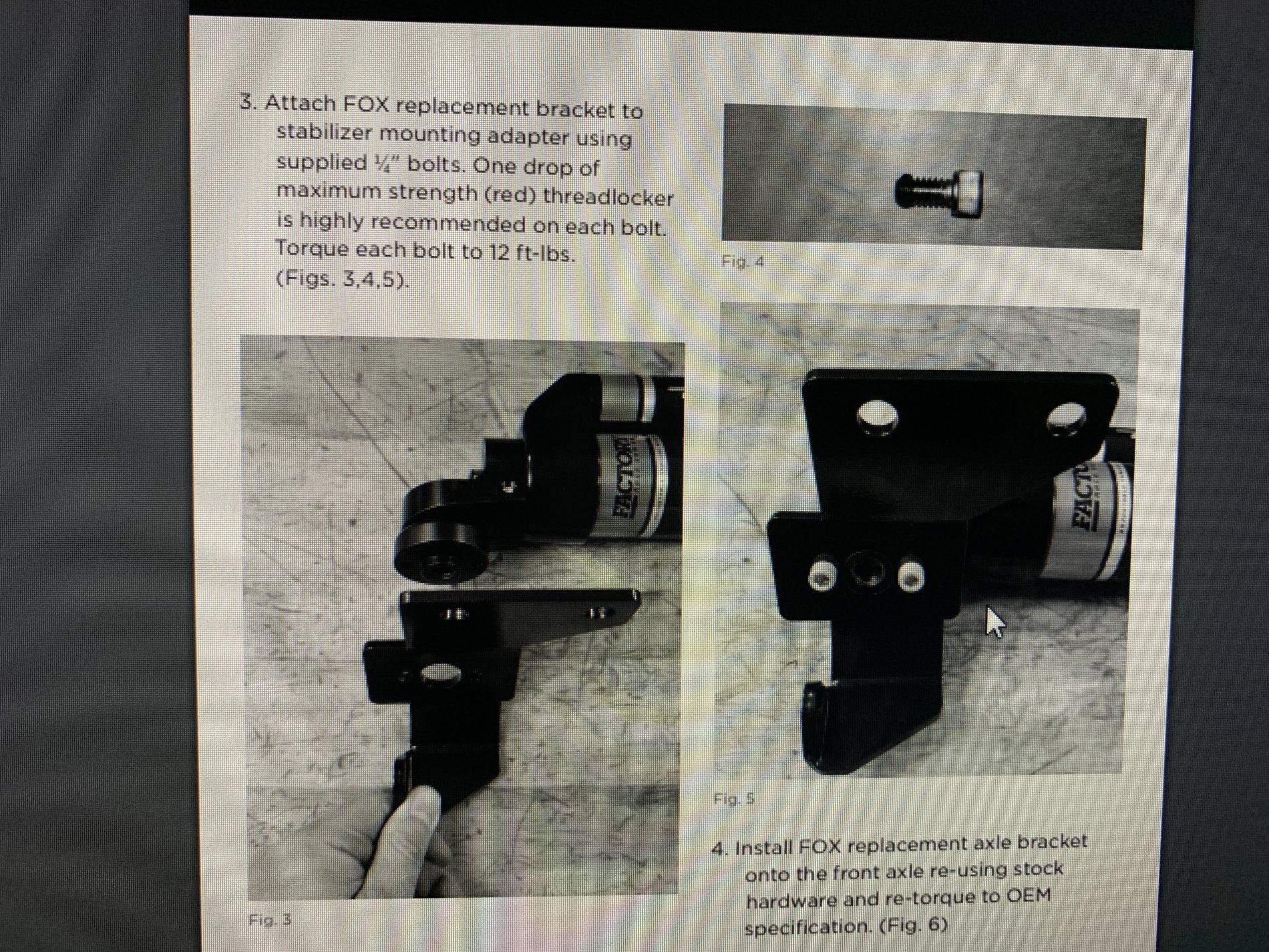

I would not waste the money on either ATS, definitely not the adjustable one. I am also not a fan of the ATS design, the only thing that holds the end on with the bracket is two very small Allen bolts. They are only torqued to 12 lbs. Fox said they were having issues with these backing out so they decide to adding putting lock tight on these in the install directions. Kinda sketch if you ask me.

LOL - 12 pound-feet on a bolt holding a steering part? A sudden jolt and something will let loose. I'd be more concerned about the lack of clamping force with that little amount of bolt stretch involved on two small bolts. I bet they are having issues.

Here are the current instructions... the old ones didn’t have the lock tight part.
Jeep Gladiator Those complaining about the steering... get the Fox Steering Stabilizer 4675257B-2CCC-4B57-90C2-F516C55C3D01
Wow, Daniel - you weren't kidding. Those two bolts, and only 12 pound/feet.
