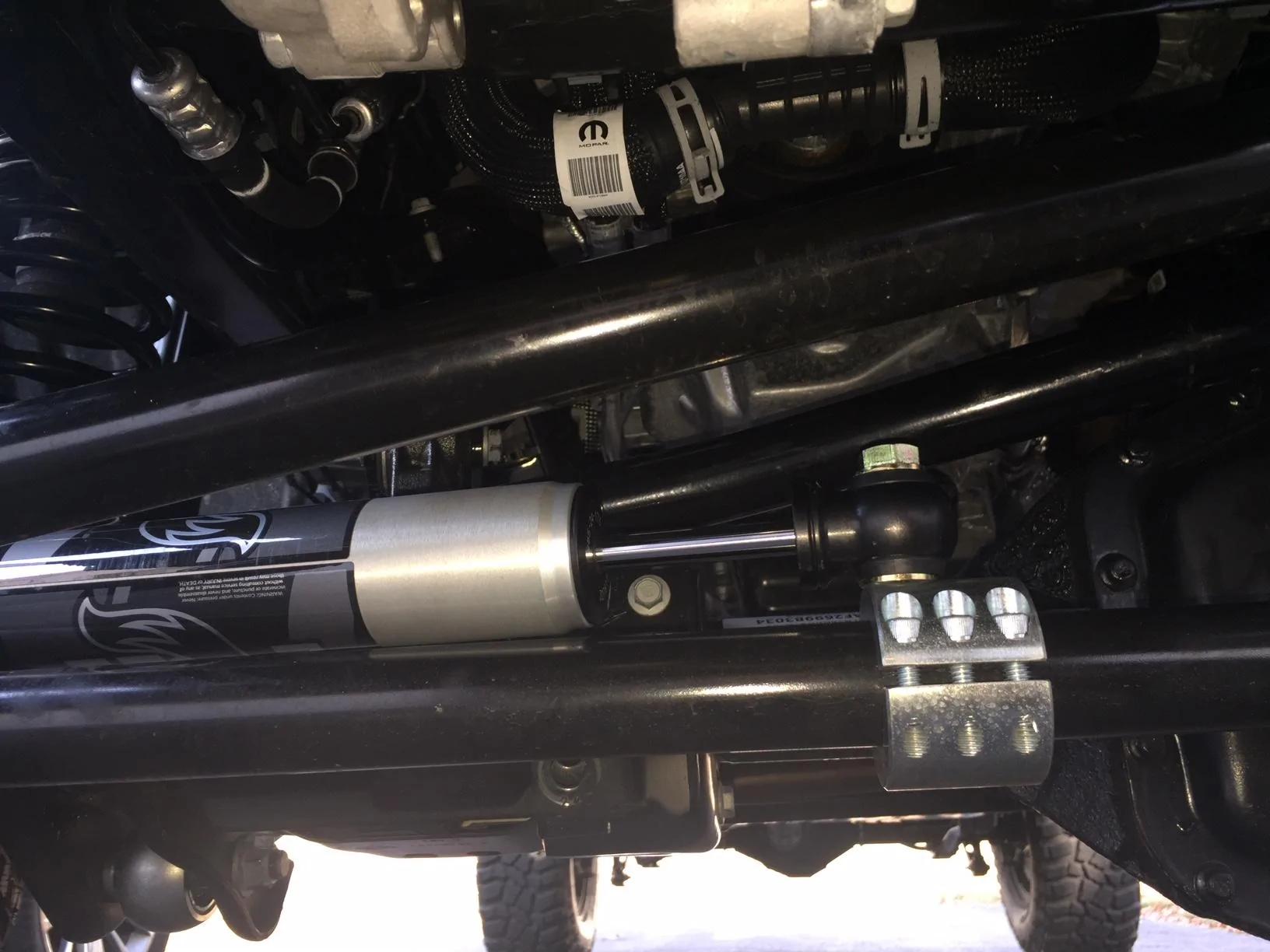

Ive tried the IFP and the ATS ( the same as the one you listed but adjustable) and I got better results with the IFP: https://www.quadratec.com/p/fox-rac...ce-series-ifp-steering-stabilizer-wrangler-jl
I found steering and stability to be better with the IFP. It’s a true stock swap out with the same two major mount points as the stock one.
I am NOT a fan of how the though-shaft versions mount, with two tiny, low torqued screws on one side with bracket (attached picture). In your situation where your stabilizer failed, would you depend on these two little screws, with lock tight to hold together? I wouldn’t!!! Poor design in my opinion!
The ATS also caused me some steering issues (one sided pull and steering wheel off center).
My only advice with the IFP install is to prime it by turning lock to lock (side to side), 5 times, taking at least one second per evolution. This helps ensure the neutral charging of the stabilizer.

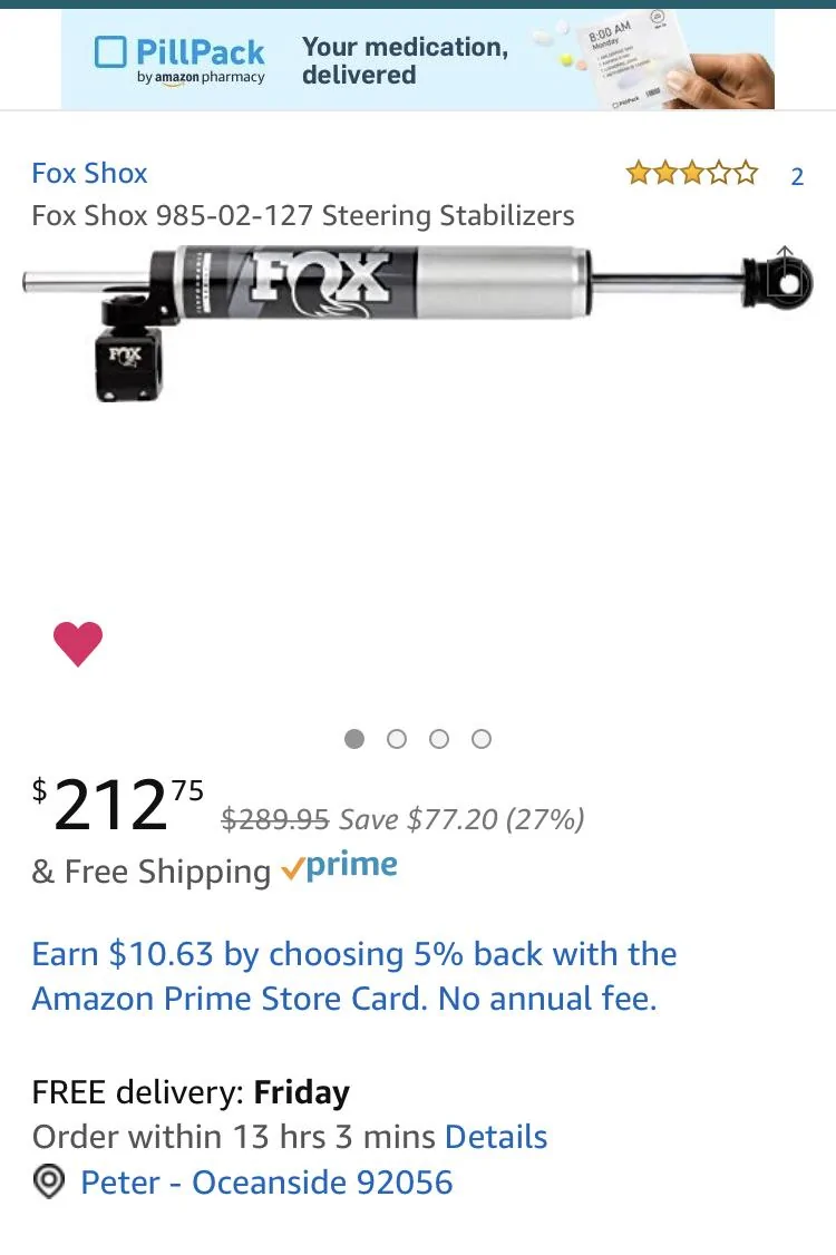

Much appreciated, exactly the info I needed, just ordered through Amazon, supposed to be here Friday, (fingers crossed).

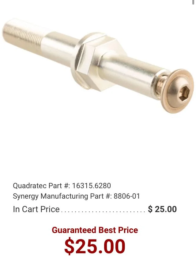

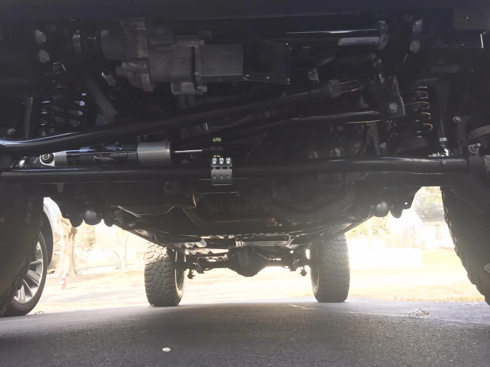

Does the Synergy relocation kit attach to the drag link or the tie-rod? I’m a newb so please pardon my ignorance. Would the new attachment point improve handling or help deter shimmy or wobble? If so I’ll get it and install that as well.
It attaches to the trackbar at the axle side and then you clamp the other end to the tie rod... the jk’s did this this for all their years. For the JL and JT Jeep changed it to what we have.
IMO, you can get the steering stabilizer up above the tie rod so you don’t hit it off road... or if you hit a concrete curb if it went too far.
Renegade
Zac
Sep 11, 2017
3,615
4,816
Signal Mountain, TN
2020 JT
For clarity, it attaches to the track bar bracket, not the actual track bar.
