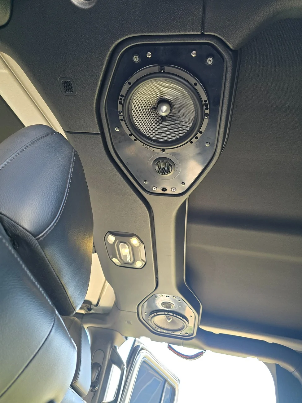

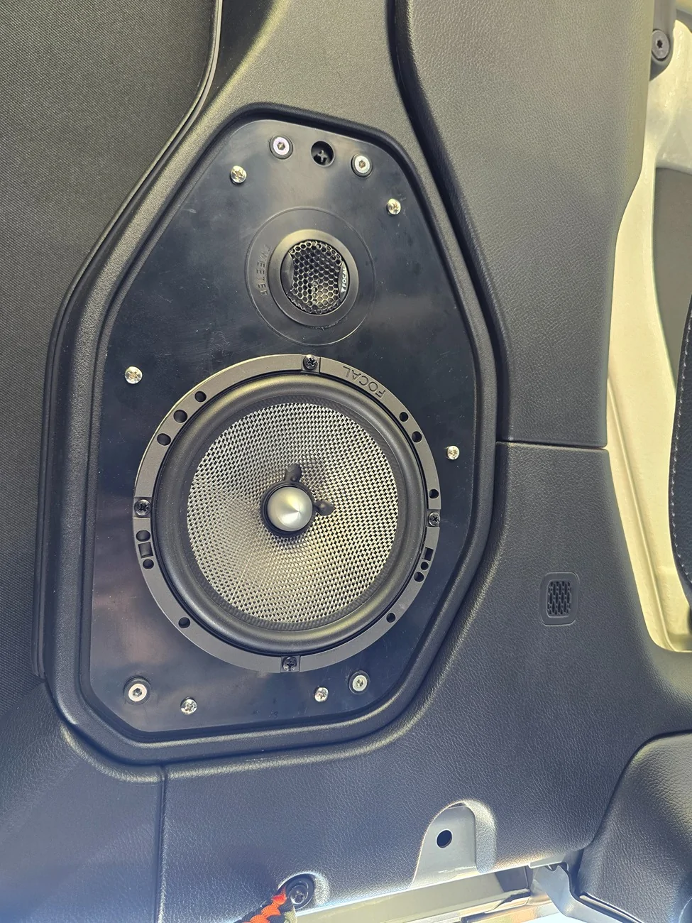

Added Focal 6.5 components with sound deadening in the soundbar. Used the same components up front and powered with a 4 channel amp. Also put 2 subwoofers under the rear seat and amplified. Lots of work, but 1000% worth it. HUGE improvement in sound, no comparison to the premium factory sound system.

was that baffle made for the focals specifically ? or does a company make them for the jeep application

The speaker adapters are made by Stinger and are not specific to the focal speakers. They come in a kit with adapters for the 6.5 and tweeters like I did, but also includes a plate for 6x9 speakers and replacement speaker grills.
https://www.quadratec.com/p/stinger-offroad/sound-bar-speaker-mounting-stxjlsba
There are other similar options made by other companies, but I chose these as the grills maintain a factory appearance.

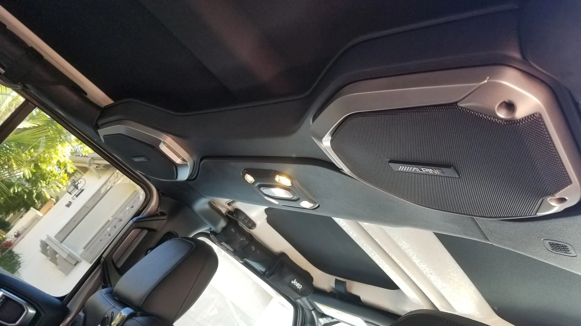

For me it absolutely was worth it. The sound quality is night and day. And mine look OEM premium to me. I have the same Alpines that @Jeepmonster pictured. I put matching alpine tweeters in the dash. The knee kick speakers are still Oem.
