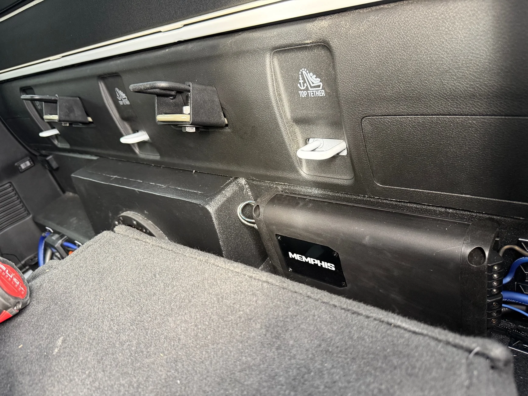

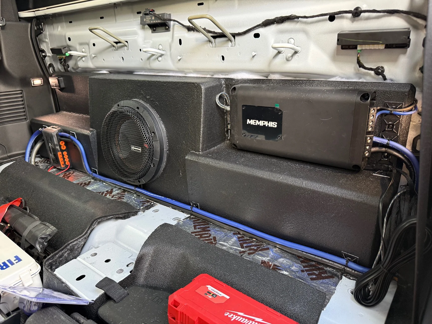

Rouse912
Barry
Jan 1, 2026
hawaii
2025 JT Mojave
This set up added the right amount of balanced bass for me while not losing the under seat space
