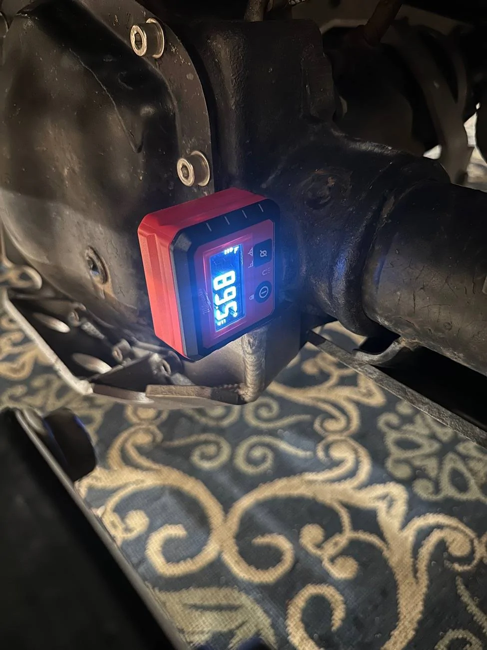

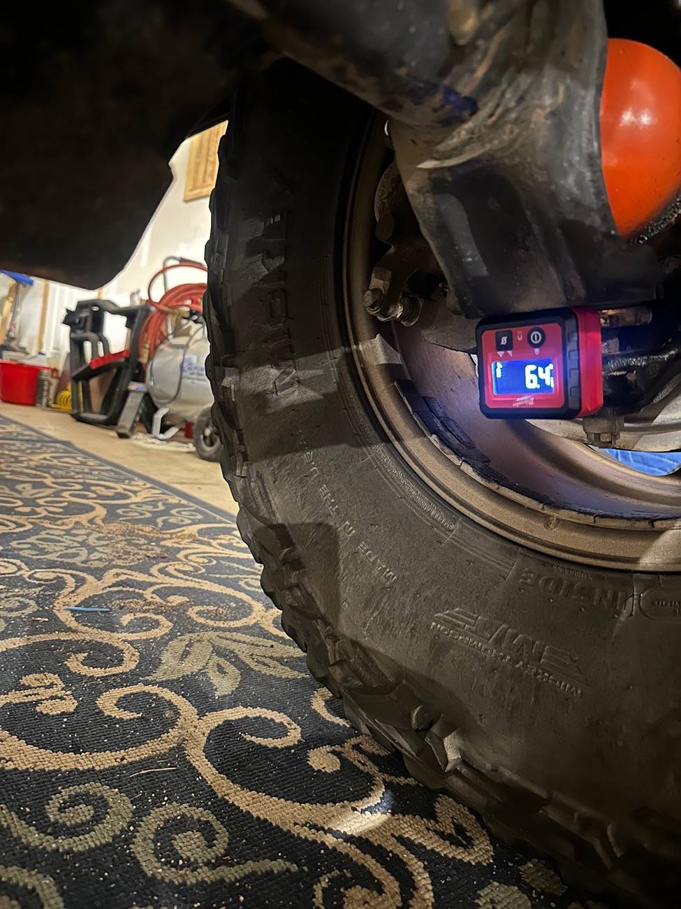

Can you snap a pic of your front diff/driveshaft from the drivers side wheel? Behind the wheel is fine. Using your angles in the pics, you either have 5.5* or 6.5* of caster. I couldn't tell if that 89.5 from the front casting was a half degree rolled forward or a half rolled down.
Sure. I’m pretty sure 6.5. I threw the angle finder on the driveshaft as well. It was less than I thought, but still pretty bad.
