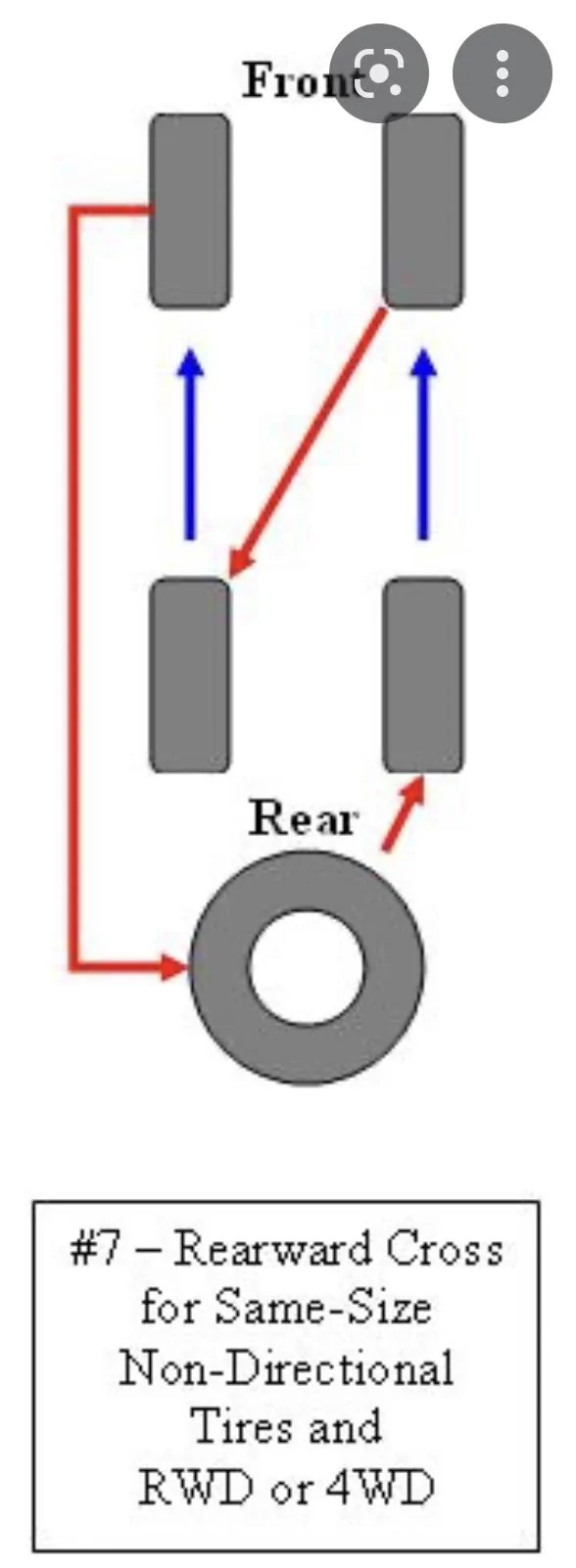

Here’s the pattern I use.
My dealer was all on board for a 5-wheel rotation last week (I bought 5 matching rims and tires when I upgraded to 35s) but they way they did it didn't match the diagrams I had seen online. They looked at me like I had seven eyes when I showed them a diagonal-style 5-tire rotation. What they did was front-to-rear (LF<->LR, RF<->RR) and then put the spare on the LR. They said they did this because of the wear indicators (spreading out the thicker treads?).
But how will they do it next time? I thought the rotation was not just for tread depth but also for uneven patterns that might come up d/t alignment issues, etc?
If this is a poor rotation pattern and I should re-do it, what's the best way? Or should I just not worry about it?

I had a similar conversation yesterday at a 4wp store in Denver. I was replacing a single damaged tire and asked their opinion for where to bring it into the rotation. When they realized I was doing 5 way, it went south fast. They just don’t seem to do them often, and there was no clear consensus. Three guys had three different ideas. I was due for a rotation at 5k anyway. I put the replacement where it’s predecessor was, then used my above pattern normally. The pattern I use is what discount tire publishes online for 5 way 4x4 vehicles.

Thanks. So does it make sense then to just start a regular 5-tire rotation in 5k miles, then?
WILDHOBO
Sep 24, 2021
80
12,997
20,029
2021 Gladiator Rubicon
Network Engineer
I do them every 5k. Recommended for passenger cars used to be 6k or so, but these wear faster.
