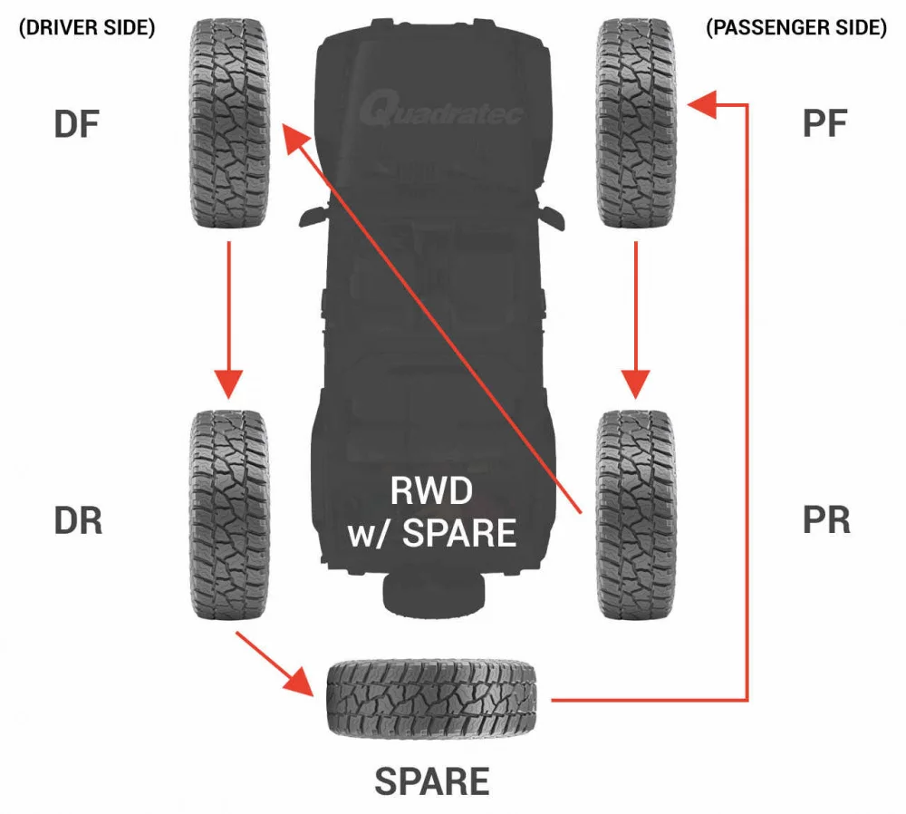

You will lose some clearance with a wider tire in the under bed carrier.
I have a matching spare and use this rotation pattern...
Jeep Gladiator Tire rotation with spare jeep-5-tire-rotation-V1

Thanks for the diagram I am getting ready to rotate my spare for the first time on a new set of tires including the spare of the same size. I am currently running 35’s with no issues with the slight protrusion.
