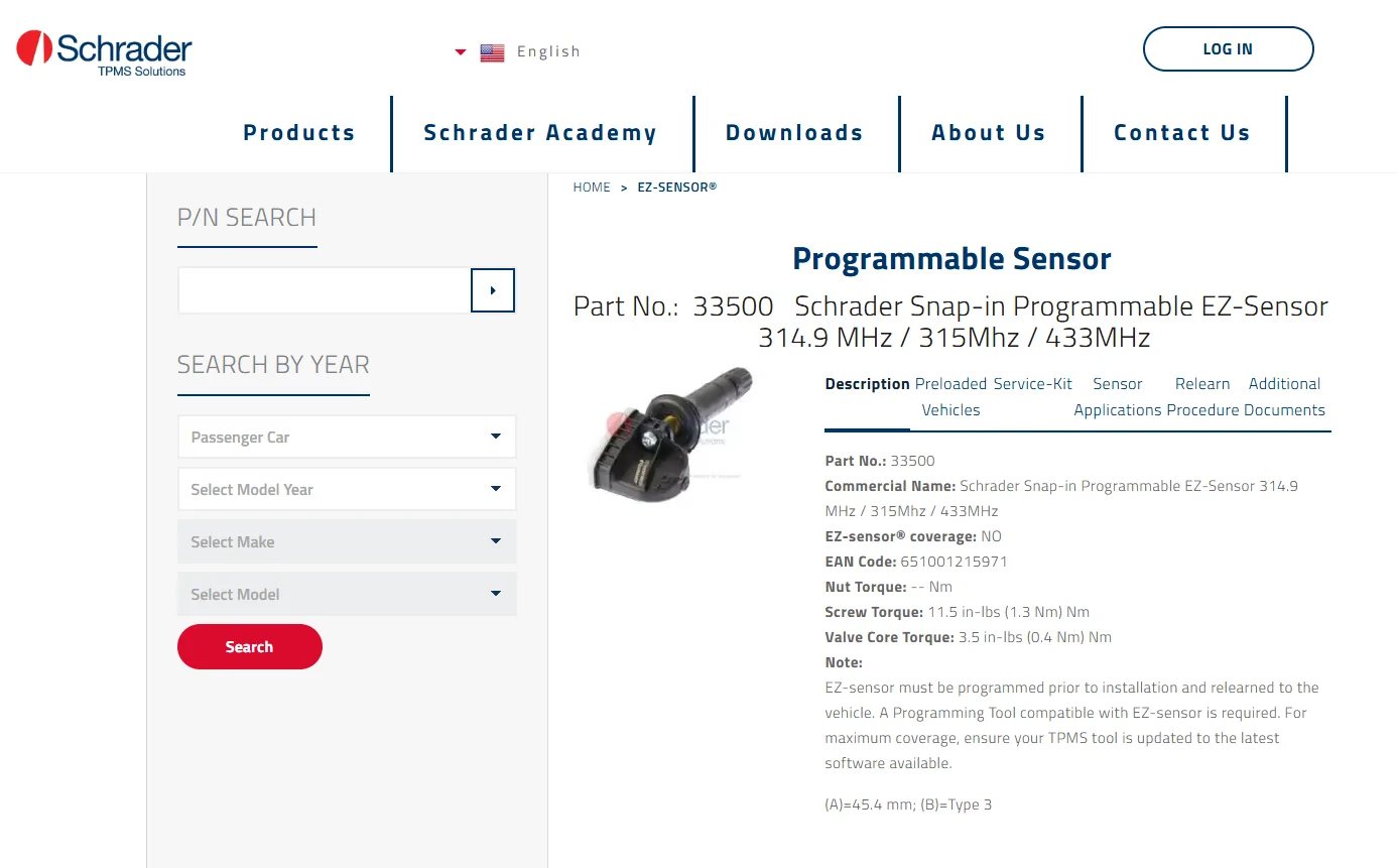

The ones I bought have three different frequencies they can operate on. 314.9 MHz, 315MHz and 433MHz. So they had to be programmed to the correct frequency that Jeep uses. Which would be 433MHz for 21 and newer JL/JT. Also the MOPAR sensors are made by Schrader, just without the upcharge.
Wow, they've come a long way!
Let us know how the battery life is.
It takes a lot to get multiple frequencies and good battery power in these - shocked at the low cost.

I was actually a bit surprised. I had read that it might take a few miles of driving before the would register. Something about syncing up or whatnot. These registered instantly.
40,442
53,859
Mine always synced up within a quarter mile.
