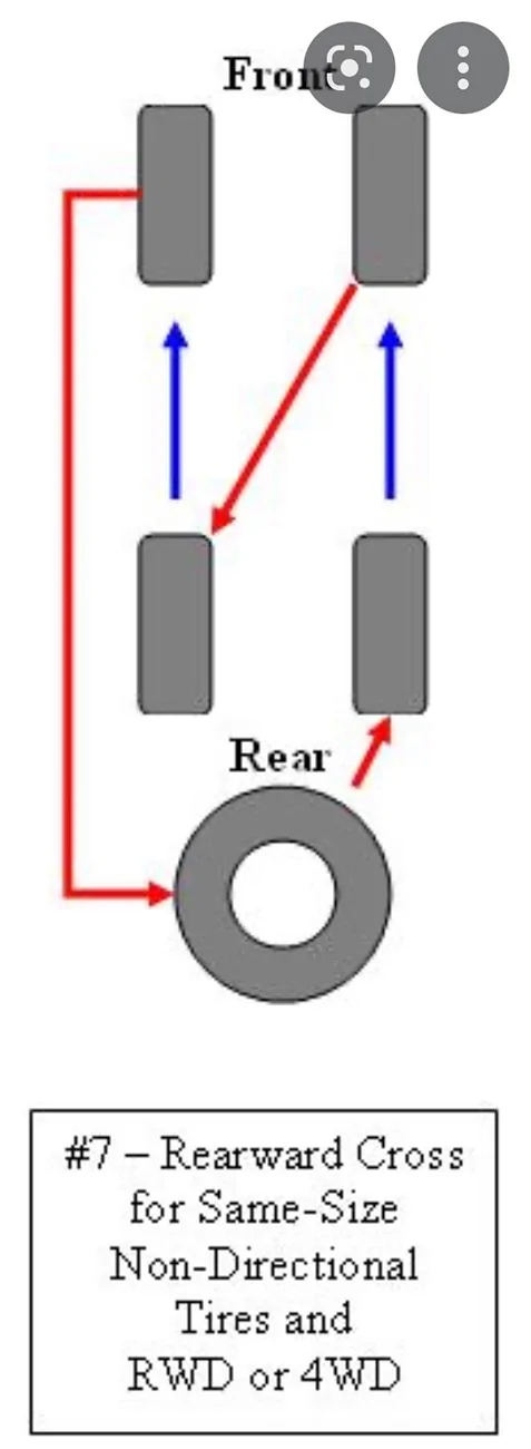

This is my 5 way pattern. I only raise one at a time this way. I don’t know if I’m right or wrong. I just looked it up as a 4wd pattern.
I'm not sure as you mention that there is a "wrong" way to rotate tires if they all get moved in a consistent pattern that gives each tire (after a complete rotation) the same amount of time at each location on the vehicle.
I could be wrong but don't see how the tires would know the difference if in the end if they all spent the same amount of time in each location on the vehicle.

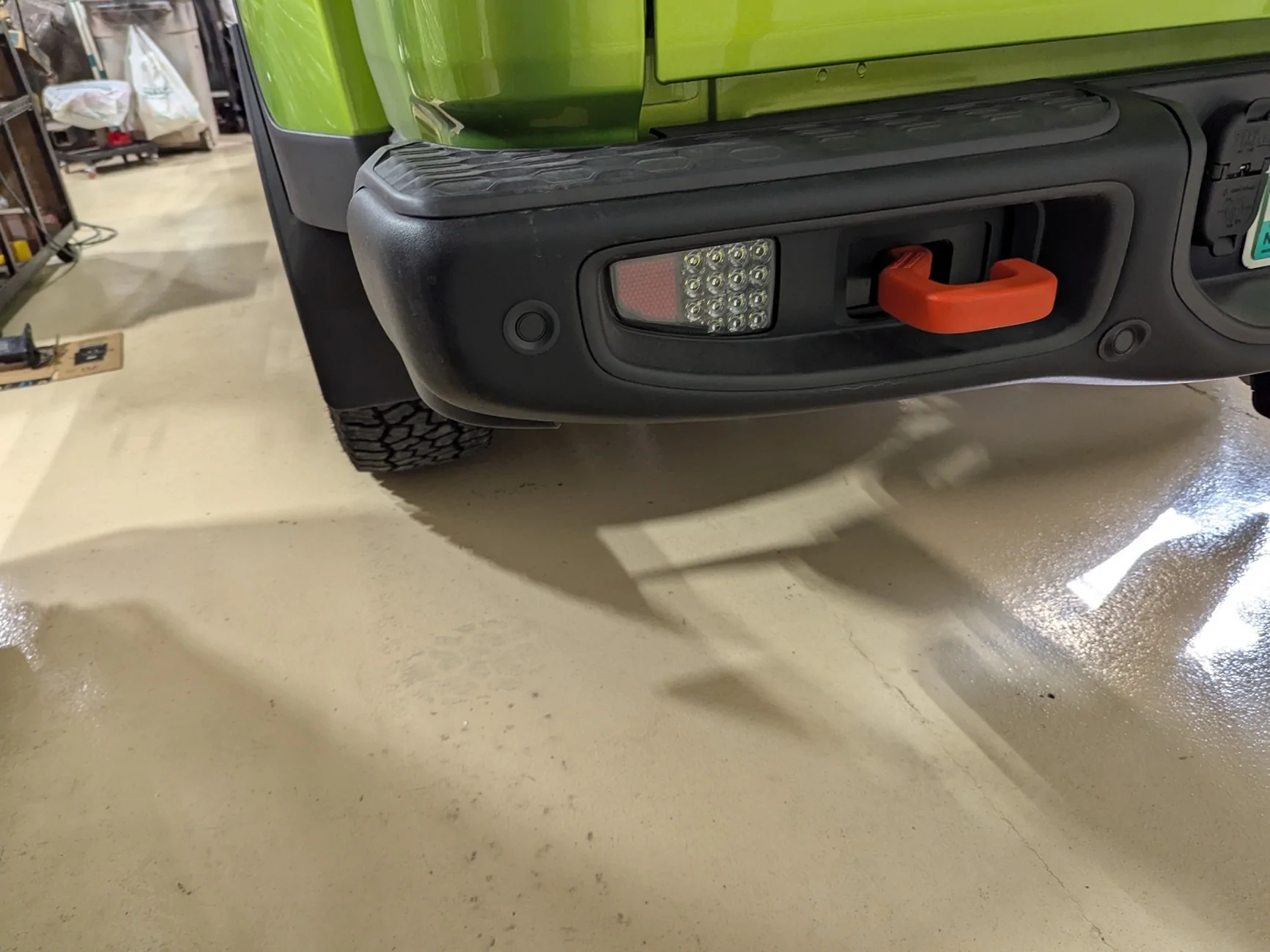

I have a heated shop (AC in the summer) with a swept floor...
I sit on a rolling mechanic seat for part of the work and use floor jack, no reason to really crawl under it.
Not a lot of brake dust on my wheels. Of course, before I work much on it, it gets washed
