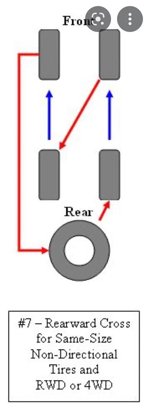

I always put the face of my rim facing down underneath, the wheel remained fairly clean and it was never an issue of too much extra time to put it on. The benefit of longer tire life between purchases far outweighed the Fobs to me.
Additionally, I contacted Mickey Thompson and they sent me this rotation guide. They also connected me with one of their techs and the calculated the best tire pressure for me to get the most amount of tire life out of my tires. They also said Don’t rely on a chalk test for Bias Ply Tires, as it doesn’t work for them.
I had the same conversation with them a few years ago. Chalk tests are not the best all end all.
WILDHOBO
Sep 24, 2021
77
12,407
18,965
2021 Gladiator Rubicon
Network Engineer
Easier to do a 5 way than a 4way? Huh??
I guess it depends on how you do it.
I only swap wheels front to back and back to front. I never move the wheels to the other side.
Why would you not unless you have directional tires?
