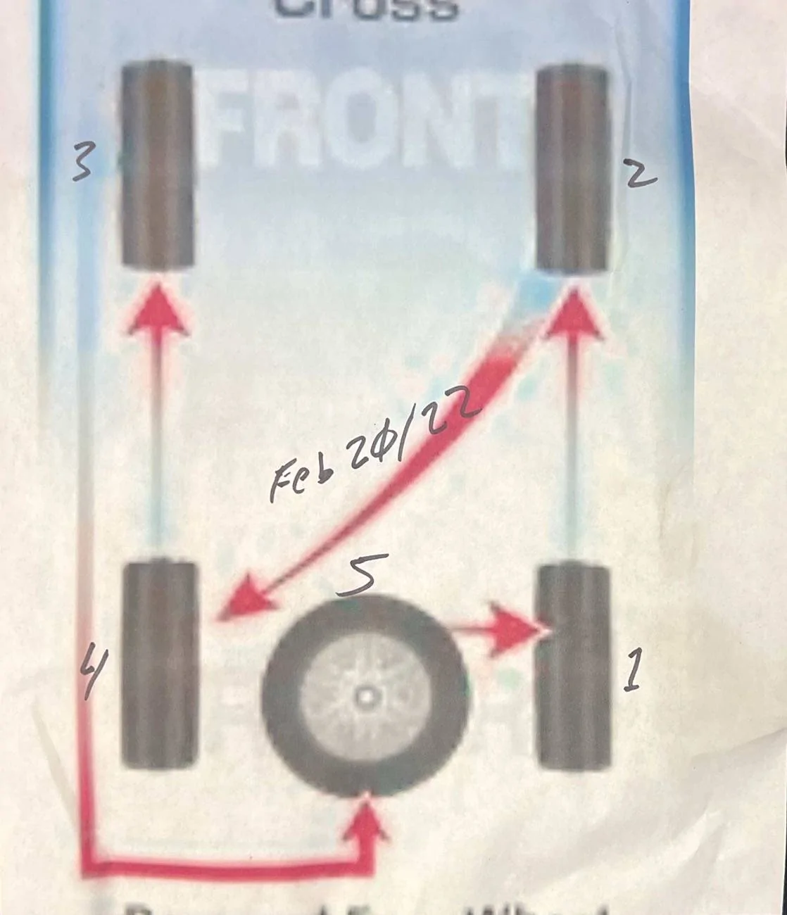

Additionally, I contacted Mickey Thompson and they sent me this rotation guide. They also connected me with one of their techs and the calculated the best tire pressure for me to get the most amount of tire life out of my tires. They also said Don’t rely on a chalk test for Bias Ply Tires, as it doesn’t work for them.
Jeep Gladiator 5 tire rotation discussion IMG_2754
