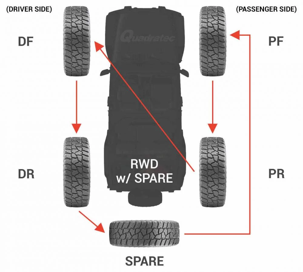

My routine is slightly different.
Thanks for sharing this diagram. It aligns with Zachanadandy's suggestion: "If I had a rear LSD I'd have to make sure the spare ended up on the front...". Also see Zachanadandy's comment in post #102.
This five-tire rotation method is suitable for vehicles with Trac-Lok limited slip (LS, or LSD) anti-spin rear differential. Please add a comment if this applies to other (LS) differentials on the Gladiator.

Thanks for sharing this diagram. It aligns with Zachanadandy's suggestion in reply #30 in this post: " If I had a rear LSD I'd have to make sure the spare ended up on the front...".
This five-tire rotation method is suitable for Trac-Lok limited slip (LS, or LSD) anti-spin rear differential. Please add a comment if this applies to other (LS) differentials on the Gladiator.
Did not realize LSDs can factor into how the spare is brought into the rotation.
It's not critical, but you want your tires as close to even as possible with a LSD. Would it hurt anything? Probably not. Why risk it though? I'd just stick with 4 tire rotations with a LSD, and if I needed to use the spare it would go on the front.
