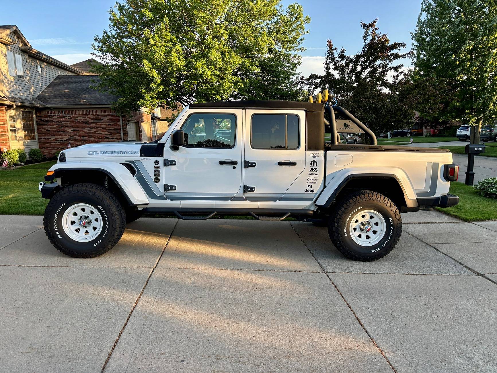

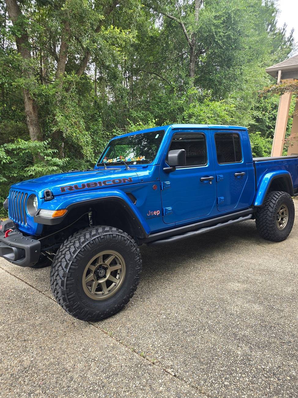

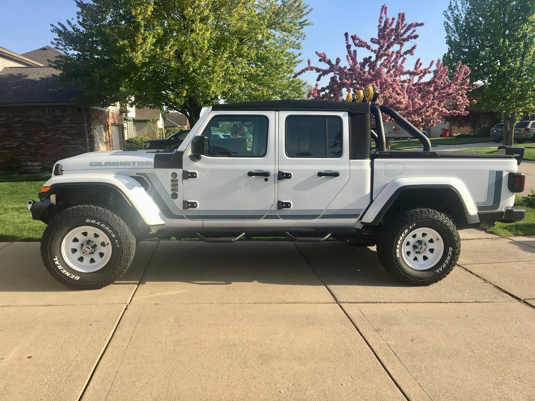

Mopar kit, no spacers. Here's the difference between 35's and 37's (if your interested).
Top pic with ATX's are 35's and bottom pic are BFG KO2's in 37's.
The Mopar kit will get you about 3 inches and some change on sport models. I was bummed when my 35's looked a little small, but I loved the tires and ran them for almost 5 years and 55K miles before getting the BFG's a few weeks ago.

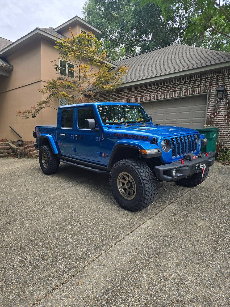

Here's mine with Clayton 2.5 lift and 35s
likes- that’s a nice setup. There’s space between the top of the tire and the fender without the tires being out of the fender wells which is the mall crawler look
dislike- why do all the setups I like have to be in blue? Does everyone here know that I wanted the blue but couldn’t find it.

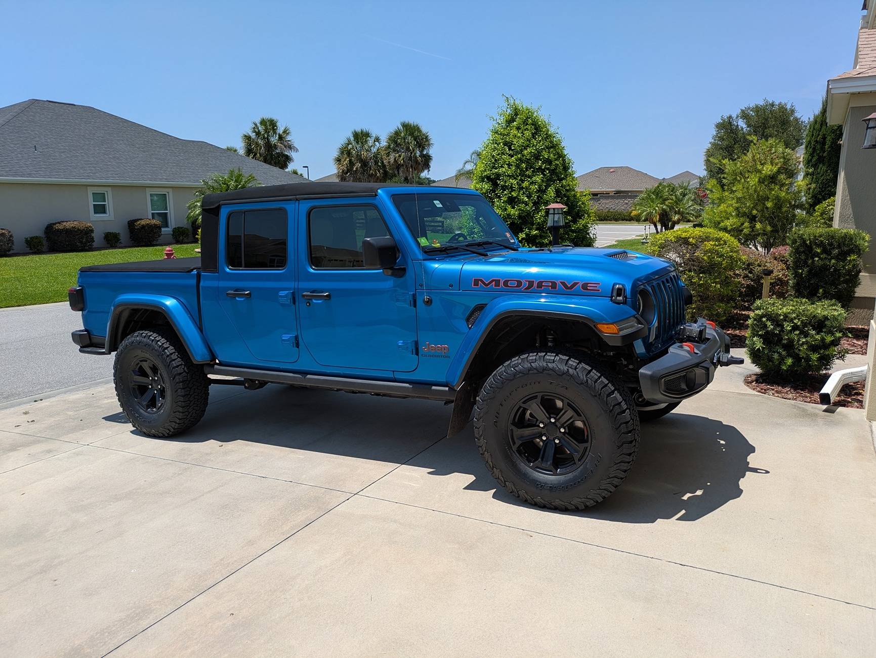

Just to rub a little more salt in the wound...................................2" AEV Lift and 37x12.5 BFG KO2
I thought this place was supposed to be a brotherhood. Am I now the baby brother that gets picked on by all the blue boys?

Love those retro graphics. where did you get them?
