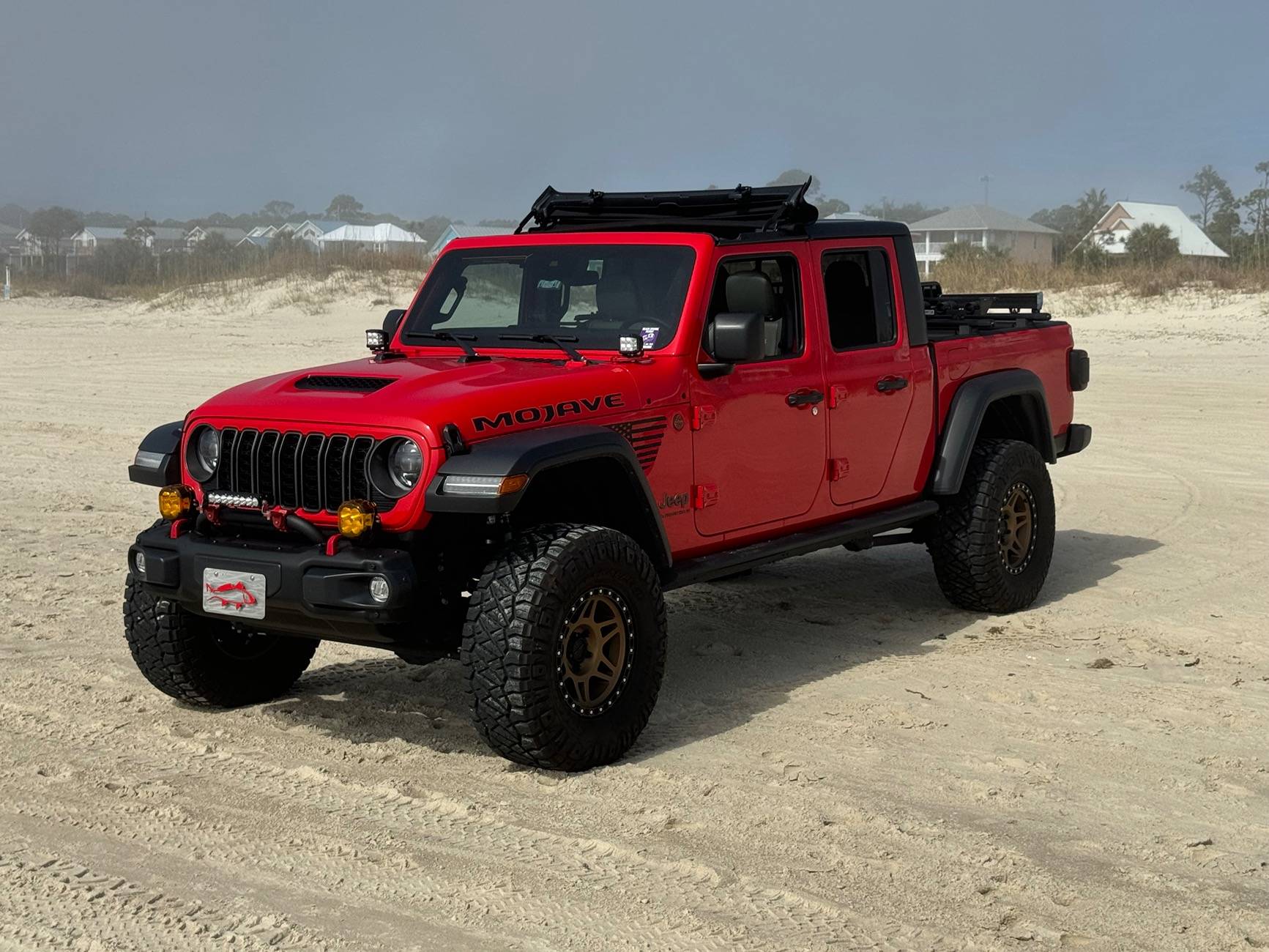

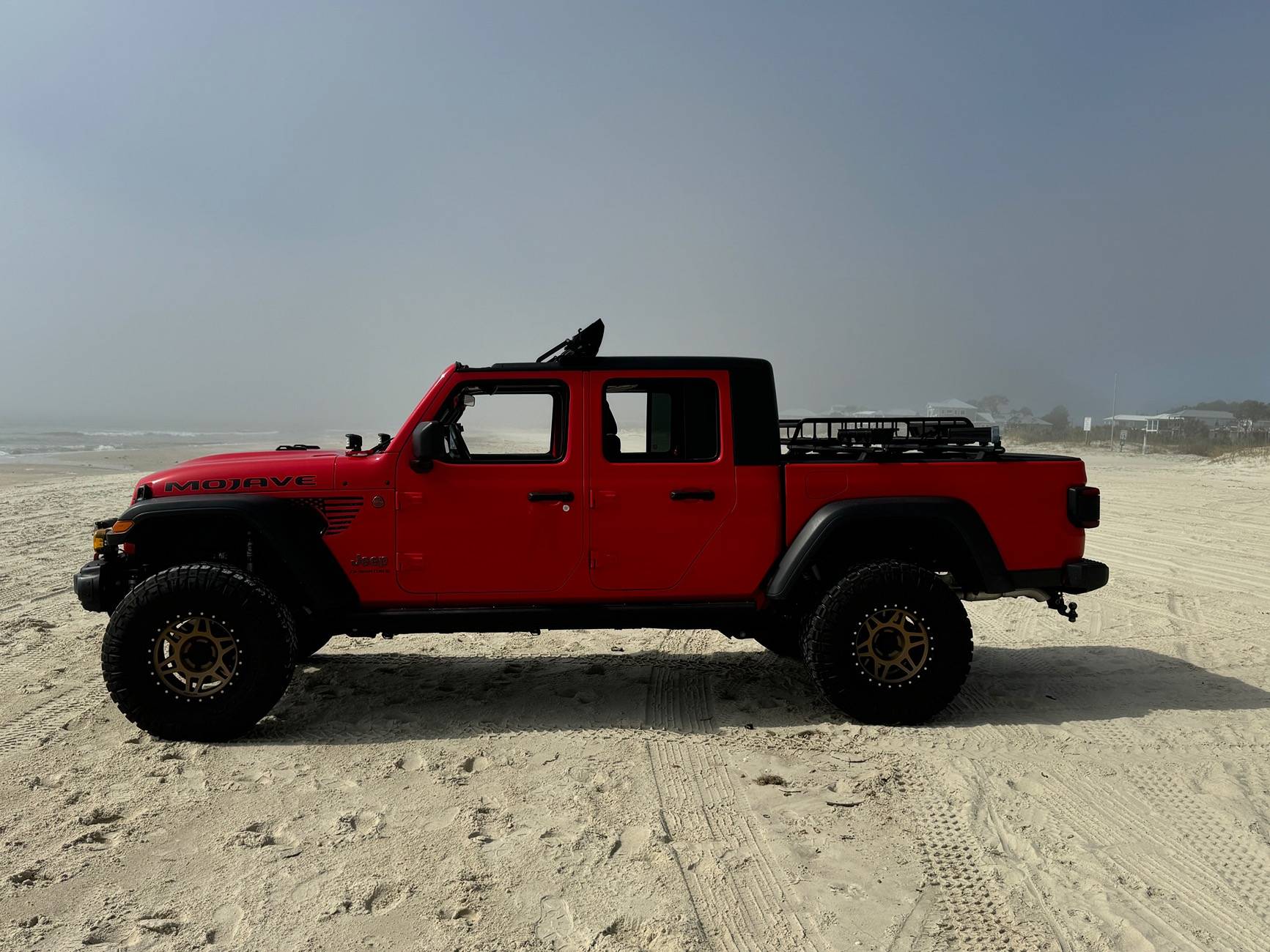

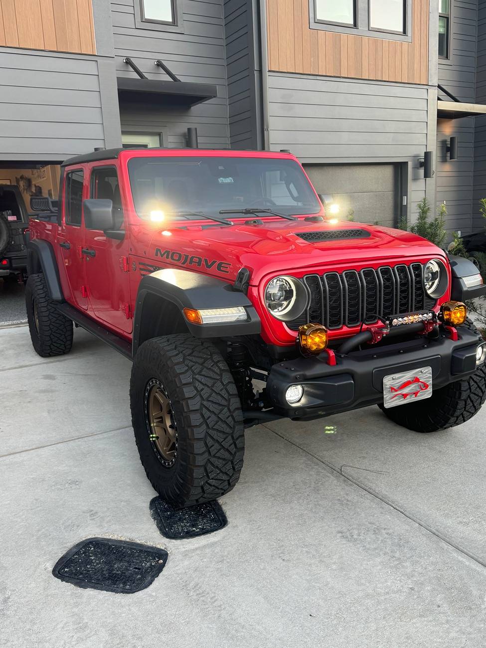

Mopar lift with Bilsteins, surprisingly got just over 3 inches out of it. 35x12 Nitto Ridge grapplers, no front level spacer, don’t think I need it

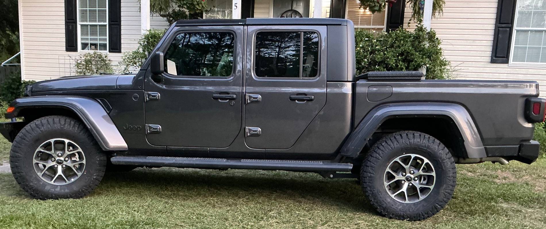

So here’s what I ended up doing. 35x11.5x17s. BDS 2” lift and level kit goes on next week. Other than a borla exhaust, I think I will be done. With no more “playing in the dirt” I will be doing, I think I will be good. Thanks for all the info guys.

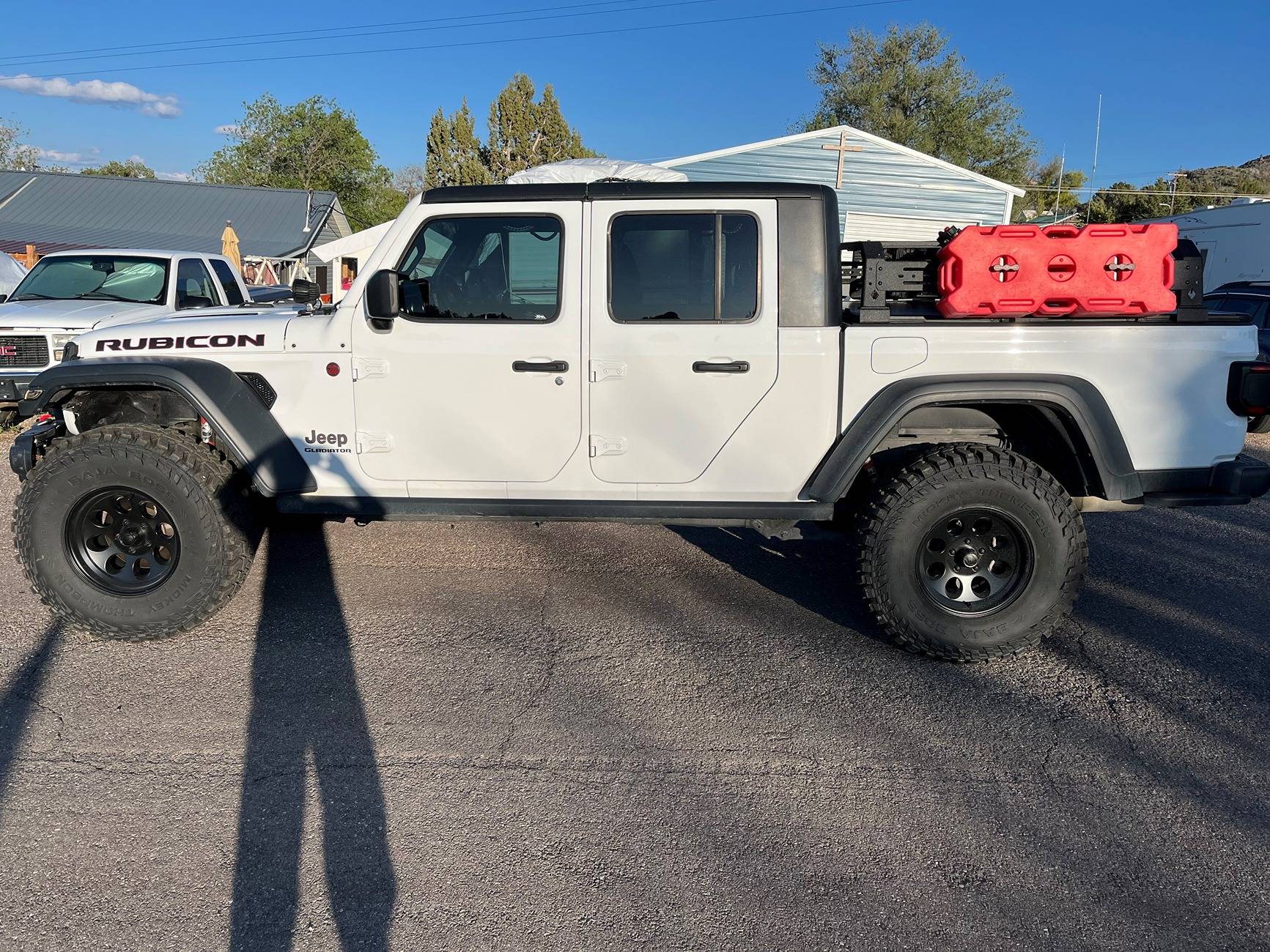

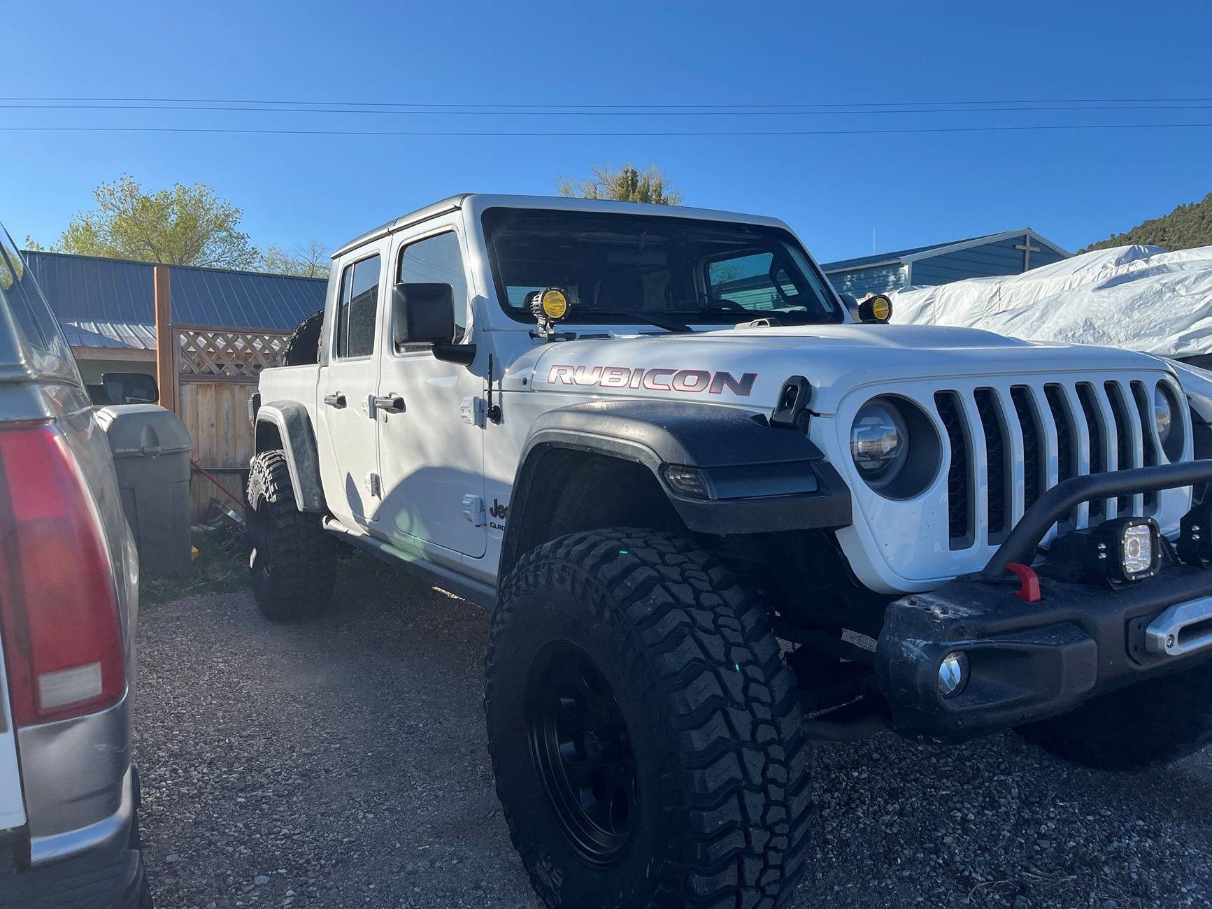

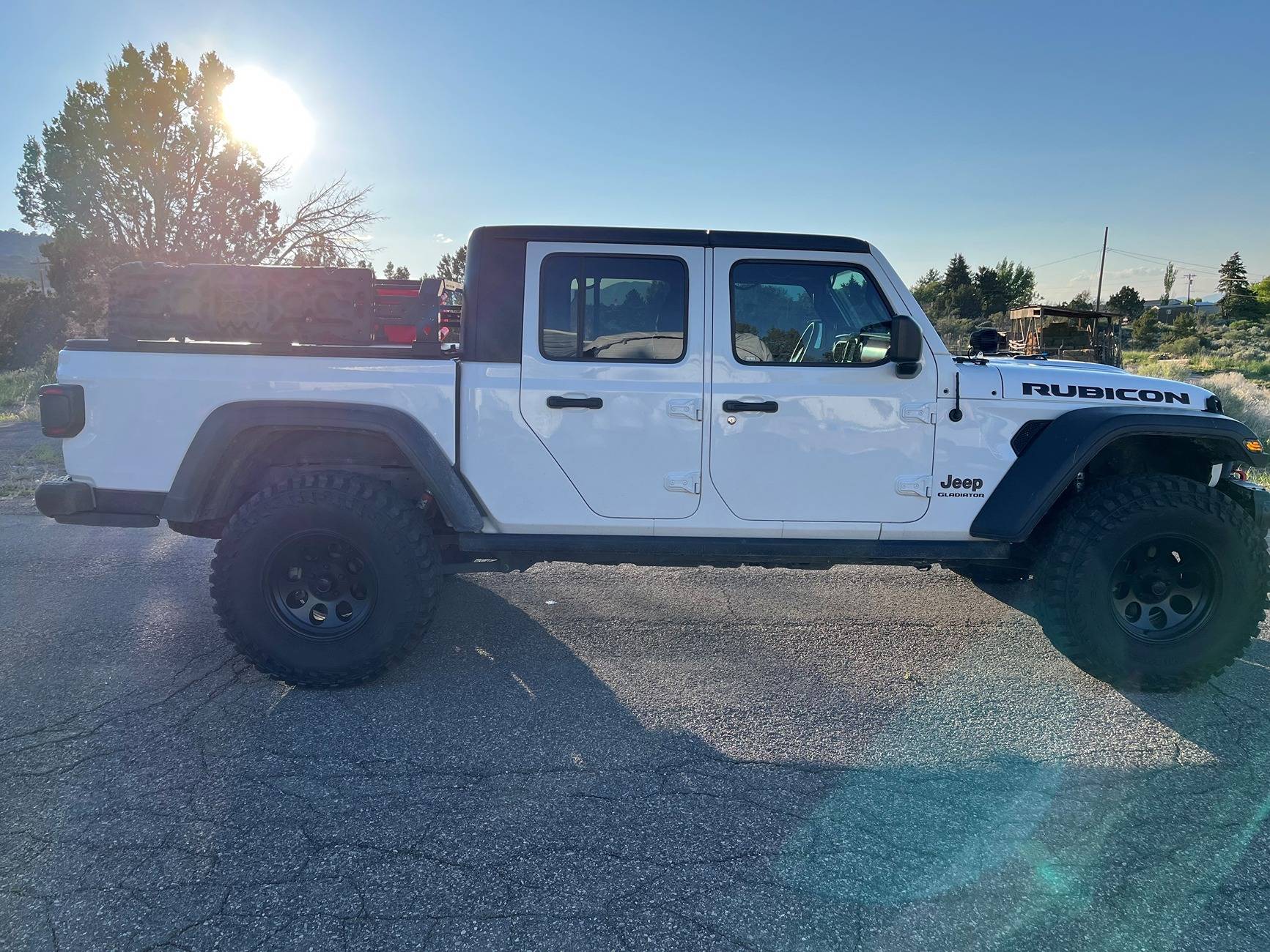

Here's mine with a 2" AEV Spacer lift (for now) and 37'' Mickeys

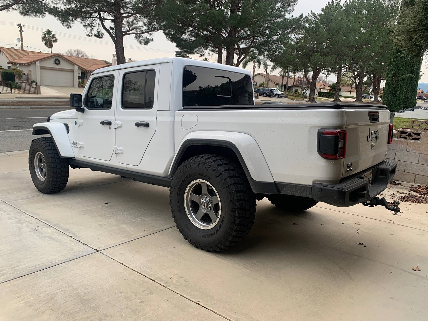

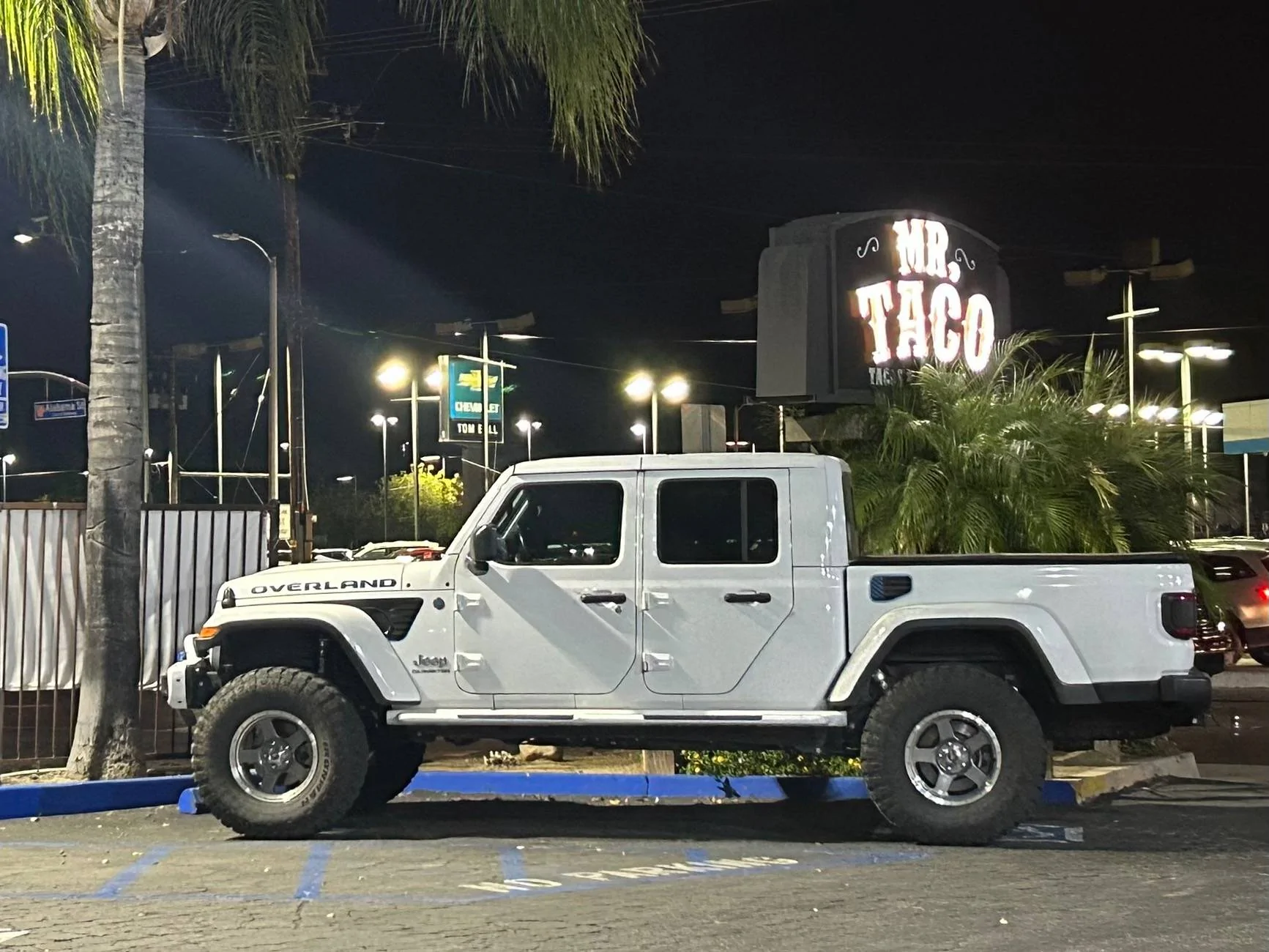

Personally I wouldn’t go more than 2.5-3” on 35s, and even that is stretching it. Then again, I also wouldn’t run 35s on a gladiator when 37s are available 😂
Leveled and 37s
4.5” front, 3” rear and 37s
I don’t think a 35” tire would look good at all on a lift this tall.

What brand and width 37 you rubbing in this picture? Thanks
The tires in these pictures were Ironman All Country MT tires, 37x12.50r17 and no rubbing on 17x8.5 -6 offset wheels. I never wheeled it more than just dirt roads and fire trails but I knew I’d be lifting shortly after leveling so I went cheap. I’m on Toyo RT Trail tires now and they’ve been amazing.

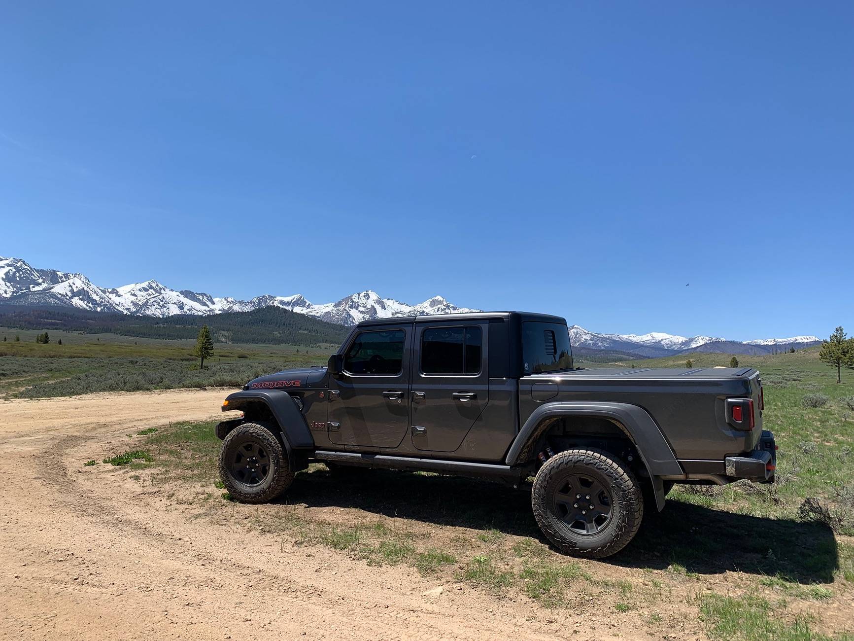

I just had the AEV 2" lift installed on my '23 Mojave. I'm still running the stock 285/70's which will be upgraded to 35's at some point. I decided on the AEV kit as I won't need anything larger than a 2" lift and, with the Mojave's stock Fox shock system, I would've had to have spent a lot more money for upgraded shocks anyway. If you want to run larger than 35's you'll probably need to install a 3 or 4" lift kit.

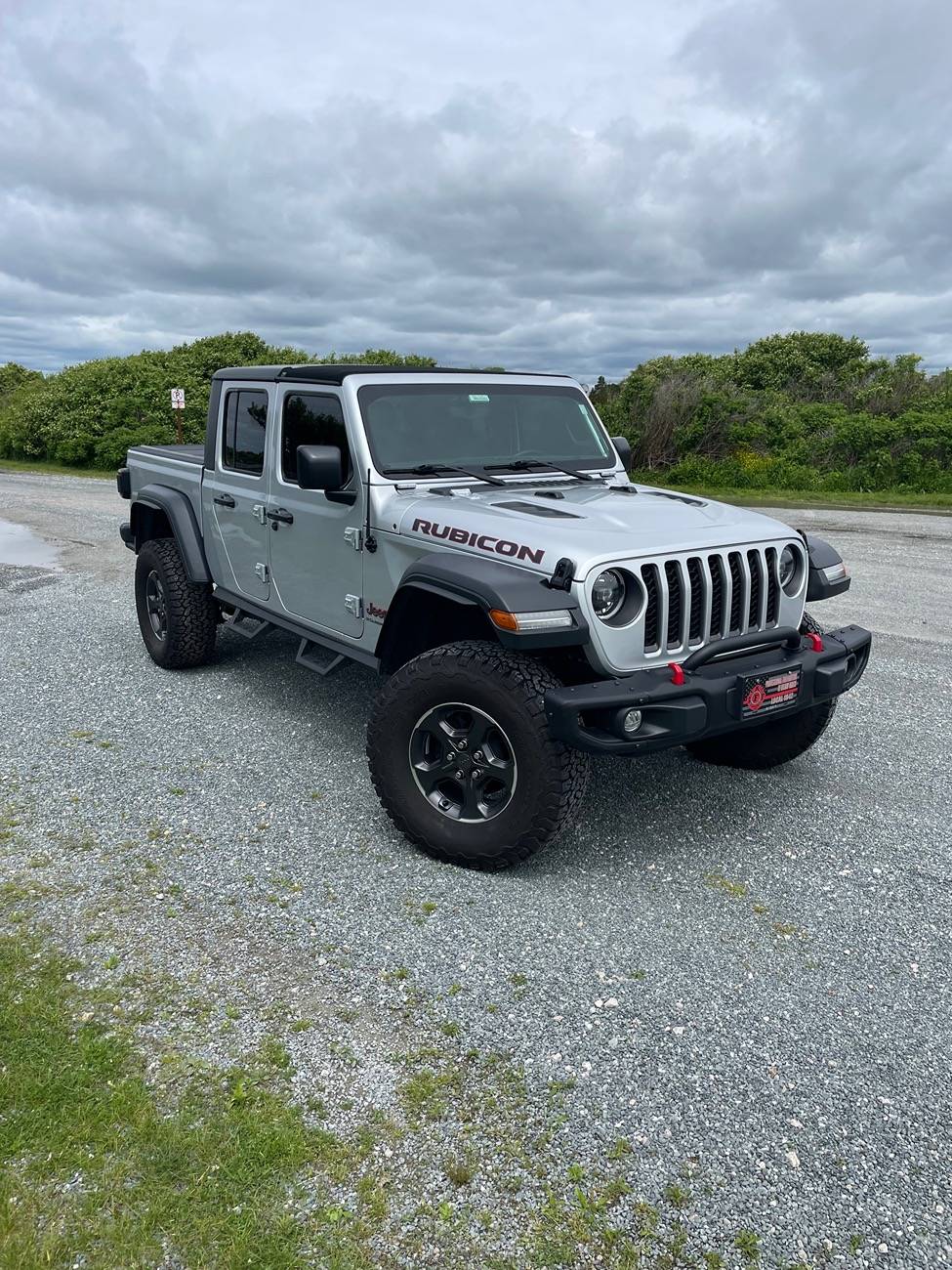

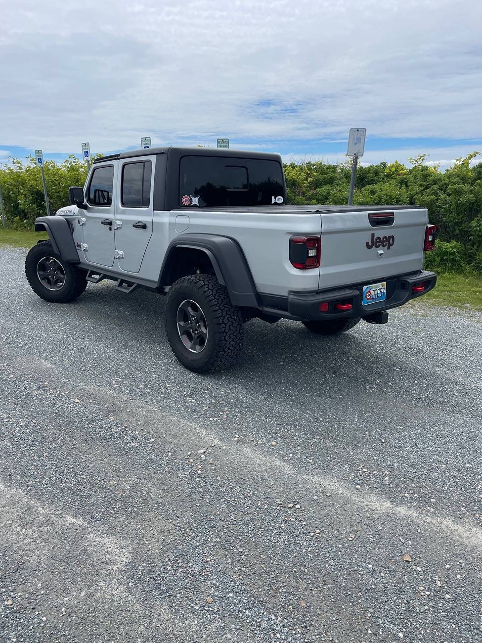

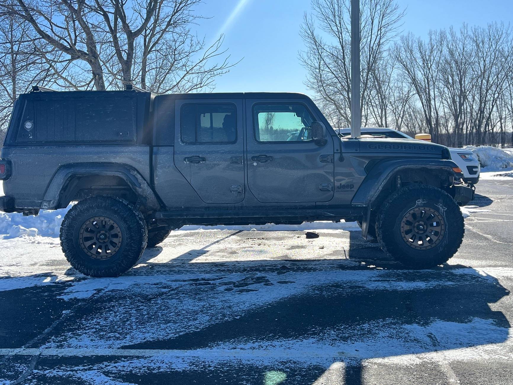

2” Mopar lift on 35’s
Jeep Gladiator Tires and Lifts IMG_4077
Mopar lift with Clayton 2.5” HD coils on 37’s.

I was looking to do this exact same setup with my Rubi but have concerns on it fitting in my garage. Would you be able to tell me the height of the roof?

I have a small garage door on the town home and high ceilings, the door opener is pretty low but mine fits no problem, I will get some exact measurements on door height, lowest height of the opener arm, and roof height of the Jeep when I get home

Stock, I think the Mojave is 1.5" (or so) taller than the Rubicon.
