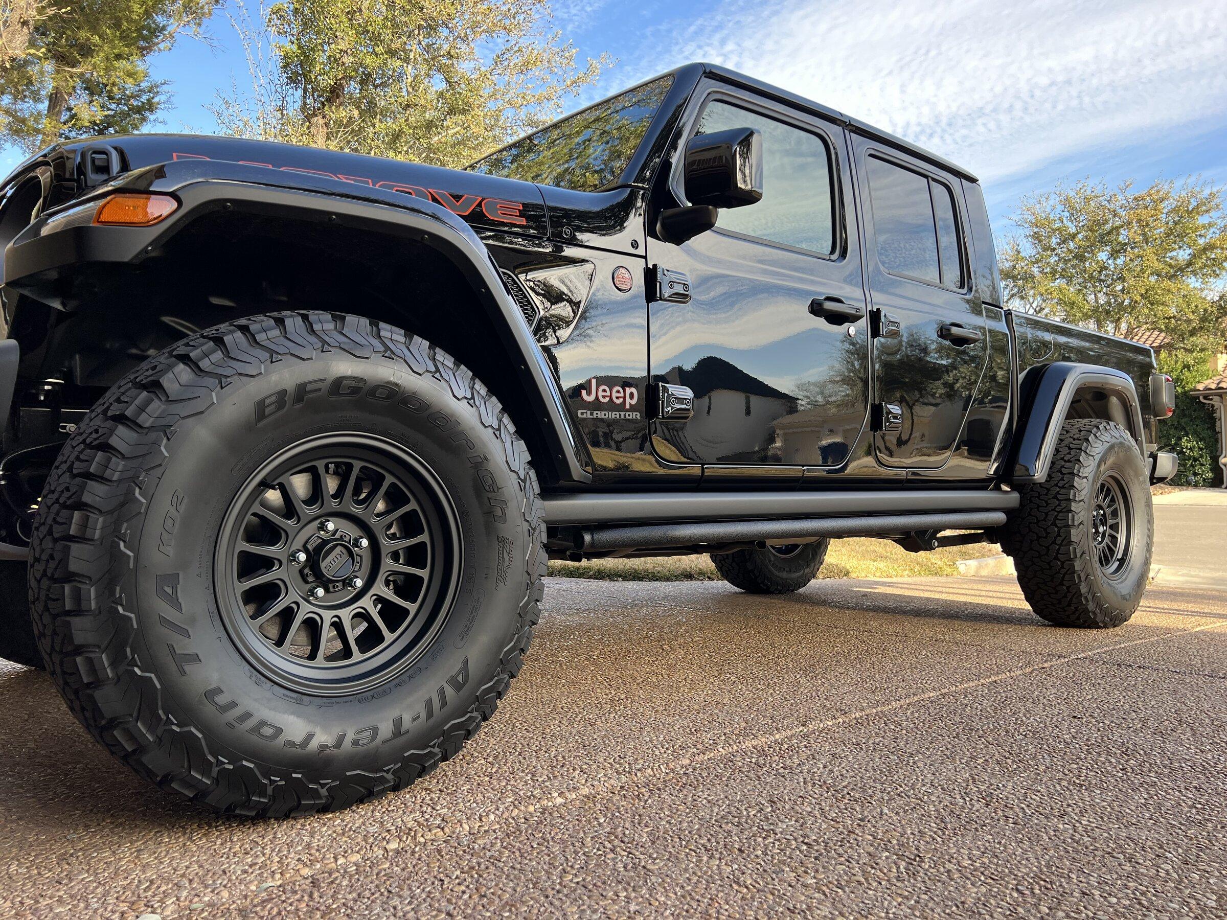

Yes, tested against 2 GPS apps and several roadside speed-checker stations.
When I shopped for my wheel/tire combo, I specifically searched for the lightest setup I could find in my budget. I don't recall exact #s but my new wheel/tire combo is +-3 pounds from stock. I'm sure this is helping my situation.
I'm running my stock wheels which are lighter than pretty much any after market ones. Also my Kanati's are about the same weight as the BFG KO2s your running, yours are 71 lbs a piece, mine are 72. That's not going to make a 2 or 3 mpg difference. I baby mine as well. If this is true you would be getting better Mpgs than one running stock wheels almost and be on 37's? How's that possible?

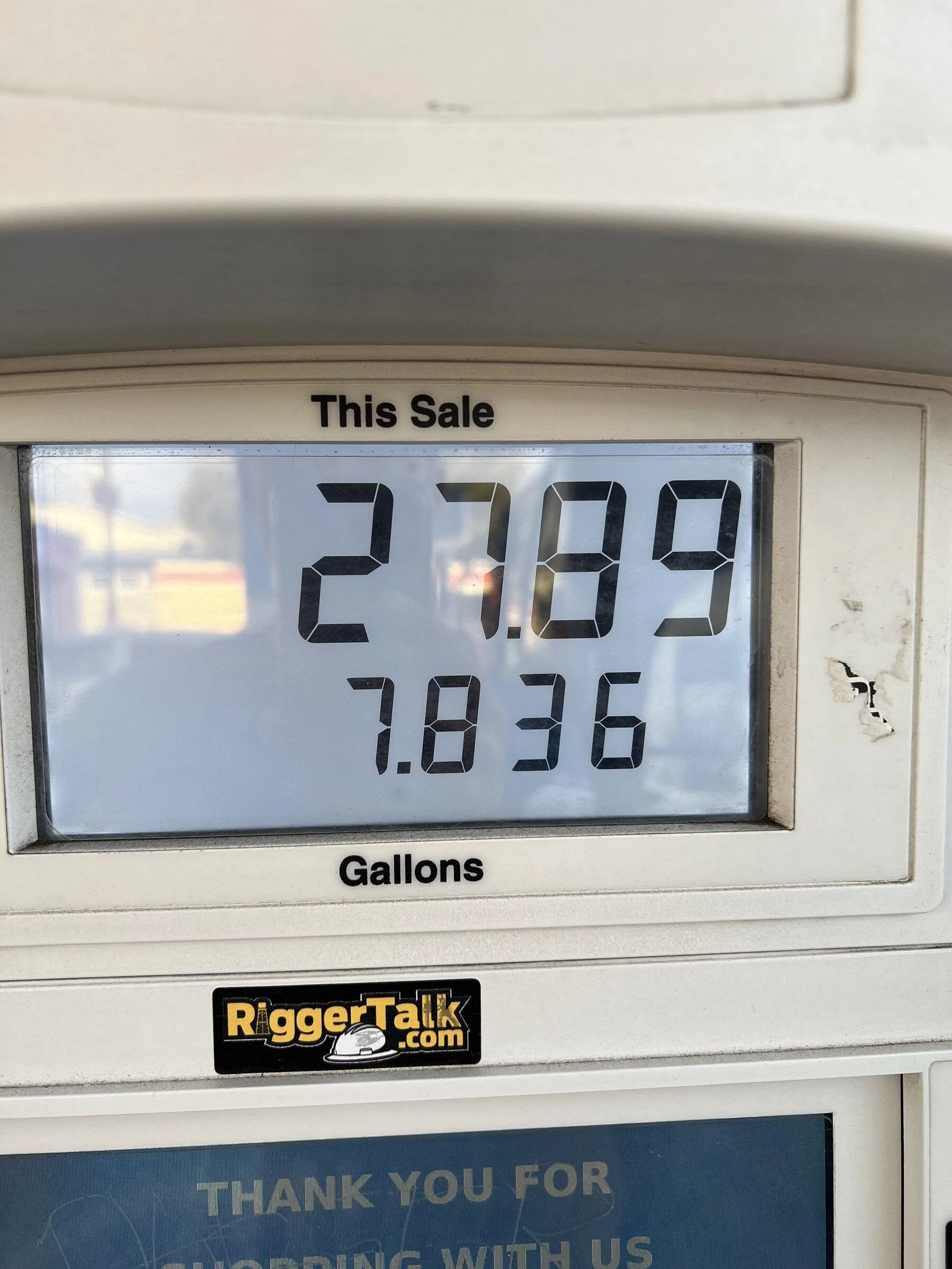

I updated the post with the final numbers for the round trip and included the refuel. This allowed me to get the actual MPGs for the trip.
I wish I would have refueled once I got into Austin. I decided to see what the actual MPG was for the trip. I updated the post with the info.
