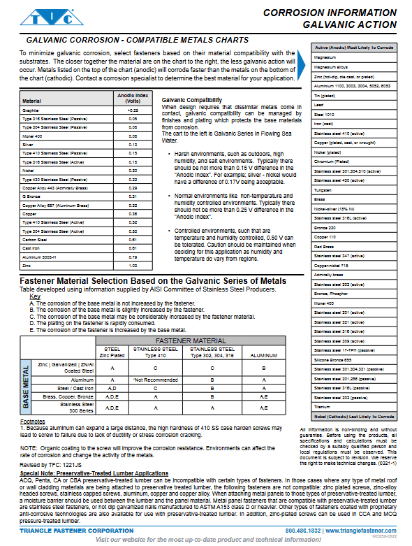

Just be sure to have those nuts tested -
Who has it correct - hoomons, or.......Ferengi?
40,490
53,988

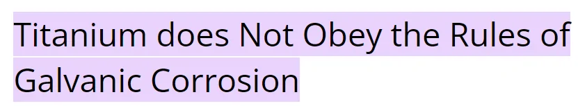

Except that titanium doesn't follow that chart or the rules. It's not efficient at reducing dissolved oxygen, so you don't get the same reactions as you would with other metals against steel.
So far I've never seen anyone talk of corrosion on lug bolts due to titanium lug nuts.

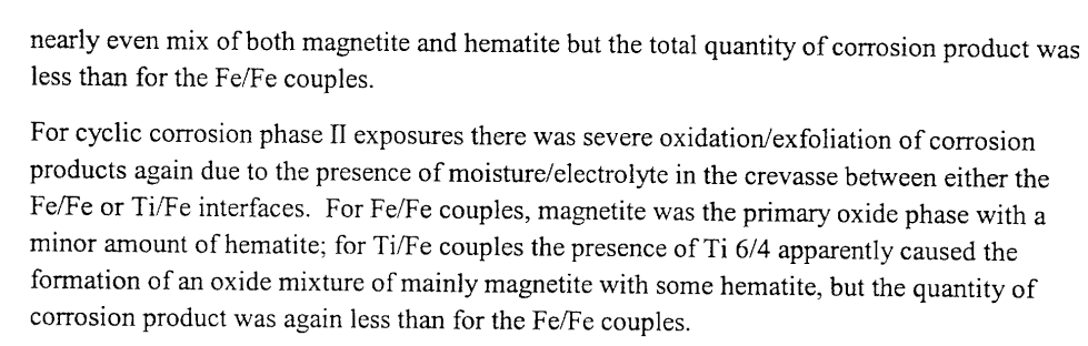

Anyway, in checking my gut feeling on titanium and double-checking myself before responding, I ran across this -
Jeep Gladiator Titanium Lug Nuts... Worth their weight in gold? 1687183450565
Jeep Gladiator Titanium Lug Nuts... Worth their weight in gold? 1687183677000
This testing for the military showed less problems between a Ti/Fe joint than a Fe/Fe joint.

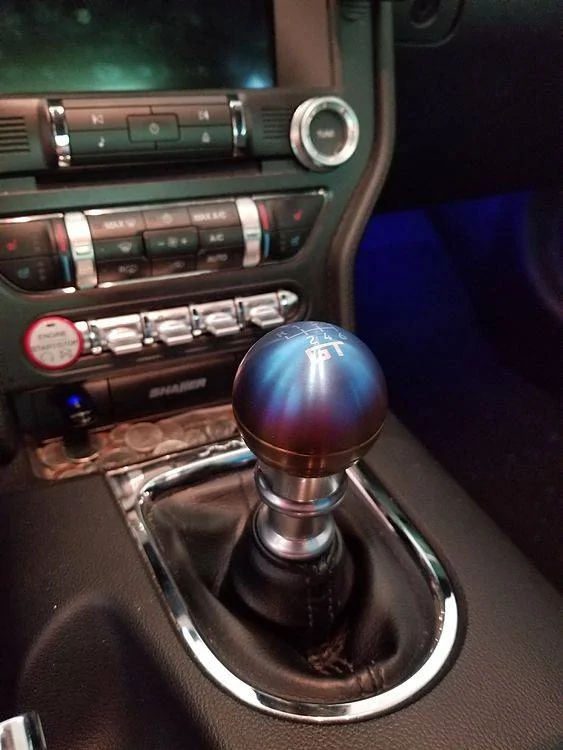

They look cool for sure. Had a Titanium shifter in my Mustang GT.
Jeep Gladiator Titanium Lug Nuts... Worth their weight in gold? 20180728_104345
