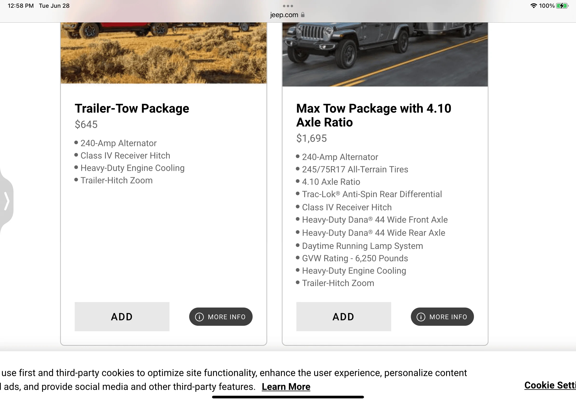

Definitely get Max tow if not getting a Rubicon/Mojave. One thing to watch out for the early Max Tow didn't come with trak lock/limited slip it was a $995 option then. I think sometime mid 2020 the trak lock was included and the price was raised to $1295/1495

Sport S with Max Tow here too. My last two Jeeps before this were a 2008 JKUR, and a JLUR(stick). The Max toe with the 4.10's outperforms my last two by far. Had to bump to 5.13's on my JKU. I do not feel the need right now. All 3 are on 35's. I also like the 8 speed auto better than I liked the 6 speed manual in the JLU. Just don't do a leveling kit if you plan to off-road. You'll need a mild lift. I have a leveling kit and front tires rub when I'm on the beach and that's not putting it through anything.

Max Tow here with 3.5 lift, 38's, limited slip, and stock gearing. I have done several of the well known wheeling spots in UTAH/AZ and put simply, this build has taken me anywhere I want to go. In 2 years of ownership I have not missed the lockers. Examples: I've followed two Wrangler's exact wheeling lines at Moab Utah's Hell's Revenge and done steep rock climbs in Sedona, AZ's Broken Arrow. There are some challenging paved roads with steep grades near me in AZ/California and I am glad that with the MT I don't have to worry as much, if at all, about overheating. With the money I saved in comparison to other trims I had in my list, I spent that on the lift and wheels. For me it has been worth it.

Yes, absolutely max tow. Not getting it was my biggest mistake in purchasing. This package is hands down the best value you can get from the factory.
The late 2020 got the Trac-Loc as standard in Max-Tow, I'm of the lacking Trac-Loc Max-Tow crew. :headbang: I've had great experience with Trac-Loc in 3 different Jeeps. Depending on how things go I'll hopefully get a set of lockers for my JT. If I had the Trac-Loc I'd be happy with that then a front locker. Road manners in my XJ's and LJ never been a problem.
