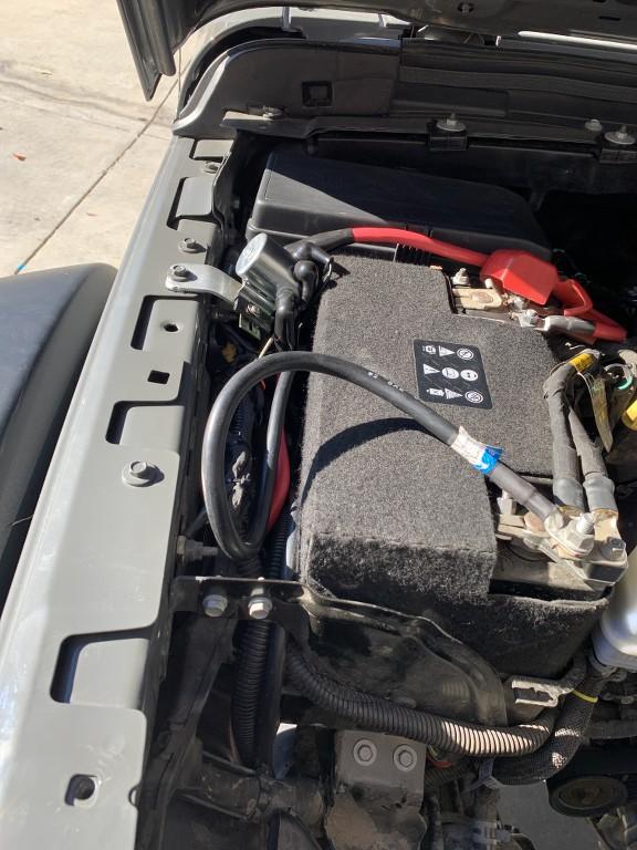

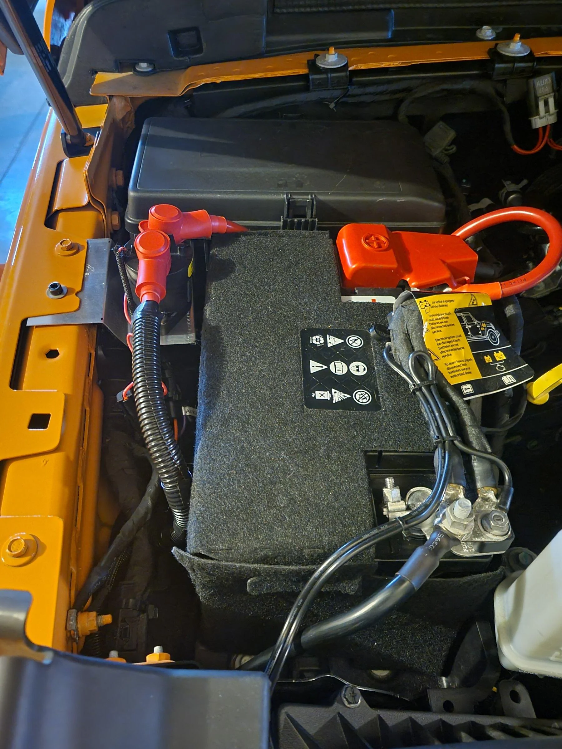

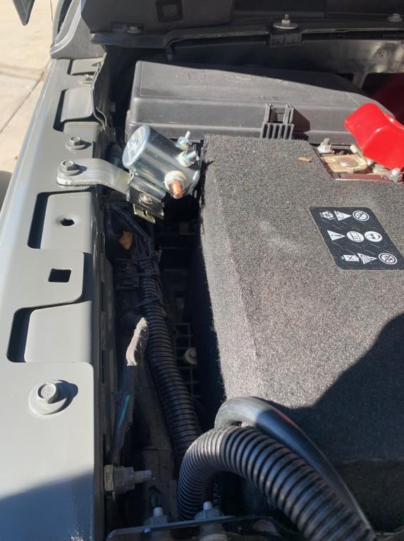

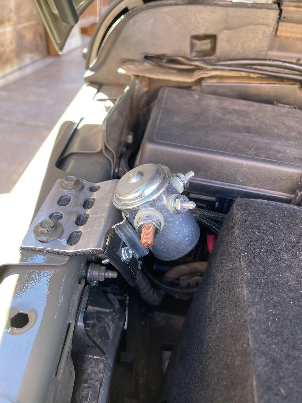

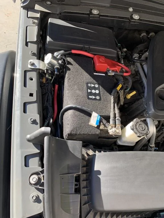

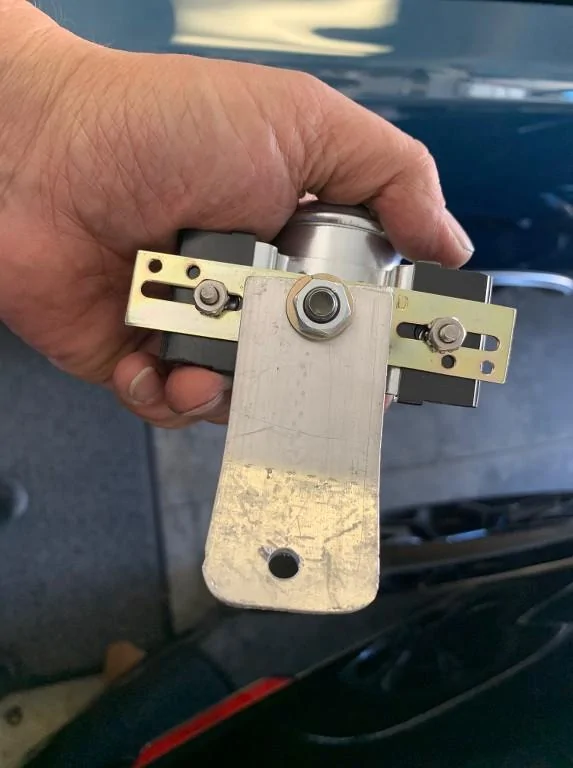

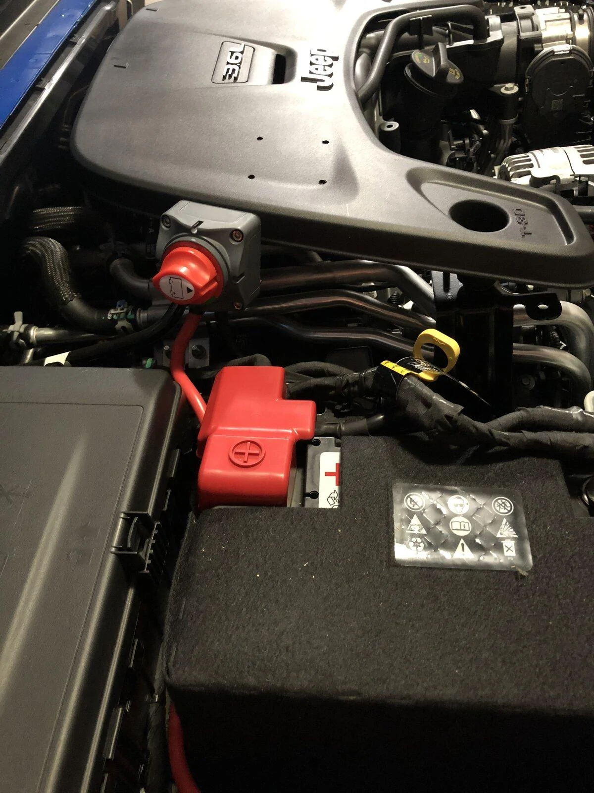

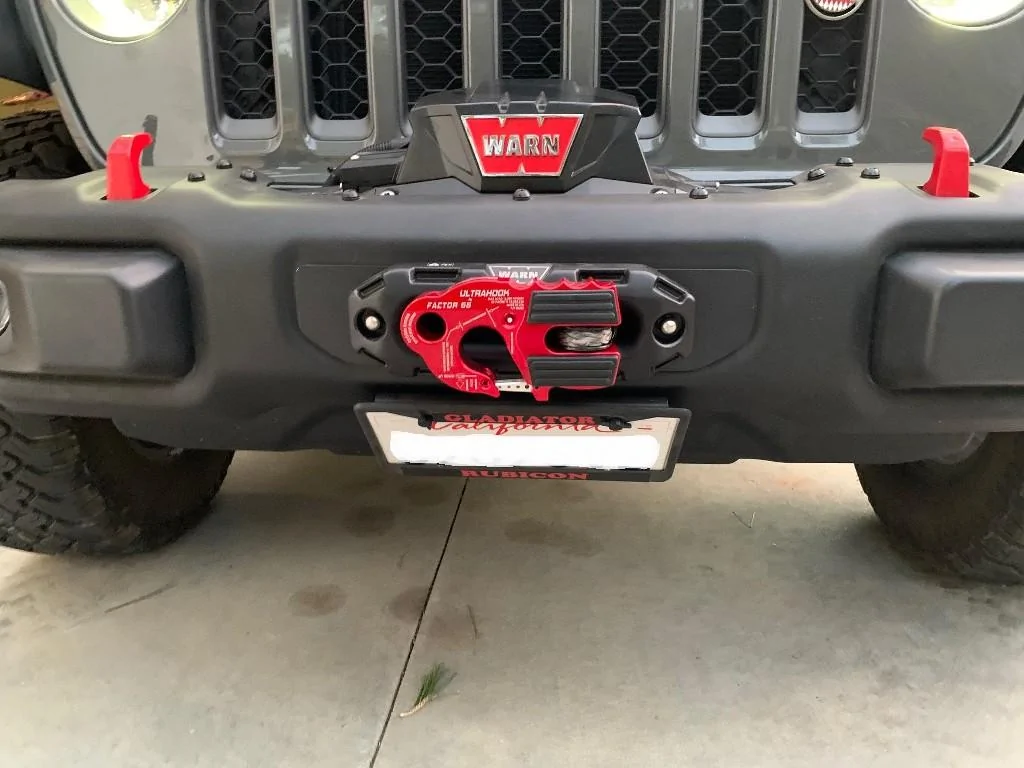

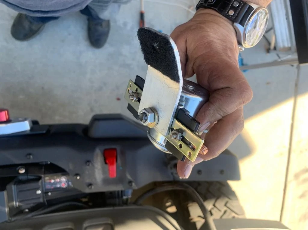

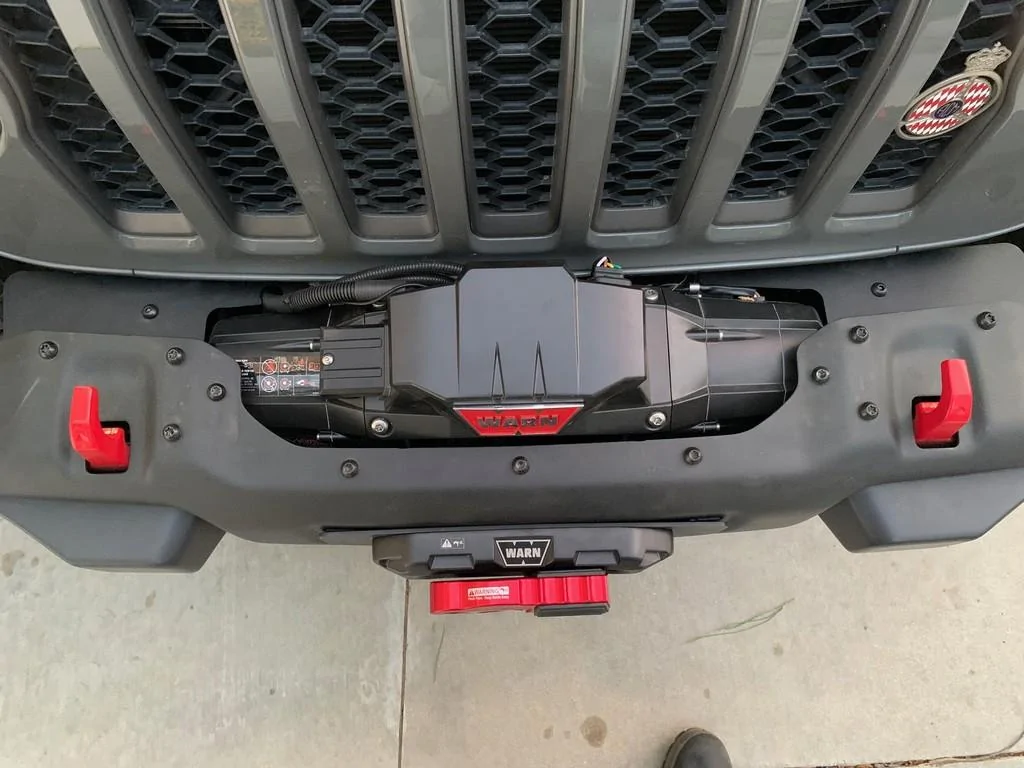

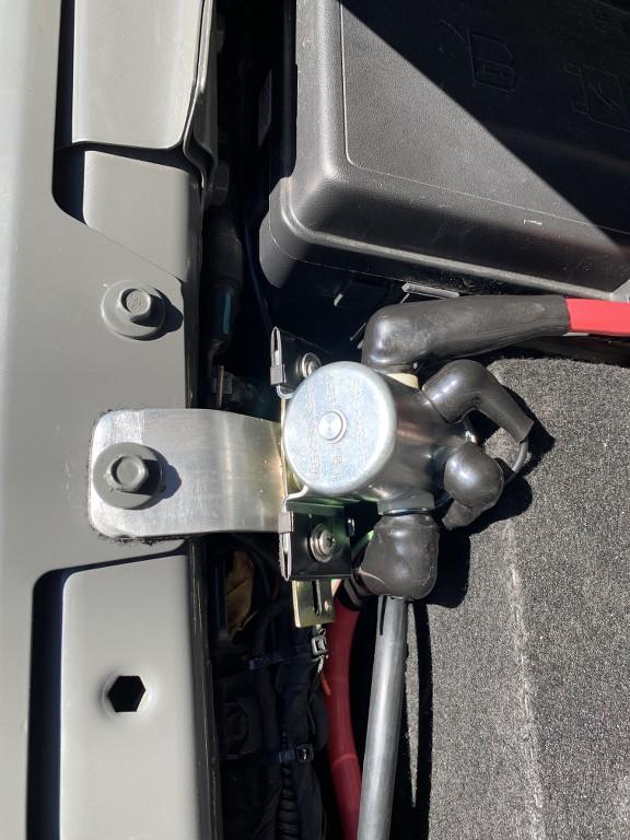

My girlfriend also drives the JTR to move boxes etc..., so, I also did not want power to the front bumper all the time. Along with the warn winch plate, I went with the Warn power cutoff kit (solenoid) and hooked that up to my Aux Switches. All I had to do was make the bracket. The rest was super easy. It works perfectly and I a glad I did it for peace of mind. The warn winch plate is super solid, great mounting plate. Here are some pics for you.
Additional info: I sourced the sting grey bolt for the bracket from my RSE step install which uses the fender pinch seam bolt hole, so, I had an extra one. I used Velcro fuzz on the bottom of the bracket so that it did not scratch the paint. Take the air box out to route the battery cables. I grounded the solenoid to the stock ground right next to the mount.
Note: I also used the Maximus 3 Warn Zeon filler plates (for the back of the winch) and the Maxiums 3 license plate holder. I swapped out the warn fairlead mount (with license plate holder) to the Mopar fairlead mount (which does not have a license plate holder).
