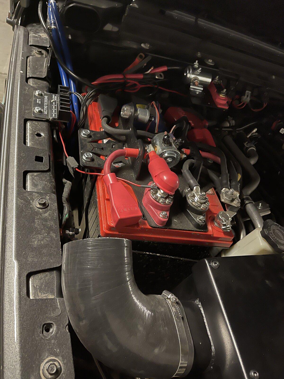

Every connection adds resistance and you’re talking big current. I melted the case around a battery terminal when I has my win lead under the pinch bolt. Adding another solenoid and connections will lead to more voltage drop at the motor. Consider mounting the whole control pack near the battery and connecting to the winch motor from there. That way the long cables are already switched power. Pulling your control power off ignition switched source is good thinking.

You could also buy the JL Audio fuse mounting bracket or make your own from bent aluminum :)
Jeep Gladiator To Solenoid or Not E819D815-D87C-459D-9047-B07F041A098B
Don’t mind the random wires and disconnected snorkel. Making some brackets myself right now.

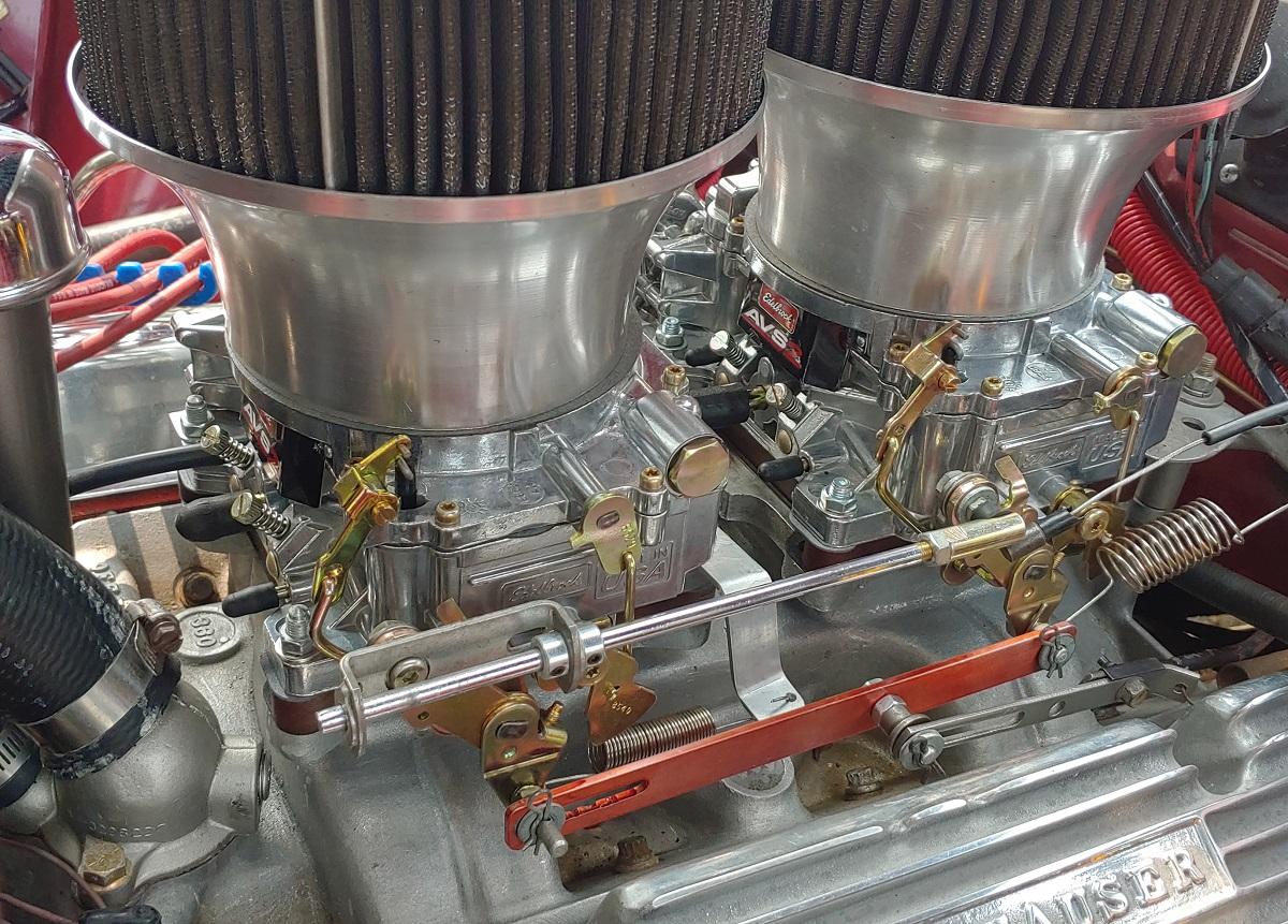

And people wonder why I keep scraps of aluminum strap, old brackets and braces, aluminum angle in various sizes and so on.
In this pic, almost every part of the throttle linkage and some of the transmission throttle linkage (some call it "kick-down" linkage) are from my parts bins. The round rod for the link between the two carbs - from an old bathroom sink drain setup. It's the rod you pushed or pulled to open or close the drain - chrome plated brass. Some of it's aluminum stock I had from other projects.

I pulled the steel pipe that comes with it because it could come in contact with the battery terminals and replaced it with a length of silicon tube as a short term fix. That works, but isn’t as clean as I’d like.
As mentioned I’m testing some bracket designs to put the metal pipe back without it interfering with the battery or any of the other electronics I have in there.
I’ll be posting pictures as I play with it.
